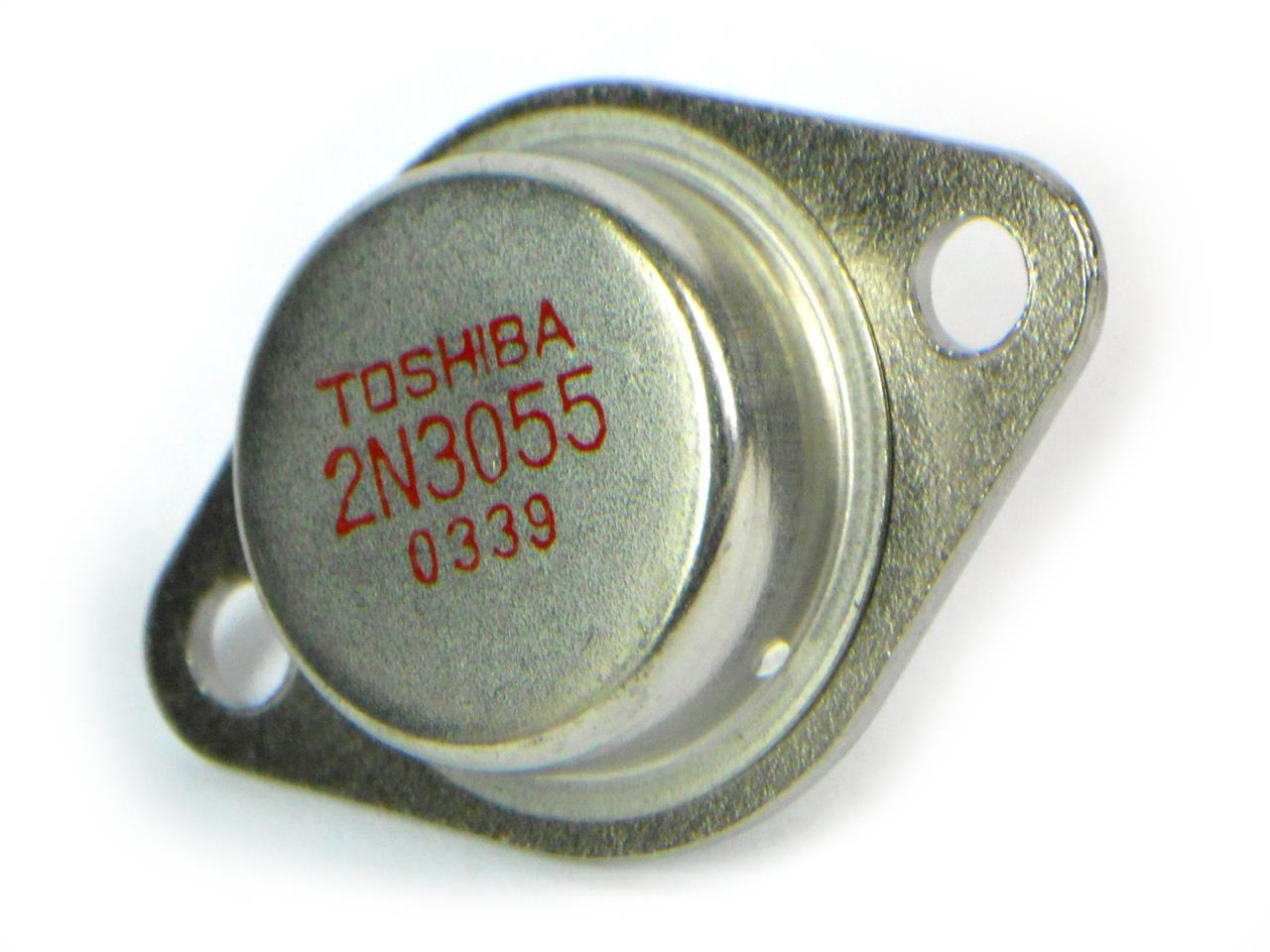

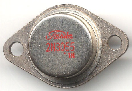

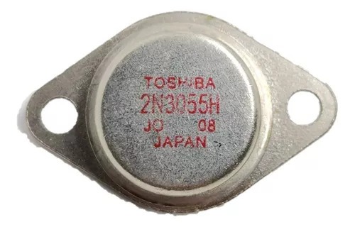

The only manufacturer I often see from Japan in various vintage amplifiers is Toshiba - go to the attachments.

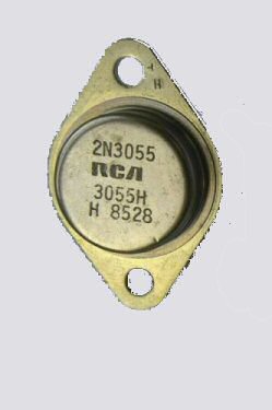

But RCA (the brand that was the first to release the 2N3055) was most likely counterfeit even back then - see the different appearance of the typefaces from the attached images.
The Sanken ”H” types may or may not have been Hometaxial. I don’t know if they had a single diffused process - but they had several that are pretty damn rugged. Toshiba did have a single-diffused process, used on types like the 2SD111. In either case they probably did meet the 2N3055H spec for ruggedness. Toshiba did also make 2N3055’s and 2N3773’s using their triple diffused multi emitter process, and had corresponding 2S numbers for them. Their old 2SD424 would pass the RCA 2N6259 2.5A/100V/1 second ruggedness test, even though the data sheet showed a second breakdown breakpoint of 70 volts. So you know they could make something as good as a 3055H or 3773.
2SD873 = 2N3773
2SD877 = 2N3054 (yes, it is/was a TO66)
2SD878 = 2N3055
All were still in my 89 data book. And so was the D424. The D427 and C2565/A1095 had already disappeared, and the C3821 was going strong at the height of production, of course.

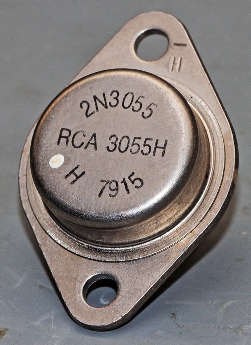

re: post #61 . the last three devices appear to have real RCA logos. The circle one being the first, the bold block RCA next and the straight RCA in between. Not sure what the white spot means though.
Is it a T which might refer to the old Transitron devices.
The dots are usually gain groupings. I’ve seen red, blue, and white across multiple brands.
