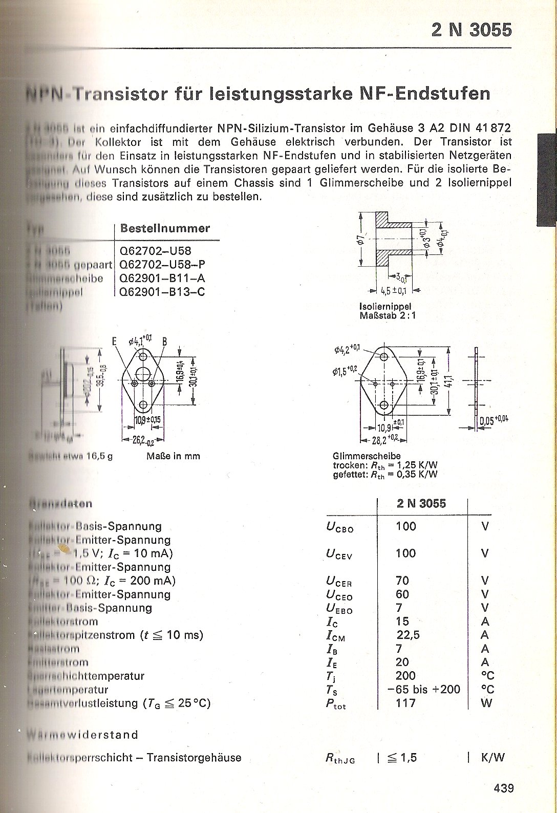

Here is an example of a datasheet from a Philips databook:
The databook dates from 1977, but the DS was filed in 1974:

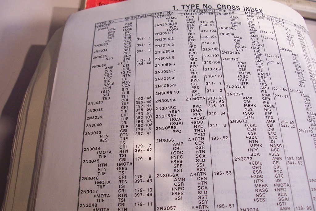

Here is a listing of manufacturers from a 1980 D.A.T.A. book:

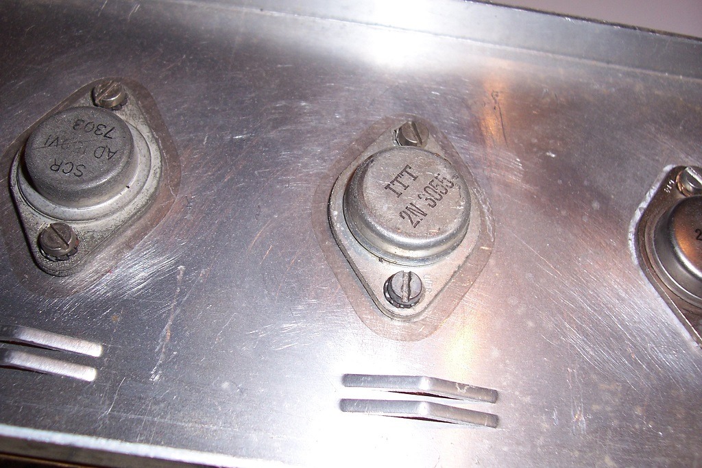

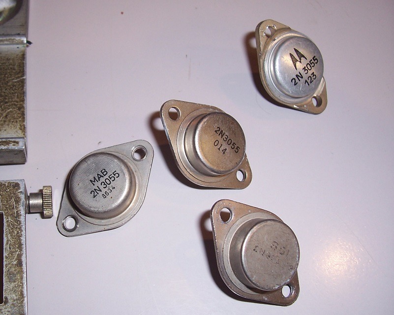

Here are some vintage examples of 2N3055, mostly from European origin (the one on the front with the faded marking is SSI).
Also included is the light alloy version from Moto (1971):
One more, from 1974:
And another one, exact date unknown but also seventies:
Reactions: JMFahey
In the above pic, the one with the Motorola M was aluminum. The others are steel and solderable if yiu were so inclined. The aluminum TO-3 was supposedly only good for 5000 thermal cycles and no you could not solder to the case. Motorola did make a domed top hat steel TO-3, but only for a couple of years in the late 80’s. It looks like the one on the far right in the bottom pic could be that type. Those weren’t easily solderable either because they were polished. Too smooth. The rough steel ones like early RCA lent themselves to soldering with an X-rated iron.

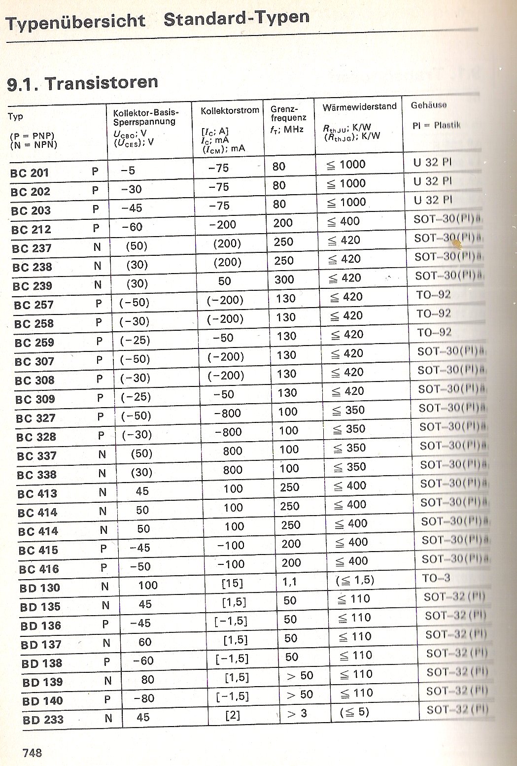

In their 1973/74 data book Siemens lists the same transistor (single-diffused) with identical specifications but three different markings:
BD130 - PRO-Electron designator for Standard / Consumer types
BDY39 - PRO-Electron designator for Industrial types
2N3055 - Jedec nomenclature (for International Customers ?)
whether they were any different in quality is not mentioned, prices were ...
