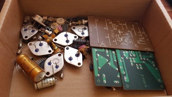

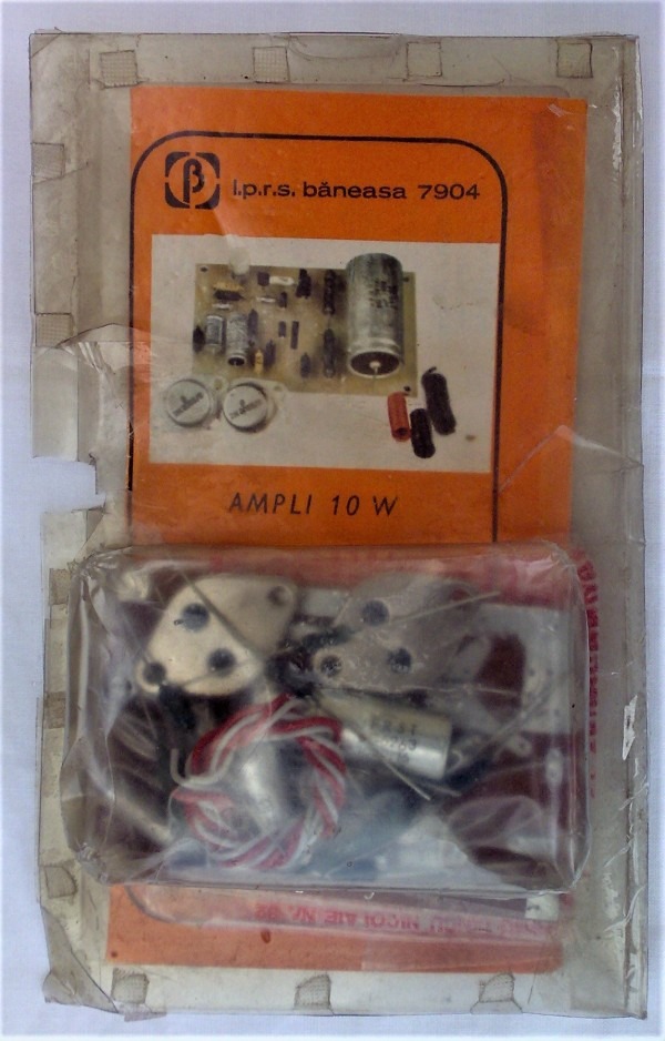

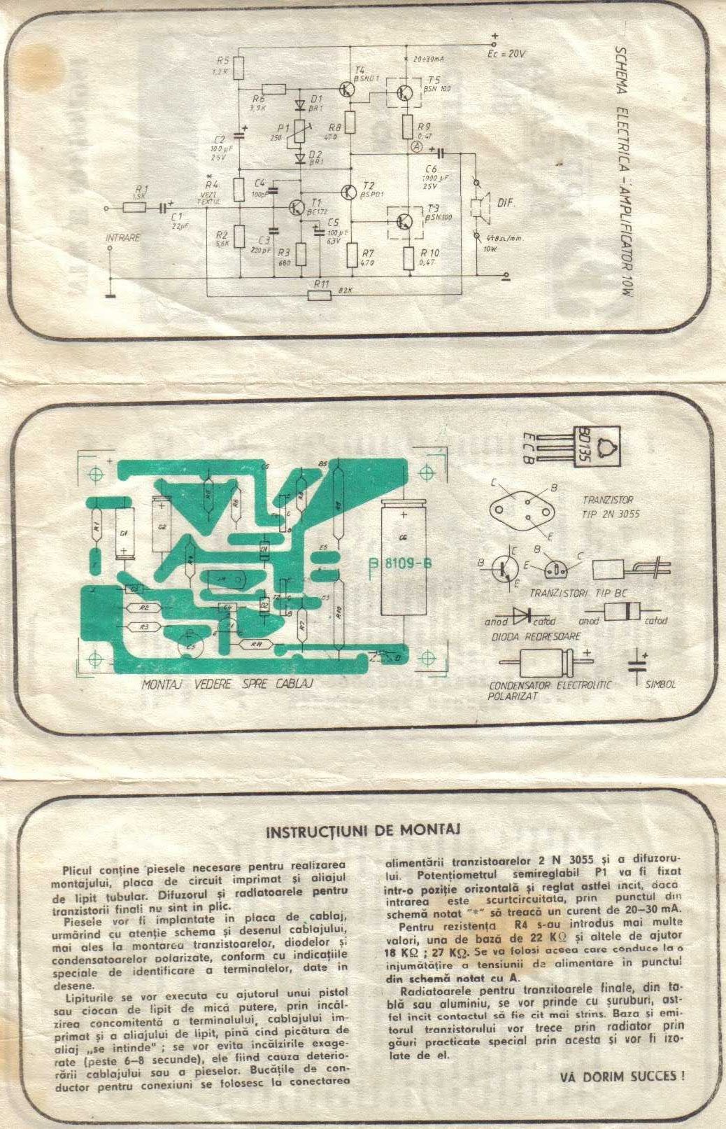

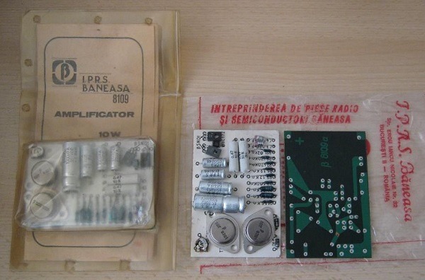

Just for fun, since you talked about 2n3055's , This was sold as a kit in Romania, in the 90's . I was to young back then (born in 96') , but, I built it too long time ago, for fun.

Hi Bruno,
Yes, we had kits here that used obsolete parts. They were good enough to teach, but kit makers look for the least expensive parts that will work (hopefully properly). You would also find magazine articles using obsolete parts for a project (and maybe sell kits). Same reasons as above.
One thing about old part numbers. The average experimenter is familiar with the number, and likely has some in their "junk box". We used to call the bin of pulled parts, a junk box. You could also get them at recyclers, surplus parts places and other less expensive sources. Nothing wrong with that. Back then we didn't have problems with fake parts (in the 1960s and 1970s for me).
