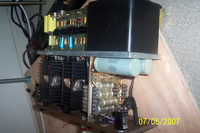

Similar to the Nelson Pass X series feedback, if you doubled the outputs you should be able to get 200W/4R out of the good old 2N3055.
Hadley 622
Hadley 622
Very interesting amp - thank you for this advice and especially the schematic.
to find more such amp models (and not such with MJ2955/2N3055 in use by output stage) was the reason for starting this thread

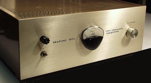

* AllegroSound * Hadley 601 Stereo Tube Amp *
ampzilla2000

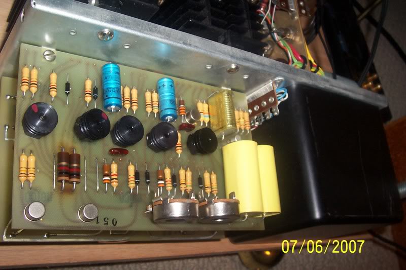

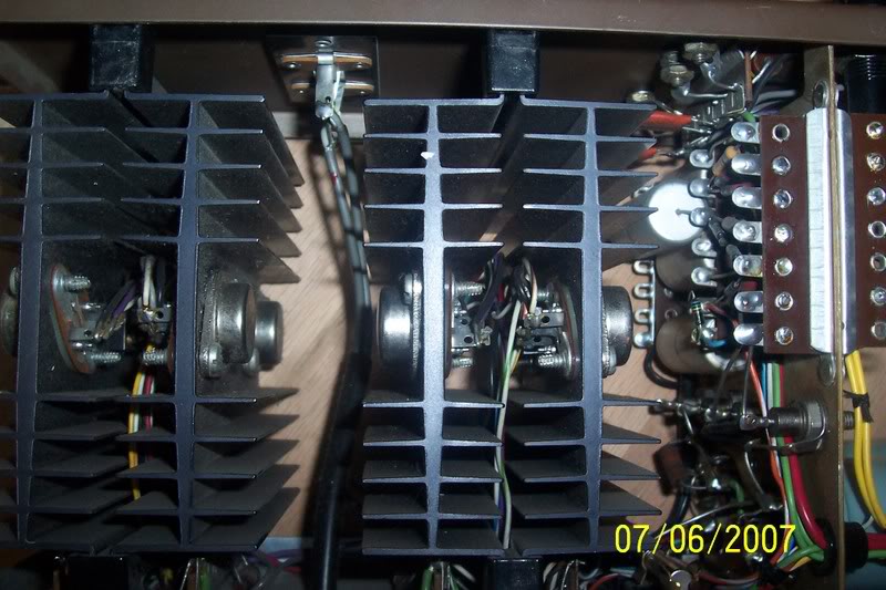

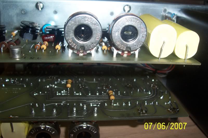

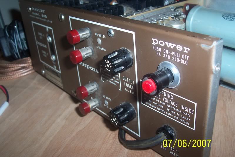

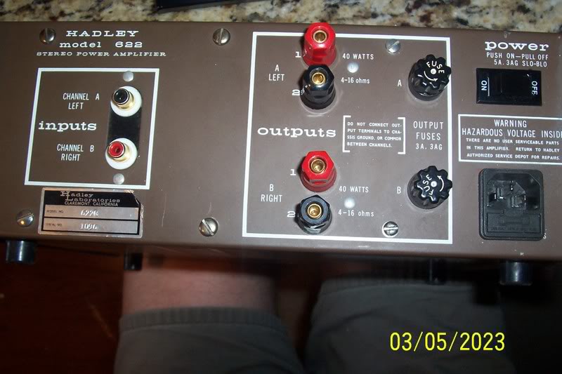

Unfortunately I don't find a photo with a front view of this amplifier (similar like tube based model "601"?).
Because this power silicon transistor was introduced by the Radio Corporation of America (RCA) already in the early 1960s, there must exist several of additional models from the early sixties. Such brand/models I like to know all

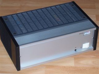

Maybe the Power Amplifier "XEC-1000" (XEC1000B) from Dayton Wright could also use 2N3055 quasi complementary output stage - who know this exactly?
on the web I found only a low resolution pic by the photo from it's owner's manual

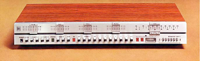

It comes in my mind that the B&O Beomaster 3002 receiver, of 70s, had power stages made by Motorola's 2x2N3055 per channel @ 2x40Wrms/4 ohms.
Thank you. here an auction from ebay:
Bang & Olufsen B&O Beomaster 3000-2 Top ! bei eBay.de: Receiver (endet 15.02.10 19:39:02 MEZ)
Verly large amount of photos
If don't goes open, try item No 220552777414 from the ebay start site

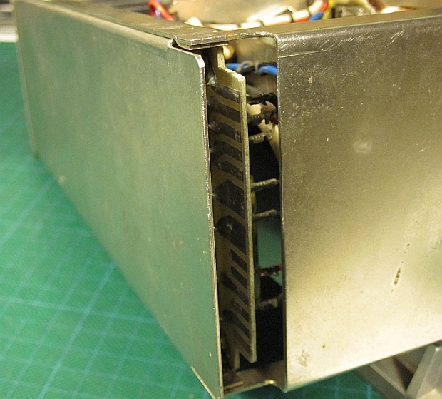

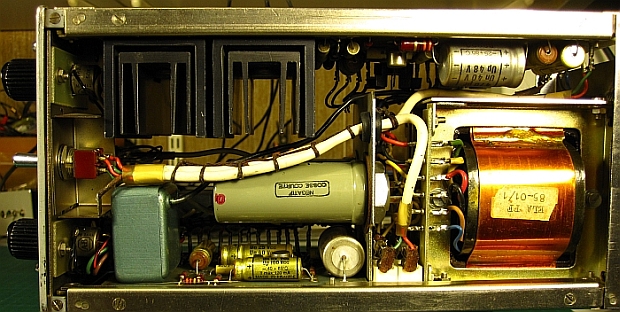

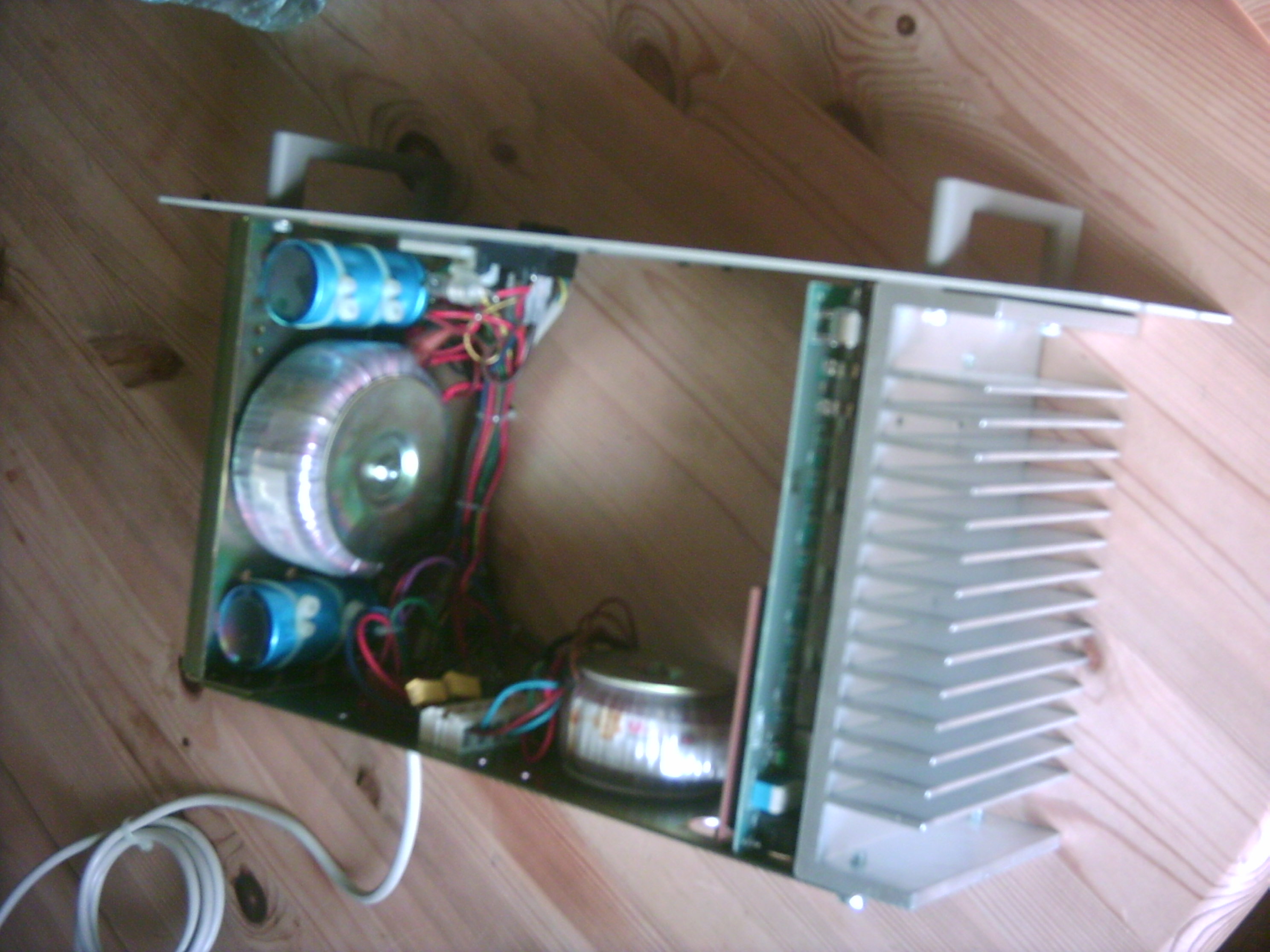

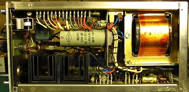

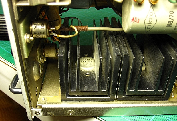

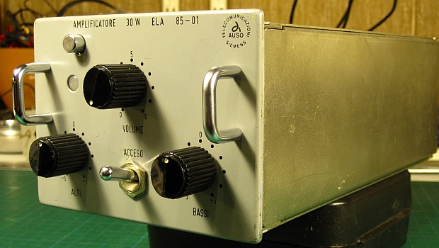

@ tiefbassuebertr: Yes very nice.
But what we have here: is a rather unknown and non famous power amp used for audio monitoring in the broadcasting studios of 70s. It's a mono-block heavy duty 30W (2x2N3055) power amp with balanced and floating transformer input of a modular plug-in design. See the pics.

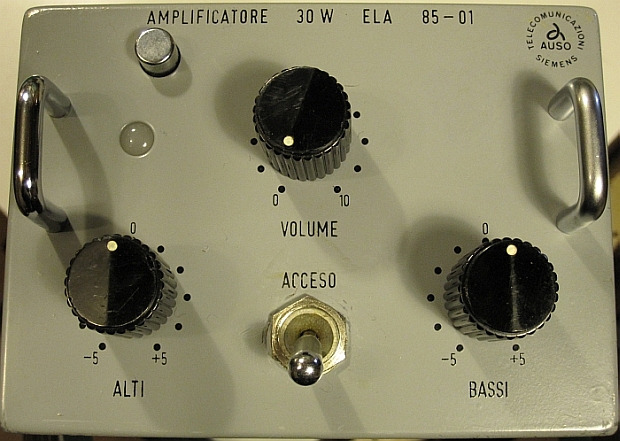

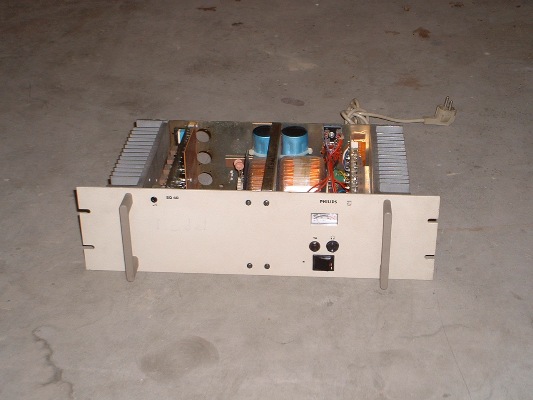

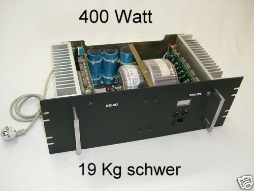

This was a good advice (and the amplifier keywords "broadcast" "monitoring" "ELA" and "Cinema" but not "audio" and "Hifi").
In the attachement a cinema amplifier series from Philips, that could have also 2N3055 inside, even for the neg. half (but I don't know exactly).
I quess, in the first time of 2N3055 release from RCA (1962 or so) and the end of 1960th this power transistor was only inside in professional amplifier devices, because it's too high costs for the comsumer marked (in opposite to germanium power devices).
In comsumer products from this aera I find often the germanium power transistor AD149, not only from Siemens and TFK, but sometimes also from RCA: AD149 PNP Germanium Transistor - Welcome to Valley Electronics E-Store
so as the complementary germanium pair AD161/162
In Germany even in the early 1970th (Braun, ITT SchaubLorenz and Blaupunkt car radios) this germanium versions still in use in the consumer audio components.
