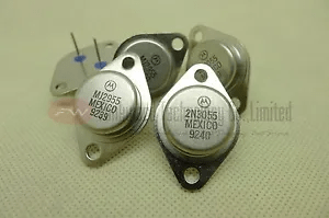

The original rating for the 2N3055 was 60 VDC C-E. I used to design with them in the 1970s, and I worked at a place that sold parts to industry. I studied parts and their characteristics and still do. The original data sheets I have were marked "Lamda". They might still be around here somewhere, but I am not going to attempt to search for them. I referred to them many times. I also have some original leather bound Motorola transistor data books. Yeah, those are old, and they are not reprints.
Price is never, ever a deciding factor in servicing equipment or building new. Why? A couple bucks saved and take out several times that in components or even the PCB itself. What's that worth? Then you still have to buy the same thing again, but hopefully you are now smart enough to buy either the real (known chain of custody) device. Even better, a device better suited to what you are doing. I should also mention that your time in troubleshooting what went wrong, and the labour involved in correcting your goof should be enough for anyone to avoid making that choice.
"SE" was a Motorola designation for a special device. It may be selected for higher breakdown voltage, beta or leakage, it may even be a modified device in some fashion. You will not find a data sheet on those, and the company would never release information on it. They were supplied under special contract to the OEM, so no technical information would ever be released to anyone but the customer and internal engineers. If others used that designation I wouldn't know, but in North America it was specifically a Motorola thing.
The 2N3442 was used in better commercial amplifiers (earlier production) until better parts came out (2N3773 for example).. The 2N5631 (and 2N6031 was the compliment). Another thing to consider is the cost of getting matched sets of output transistors. I can't tell you how many I had to buy to get a matched set of 4 MJ15022 /23 / 24 / 25 transistors. The spread of beta was pretty wide, Japanese parts were better and I used tons of 2SD424 and 2SD555 (and their compliments). When you had to match 8 of each number, things got real expensive. Did matching matter? It sure did and still does. The MJ/MJL series parts from OnSemi match out of the tube a lot better than I could get doing it by hand, and getting better matches does cost nearly as much. So what am I saying here? The new "expensive" parts are actually less expensive to use than the classic, cheaper parts! That and performance is much better, so how much more do you need to know?
Yes, the metal case parts are more expensive. The production quantities are falling, and materials much more expensive. They are heavier, so shipping thousands at a time is more expensive too. The cost of rejects is therefore higher and it all adds up to much higher costs in getting the good quality part in your hand. Of course they are much more expensive!

Actually the SOA is quite good - full power to about 80 volts. The fT spec'ed in the RCA manual is 80 kHz. No typo, not 800. Motorola always spec’ed a MHz, but they HAD a high SOA epi process. Don’t think it was quite as real-world rugged as RCAs homo. These could be anything, but I’d suspect closer to the lower end if they came out of a power supply - manufacturers would have used the best tool for the job. If you had used high fT (ie, switching types like 2N6547) as drivers, and a good set of predrivers (say 2N3440 and2N5415) in a QC3 you might have been able to make it listenable.
wg_ski, so you're saying that I'd better replace the lone driver pairs by much faster devices in order to approach some real builds? Would MJ15023's do?

I seem to remember that the max Vce for the 2N3055 varied by manufacturer, like 40V or 60V or more.
Can anybody confirm that?
Also, at some point there also was a PNP complement, the 2N2955 I believe, but I think that came in a plastic TO3.

That figure was always 60 VDC C-E and 100 VDC C-B. It's possible that European manufacturers allowed some variance, but the JEDEC spec was pretty much the standard in North America.

In the 2N3055 heydays, 2N2955 meant a TO-5 or even TO-18 small signal device (I'm not sure about the package). Just since recently TO3 transistors are sold under that moniker.Also, at some point there also was a PNP complement, the 2N2955 I believe, but I think that came in a plastic TO3.

No, over here the 2N2955 was either TO-3P or TO-3, that was it. Later they may have supplied it in the "T" package (TO-220)
I don't think that is correct. I have build with TO-3 (plastic) 2N2955's already in the 1970-ies.
There were definitely circuits with complementary 2N3055 - 2N2955 output pairs.

Yes, the TO-3P was the plastic case. A TO-220 was the smaller plastic case meant to replace TO-66 packages.
