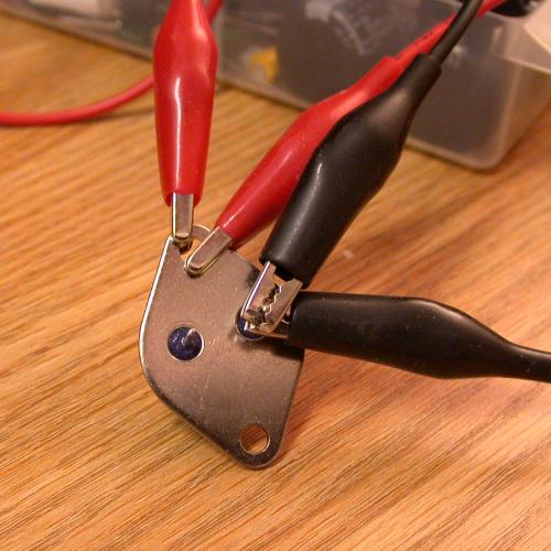

Get a socket (or use clip leads) and place a 100 or 200 ohm resistor in series with the collector. Connect a variable supply + to the resistor and - to the emitter with no connection to the base. Increase the voltage until athe collector to emitter voltage suddenly drops (avalanche). Kill the supply so as not to overheat the transisitor (THEY GET HOT!). Mark the transistor with a felt tip pen, repete for all parts present and sort by breakdown voltage.

(Increase the resistor value to 1K and you will limit the current to 100mA at a 100V supply. I tried 10K and it limited the current too much and the MJE3055 wouldn't avalache.)
As wg_ski suggested, a current source with high voltage supply would work better but either way you have to ramp the voltage and watch the voltage as you increase it to see where avalanche takes place. Once it happens Vce drops to a lower level as current shoots up.

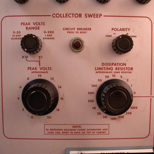

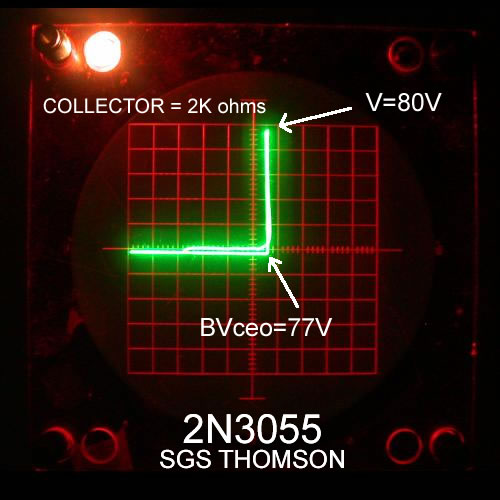

Time to fire up the old lady, my faithful Tek 575. Just happen to have 7 pairs of 2N3055 and MJ2955 by SGS Thomson.
Best to stick to the datasheet. +/-30V rails are about max.

Michael, If you derate your measurement by 25% for temp rise, you end up near 61V breakdown which is about what I would expect for the device.
The sample I measured is obviously an anomaly.

I've measured several ON Semi and ST epitaxial 2N3055's and routinely measure > 80V BVceo.
Originally RCA specified Vceo =60; Vcer (Rbe=100) =70V and BVcbo=100.
Manufacturers selling 2N3055's presumably had to meet the 100V BVcbo specification. I suspect (no proof) that because the epitaxial process had more abrupt junctions than the old hometaxial types from RCA, they had to basically manufacture a 100V transistor to meet the BVcbo spec. but then as a result got good BVcbo's well over 60V. Many epitaxial transistors often had the same BVcbo and BVceo specifications.
Generally, it seems that modern 2N3055's can be used to replace older devices at up to 80V but it is still worth checking your particular devices.

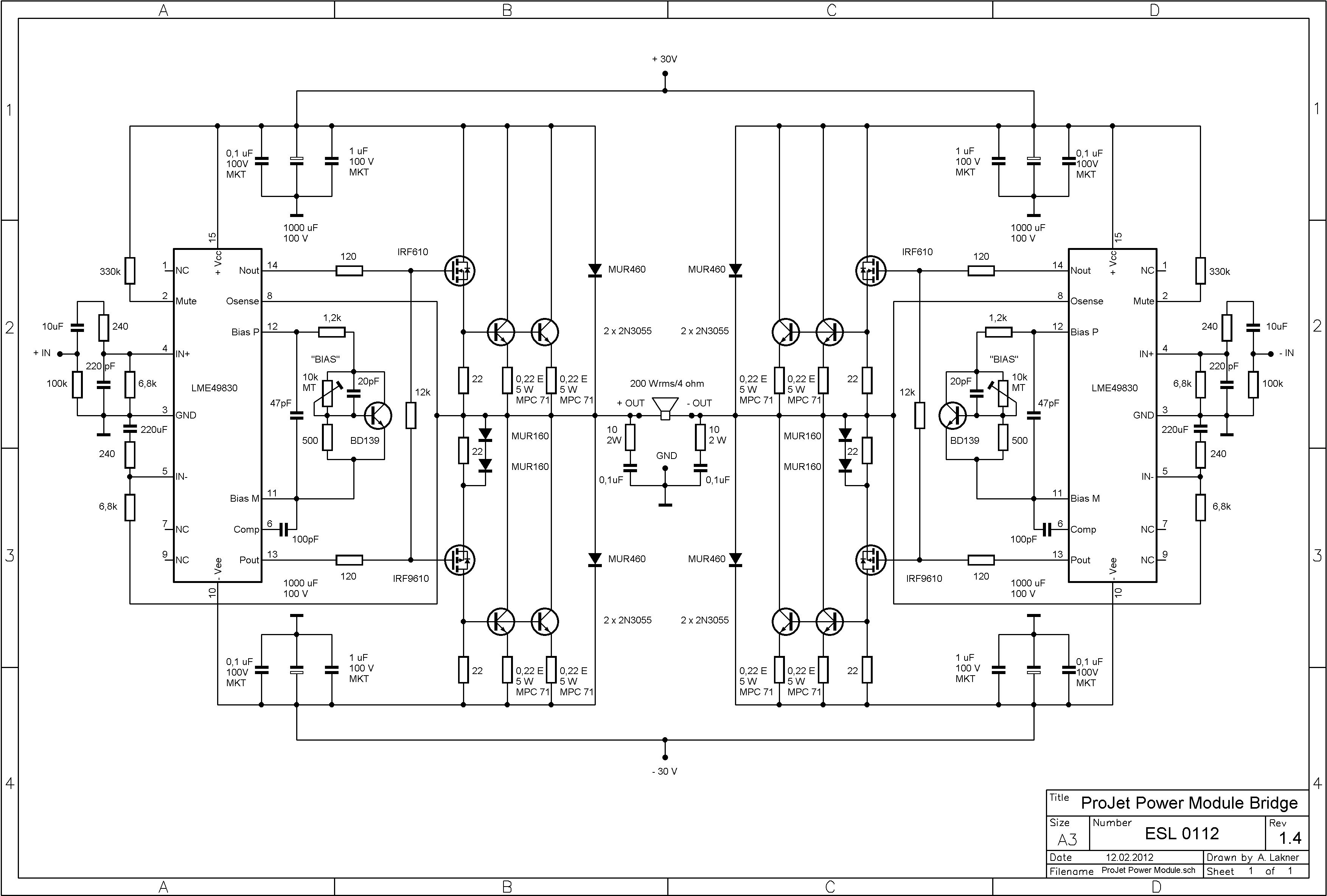

- 2n3055 amp claims 200 to 220 watt
