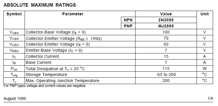

ALthough they are rated at 100V Vcbo they only need a small current to change from "Vcbo" to "Vceo" - and bang.

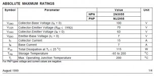

we are concerned with Vceo, a Vceo of around 70volts does not stand a chance with rails totaling 110volts, it doesn't take genius to figure this one out...

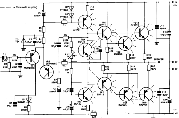

Well then, please explain why this Maplin amp works. According to you, this amp will blow up at maximum voltage swing. By the way, Vceo is not "around 70V". It is 60V (Absolute Maximum Ratings).
we do not know how many amps of those where made and how many blew.....anyway, it is not a good design practice to violate transistor ratings.....they may work, but the question is for how long?
i can not recommend such practice to anyone...

But worst case are those ones that takes like 65 Volt before they breakdown.
While other 2N3055 can take more than 100 Volt.
The sound idea is to design for the worst case.
And to take no chances.
Several diagrams here claiming more than 60 Volt and even 110 Volt VCE
are not trustful designs. As a worst case will breakdown 2N3055 transistors.

i built a leach superamp using these 2N3055/MJ2955 output trannies, i scaled down the rails to +/-55volts unloaded....
that was in 1990, afaik, the amp still lives today.....
i still hold that transistor specs should be respected.....

as long as you scale down the power supply rails to +/-35volts, you can use "quasie's" design using those 2n3055's
you can use the bd139,bd140 drivers instead.
Semiconductor devices like most things follow distribution curves. A manufacturer has two choices. (1) sell all the parts at the lowest common denominator to optimize sales (early transistor choice like the 2N3055), or (2) grade the parts and charge a premium for the higher voltage units (more modern approach as in the VP0106).
Even with approach 2, there is a high probability that the demand for the high grade parts will fall below the availibility from the distribuition curve, so parts are only screened for the high grade parameter untill sales requirements are meet. Then the next lower screening occurs, and so forth. The latter parts end up having a significant percentage of high grade (voltage in this case) parts marked and sold at the lower cost.
In the case of the 2N3055, I suspect the process was targetted at 100V to get 60V parts. It makes screening easier, and you get a much better yield.
If Y'all want to use 3055s at higher supply voltages, just screen them first. It's easy.
Get a socket (or use clip leads) and place a 100 or 200 ohm resistor in series with the collector. Connect a variable supply + to the resistor and - to the emitter with no connection to the base. Increase the voltage until athe collector to emitter voltage suddenly drops (avalanche). Kill the supply so as not to overheat the transisitor (THEY GET HOT!). Mark the transistor with a felt tip pen, repete for all parts present and sort by breakdown voltage.
Don't forget to give yourself a little margin to account for mains voltage variations.

Vceo Voltage collector to emitter base open or at no current!
