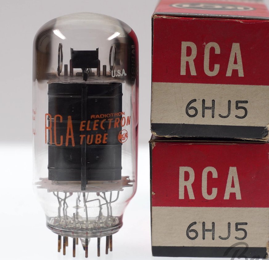

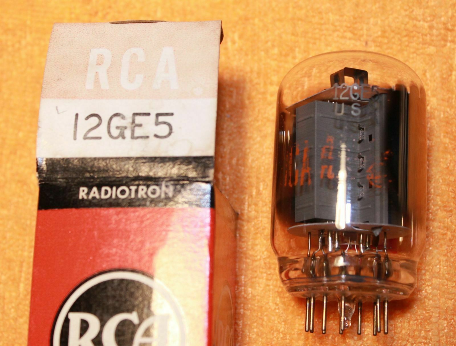

The Radar pulse modulator type tubes likely will get one down to a practical output impedance for the OT if used at low B+. They generally have high heater power and so high emission capability. At least on par with TV Sweep tubes for continuous duty, if not even more.
The issue with some or most of the pulse modulator tubes is that they get their super high gm for handling the high pulsed currents by using a grid that is a square mesh, rather than the parallel grid wires used in most "linear" type tubes. And it is likely to be very closely spaced to the cathode too. They generally use positive grid drive too. This will give them more like a 5/2 power law characteristic. And bad discontinuous grid current loading on the previous driver stage. Lots of N Fdbk will be required to straighten them out for audio. They are likely to have a pentode like output impedance too, so not suitable for a SET design.
Beam triodes like 6JH5, 6JD5, 6HZ5 .... still require high voltage B+ to get any current out of them, so are mostly useless for audio except possibly for Electrostatic direct drive speakers. Driving the grid positive could help lower the required B+, but they are not rated for that, and would become non-linear drive loads besides.

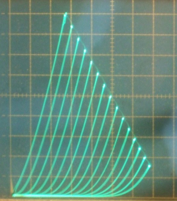

Some of the best tubes cost just $1 to $3, with no exposed HV, and work with low Z primary OTs for good performance in audio. And can even be turned into
-real- "exotic" linear tubes using Crazy drive.

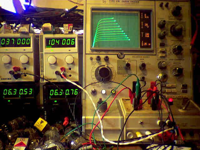

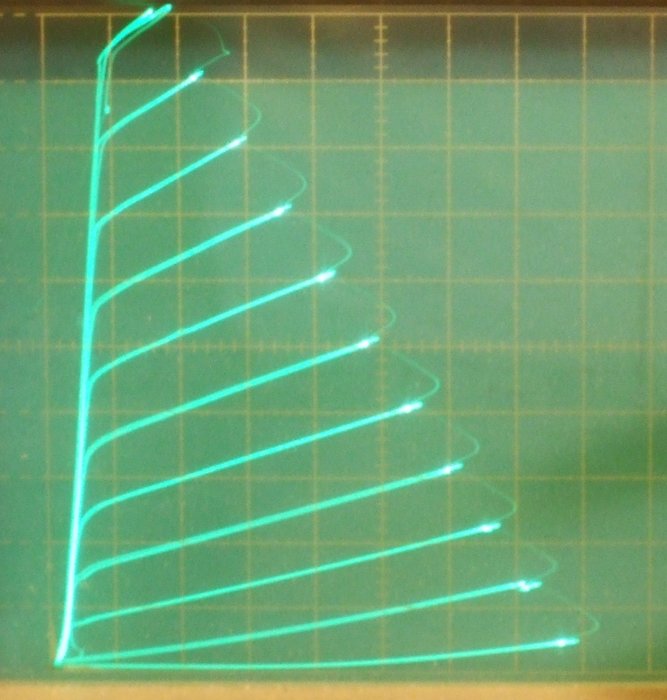

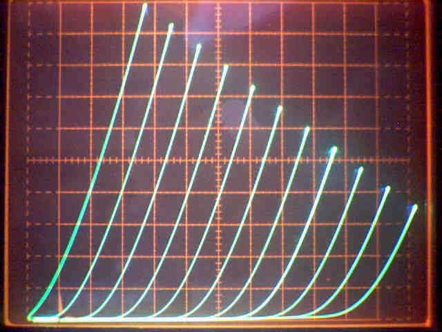

That a Tek 576 curve tracer?
Part of the problem is that this obnoxious single-end-triode buzz means that people see a big triode and thing "Great audio amp!", when in fact many of them are about the worst possible choice for audio. There are exceptions, like the 845 (which is a crap RF tube anyways), but the 2C39, for example, is considered "not worth it" for anything below VHF. Nobody builds an HF amplifier using 2C39s. Also, I could be wrong, but I want to say that a 2C39 audio amp would be nearly impossible to stabilize.
Honestly, tubes like the 6L6GC and the KT88 are popular for a reason- they're great tubes for audio work.
Yup, modified for tube curve tracing. 170V step range, screen grid V auto selection, variable (continuous) step size, up to 15 curves, screen current curves, screen drive curves, Crazy drive curves, screen current limiting or minimum plate V option (for knees)... 700 V plate scale besides the 350 V plate scale (I got rid of the 1500 V plate scale, too dangerous).
