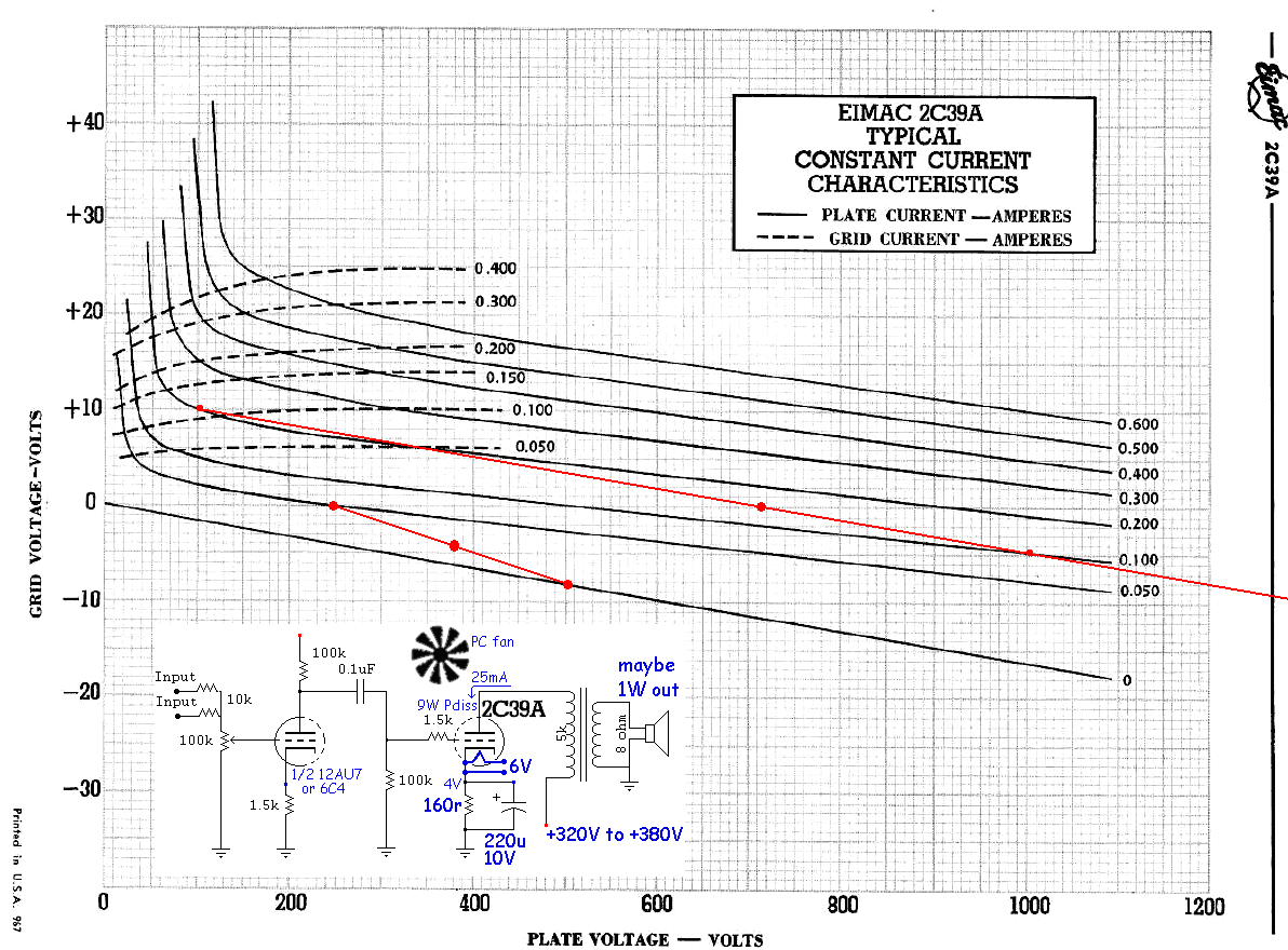

I just won a 2C39A in an auction for cheap for RF applications and I was wondering if I could use this as the output tube in a class A amp.
It's pretty powerful with about 100W of max plate dissipation.
Do you guys think I can make an OK sounding class A amp with this and my other tubes?
I have these tubes: 2 x PCL805, 3 x 12AQ5 and 1 x 2C39A (glass version)

To get any real current and power from that tube you must drive the grid POSITIVE. Then it sucks big current. This is OK in single-frequency tuned circuits. In *audio*, a device that changes impedance from >1Meg to around 100 Ohms means gross distortion.
OK, I found an "audio" condition in the negative grid range. It is only 1 Watt out. It is also about 10W dissipation so a PC fan may be enough blow. The plate structure can be hot enough to boil water but not hot enough to sear a steak (or hand) quickly. Note that the whole plate structure is at +300+V so must not be exposed to touch.

Something is wrong. Either you are expecting too much of the little thing, or you have mis-biased or mis-loaded it.

I tried the 2C39A with 320V and with a grid leakage resistor of 1MOhm and 100kOhm. It still has a lot of distortion with not much power. Also, it had a cathode resistor of 500Ohm.
I checked and my PCL805's triode isn't the cause of the distortion and it's the 2C39A.
I tried the circuit with two different transformers. One with a 15kOhm to 5Ohm and one with 50Ohm to less than 0.5Ohm. The second one did a bit better.
I know that the transformers are far from perfect audio transformers, but still.
Is there anything that I'm doing horribly wrong?
I expected a lot more power while running off 320V.
Any help is appreciated. 🙂

I may be late to the party, but my opinion is similar: do not attempt to use thes UHF 'grounded-grid' triodes for AF work. For the same reasons. Positive-going bias on the grid, causing very low input impedance (indeed, asymmetric, which is even worse that 'just a load'), near-impossibility of mounting the things securely, while still using forced air head ducting on the anodes.
They're certainly beautiful to look at, to hold. But really not suited for audio-frequency work.

Update: I have noticed that at low input voltages (less than like 0.3V RMS), it sounds pretty good with my 50Ohm:0.5Ohm transformer. Like, PRETTY GOOD. But if you increase the volume, it gets heavily distorted and when you go too high, it start cutting off and distorting at the same time.

Quite seriously, every so often people get their hands on an esoteric RF tube and then try (and fail) to build an audio amplifier out of it. Usually they try to build one single-ended, which doesn't help the matter.
Tubes like the 2C39, 4CX250, 15E and some of the lighthouse tubes are better left to their original use. Tubes like the 15E, which were originally designed for extremely high voltages in pulsed RF usage (WWII radar systems), are just a poor choice for audio.
Tubes like the 2C39 and 4CX250 are also a terrible audio tube. Sure you may get it to "work", but the results are going to be sub-par and the effort will be enormous. It will require very high voltages, a custom-designed output transformer (in all likelihood, though I haven't looked at the 2C39 curves in a while), and a ridiculously complicated chassis design to handle the forced-air cooling.
Oh, and one other thing: This is a UHF tube. That means that it will have no trouble oscillating at some ridiculous frequencies. You thought the 807 was bad for parasitics, wait until you see this. The 807 won't go anywhere close to this high.
Just because it's a "big triode" doesn't mean it has any realistic usage in audio whatsoever. Like I said, if you want to build something with this, use it where it shines, and that is in RF service.
Edit: To be clear, there's nothing wrong with RF service. That's another very fun hobby that the folks over on QRZ will be happy to help you with.

It seems that my previous circuit was the best, with maybe 0.5W of power which is stupid.
I won't be attempting to make an amplifier out of this and I declare defeat.
