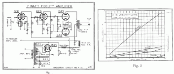

AWV Technical Bulletin 77 (1937) shows 2A3s in PP Class A, 250Va at -45Vgk into 5Ka-a producing around 1.8% H2 and 1.5% H3 at maximum power (7W)
Thanks Jason (good to have up to date info 😉 – nice that it's split H2 and H3.

audiousername said:AWV Technical Bulletin 77 (1937) shows 2A3s in PP Class A, 250Va at -45Vgk into 5Ka-a producing around 1.8% H2 and 1.5% H3 at maximum power (7W)
Using a pair of Sovtek 2A3 with identical conditions (alright, 7.4W, rather than 7W) to the above I have just measured:
H2: -42dB, H3: -64dB, H4: -82dB, H5: -61dB, H6: -78dB, H7: -76dB, H8: -93dB
Is that sufficiently up-to-date?
Odd.
If I haven't messed up the maths, -42dB is only 0.8% H2. Hmm... maybe 68 year old measurements aren't that reliable after all.

audiousername said:Odd.
First the Sovtek 2A3 is called a 2A3 but it isn't one, secondly, the 68 Year old measurements include the whole amplifier.
Sayonara
EC8010 said:Your maths is fine. The Sovtek 2A3 does seem to be quite good.
The problem is that I'd need 8 of them to equal 4 7027...
The distribution of harmonics is interesting. Why do you think second is so (relatively) high?
