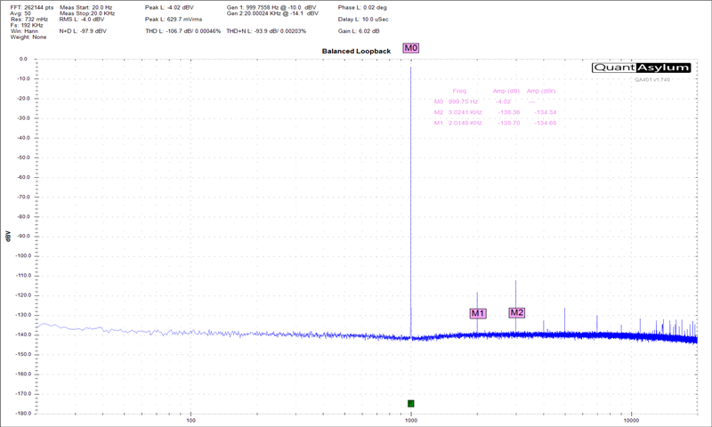

Okay so here is my set-up
I'm using an LT1364 opamp in inverting mode with 1k and 10k feedback resistors and a 10 ohm noise gain resistor. The load is 100 ohm and the output voltage swing is 4.32v P-P.
Unfortunately when I went from 10 ohms to 5 ohms the distortion got better for some reason so I went with 10 ohms. This only gives me about 30 db extra headroom. I prefer the method of dragging amplifier down by running it out of spec because I can make it distort much worse but this is what you guys wanted so here it is.
This is the distortion without the 10 ohm noise gain resistor.
This is the distortion with the 10 ohm noise gain resistor.
This is the distortion when applying the most basic form of my EC
Unfortunately I couldn't make my EC worse unless I specifically tried to. This is the bottom of the barrel and it's already near the noise floor. I prefer my method of loading down the amp.
Also a huge portion of my EC is straight up incompatible with this noise gain resistor method. The resistor completely ruins the performance of the EC. Fortunately different sections of my EC are able to be separated from each other but I can only go so far with that resistor in place. However I can at least double the performance gain of the above measurement even with the resistor in place, maybe triple if I'm really lucky and get creative, but the noise floor problem still remains.I'm all ears, I'm letting you guys lead me on this one.
I think this is the most clear set of graphs yet in this thread. The amp on itself has a distortion of -80dB and the noise gain trick isn't really necessary to measure it. It appears that your EC lowers the distortion by 40dB, getting to -120dB. That is quite worthwhile, depending on the complexity of the EC.
One next step could be to make your amp better by another 20dB, and tweak your EC another 10dB, which would bring the combo to -150dB. If this can be sustained over frequency you got yourself a hell of an amp.
