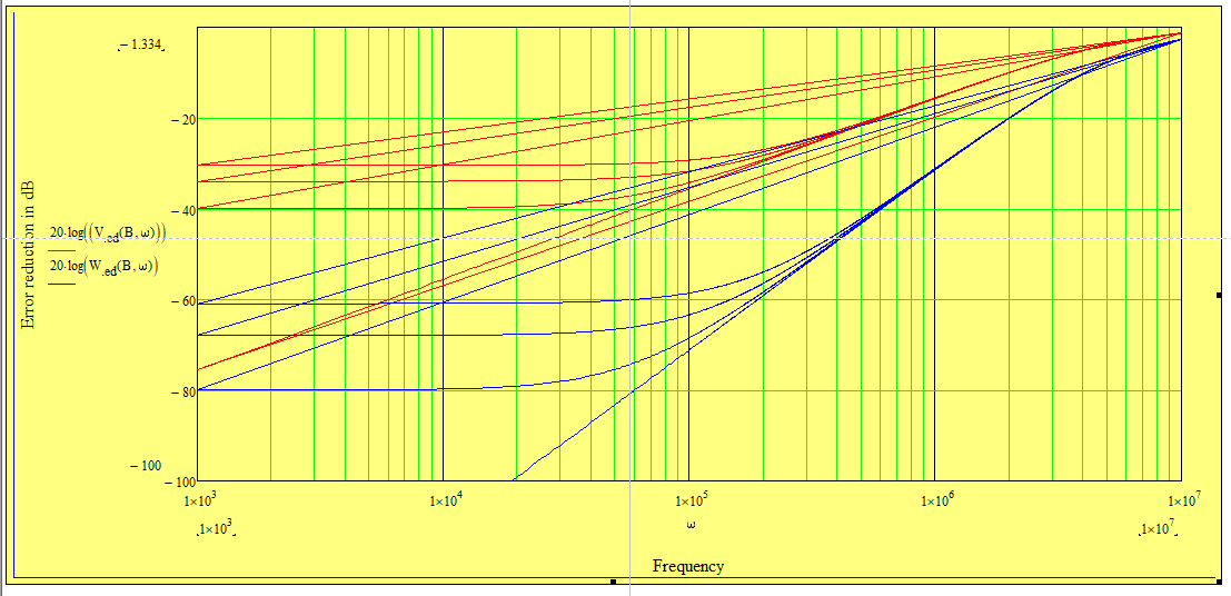

I have recollections now from my own EC work, many years ago. Can't find the MathCad docs right now, but remember some issues I found.
What I found of interest is that if you want to use EC to decrease the distortion by say 40dB, there are a few requirements for the EC circuitry itself.
For instance, the EC works with a form of cancellation between two signals. And to effect the 40dB reduction (cancellation) obviously the EC circuit must be at least 1% accurately set as to its gain or whatever. This appears no issue with precision opamp circuits.
But the thing is that this 1% accuracy must be maintained to 100 times the closed loop roll-off frequency of the main amplifier. If not, the EC will start to fail towards the higher frequencies.
Basically that means a 1% accuracy maintained to 100x the closed loop roll-off. That, my friend, is not trivial!
Do the numbers ...
Jan

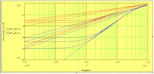

See for example the attached.
Look at the blue lines, and disregard the straight ones (these are 'fly-back lines' because I haven't set up MathCad to suppress them, just installed it).
There is one blue line that goes straight down to the left and crosses -100dB at around 20kHz. That is the EC supression when the EC gain is exactly 1.00000000 and the EC -3dB BW is 20MHz. The EC continues down to infinity at DC.
If the EC is 'just' 1.0001 or 0.9999 it will be limited to a maximum of 80dB reduction (1/10000). With 1.001, the limit is 60dB; with 0.99 it's 40dB. These accuracy limits are shown by the levelling off of the reduction.
(The red lines are similar for 1% accuracy).
So, with an accuracy of the EC of 0.1% and a -3dB bandwidth of the EC circuitry of 1000 x 20kHz = 20MHz, you can suppress distortion in the full audio band by 60dB. I would posit that this is NOT trivial. And 150dB supression is completely pie-in-the-sky.
