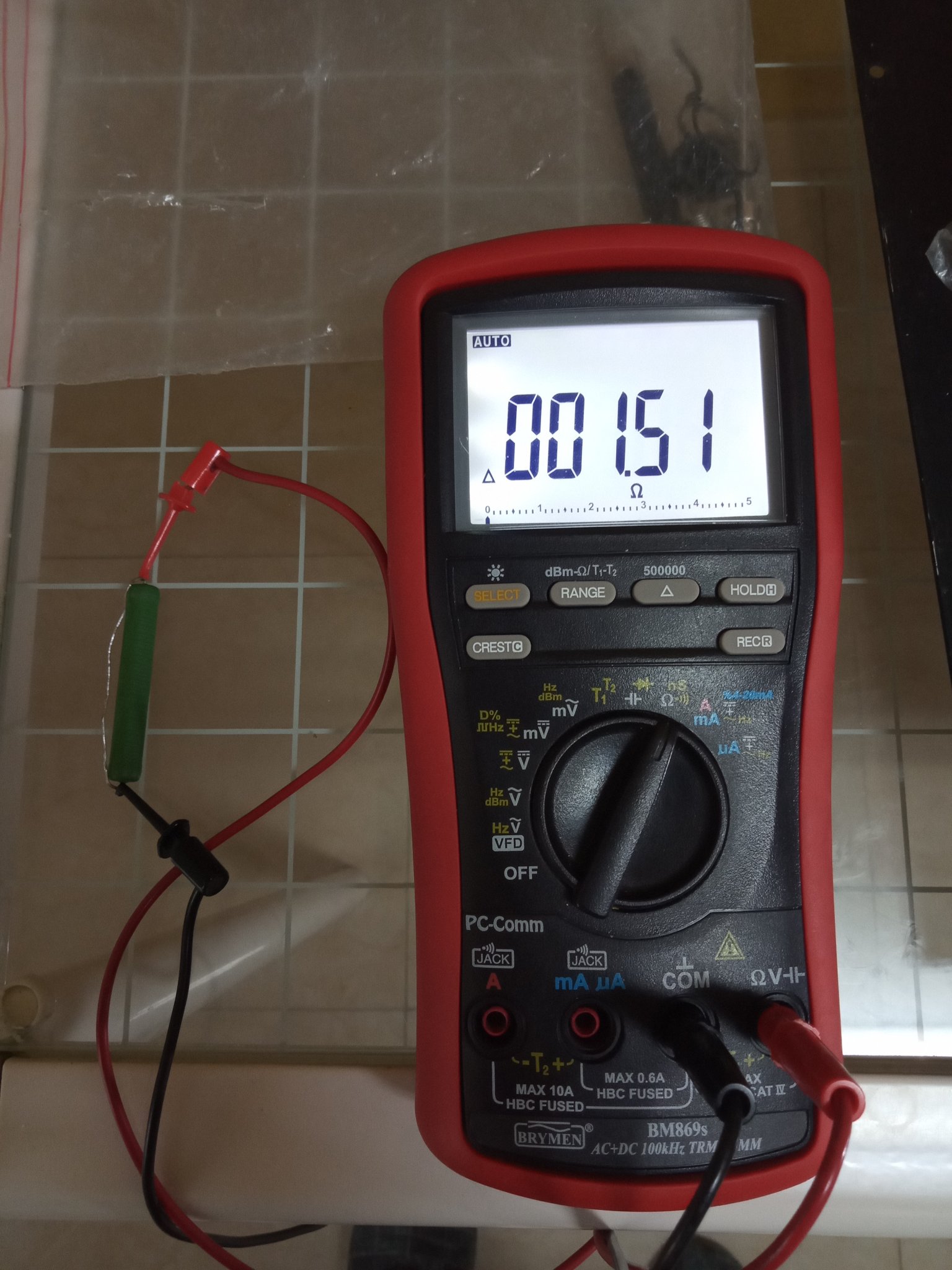

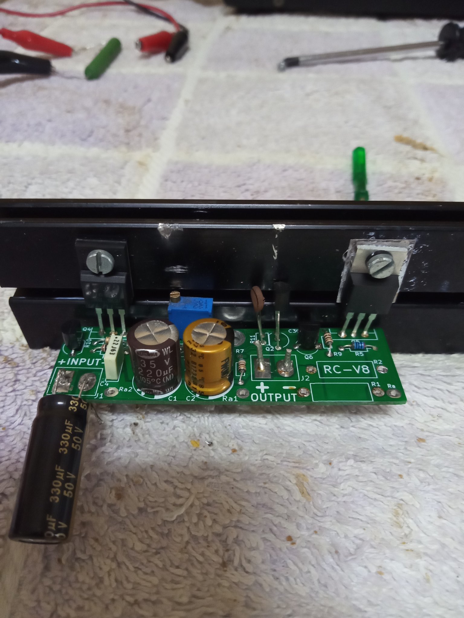

@Rod visual inspection shows burned R11
I own 10-12W resistor not used for diy 3 way loudspeaker.

Yes - I should probably do that first for safety's sake. But I measure with the actual tube because all tubes are different and my bench supply shows the current going through the tube for the correct voltage, e.g. 1.5V for a 26. The current may be under or over 1A depending on the tube, so I'm also testing the tube out for matching purposes. I do always mark the tube with its socket placement. The resistor is an idealised measurement.
With this information, the regulator looks to be working fine.
The problem seems to be the high value of R1.
The R1 supplied with the kit (1.0Ω 5W) is a wirewound, and I can't think of any way it could increase to 2.5Ω, unless it has mechanical damage. It is a mystery.
Please change it for a new one. It is easy to buy LONG 5W or 7W wirewound resistors (body length up to 48mm). The long R1 resistors mount on the pad near the input connector, and the R1 right-side pad. You can see it in the PCB foil.

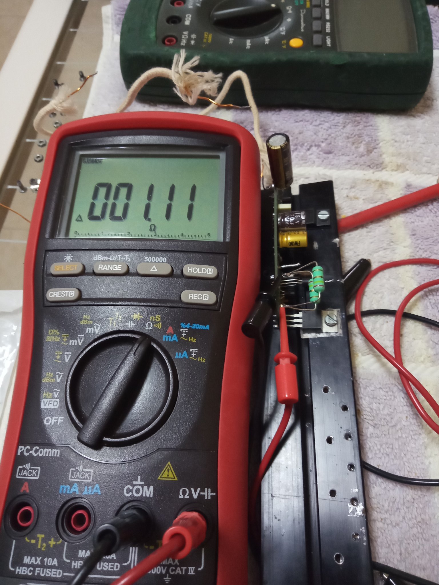

I desoldered and measured 500R so is going on OK but reg. still don't reach the 1.5V across the 1R5 dummy load.
Used the two paralleled 2R resistor at R1 to have 1R.
