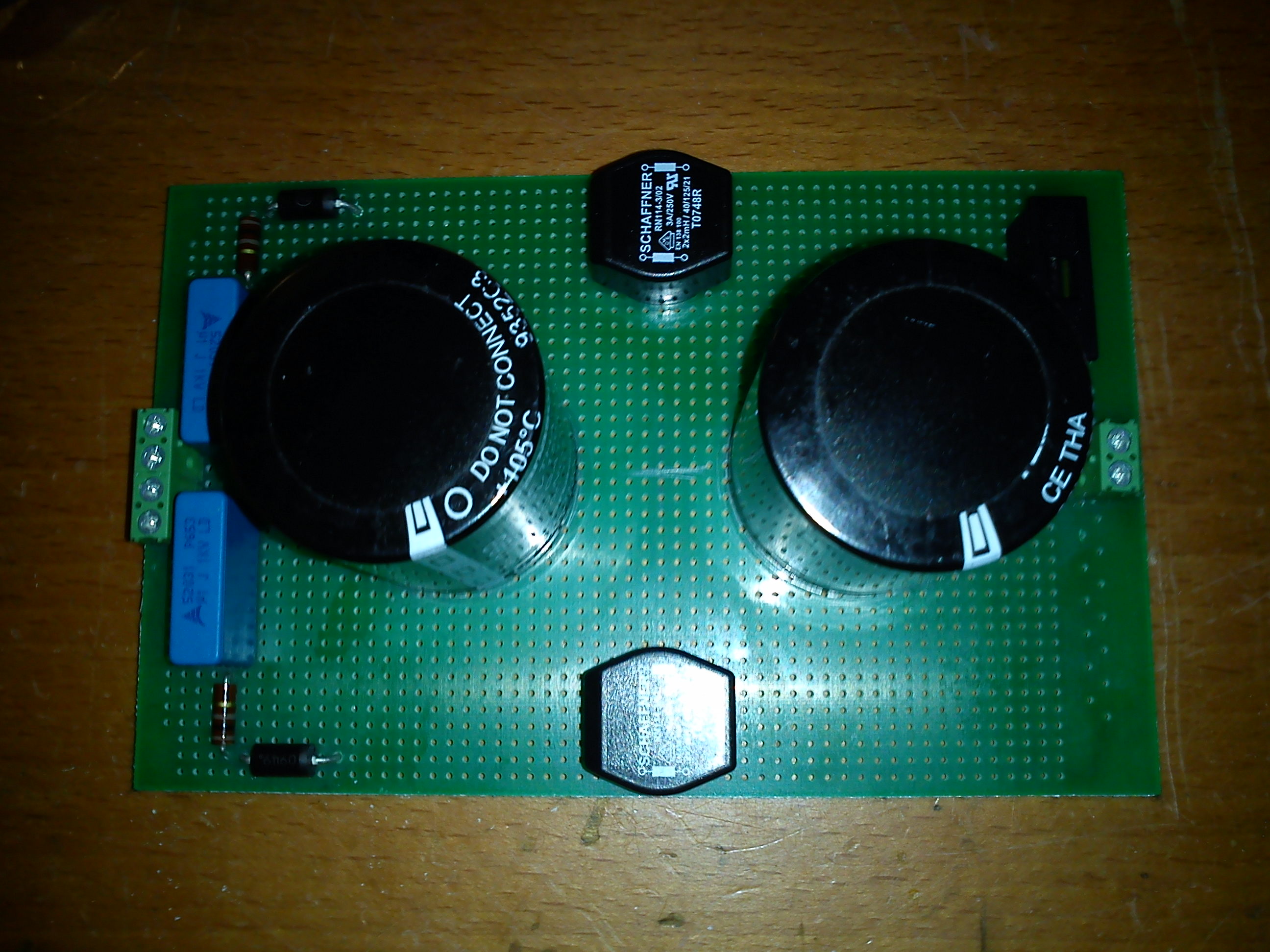

Finsihing the first PSU for Rod Coleman heaters

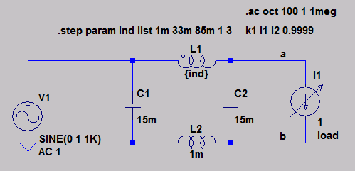

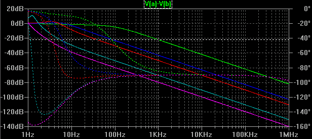

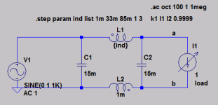

Old crt monitors that people throw out have some nice common mode chokes at the very input of their power supplies. You can also find some in computer SMPSs. Those I've measured to be anywhere from 18mh to 33mH. Have a look what the effect of a few values is: 1mH 33mH 85mH 1H 3H, and this in the ideal world of the simulator. My point is, very little noise attenuation is to be expected from such small value chokes.

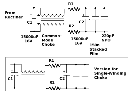

The old monitors use the CMCs to keep high frequency noise from getting OUT of the monitor (for emissions test limits).
In DHT filament supplies, the goal is to keep the mains-carried HF from getting IN.
And it is important to keep HF/VHF/UHF from getting in, since it's hard to predict what effects it will have. Most HF noise is AM or FM modulated, or more likely, both together.
HF noise can couple right through your signal chain, even backwards from the preamp DHT to your RIAA or DAC signal stages. If it gets this far, the risk of demodulation, and audio noise is very high.
Chokes are not directional, keeping the noise in isn't any different than keeping the noise out. Since they're easy to come by, you can put as many in series as you want/have. They are intended for high current, so they'd be fine for the dht supply.

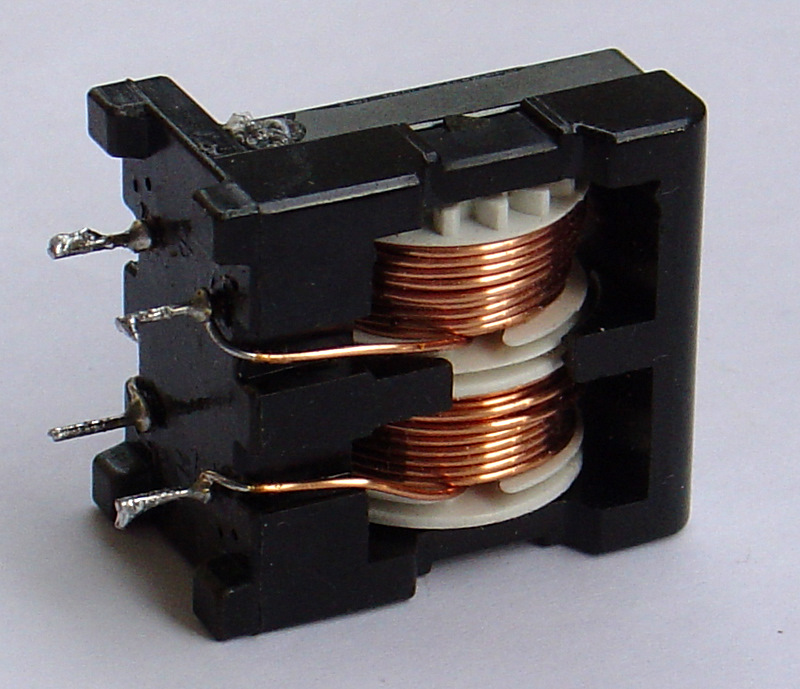

Here's a sample of such choke. Two windings, 30mH with a Q of 10 each, physical size of about 28x30mm. Can be used as common mode choke, or with the two windings in series (cross connected); in this case it measured as 100mH with a Q of 24.
So, why bother though. What's the difference between a 1mH choke and a 30mH choke? The 1mH choke in the simulation example above makes the 1kHz noise 12.5 times lower, whereas The 30mH choke makes it 125 times lower.
Disclaimer: I'm not selling old monitors or such chokes. I'm merely saying that such chokes exist and you'll feel good about doing something good for the environment. Most old electronics end up in the landfill.

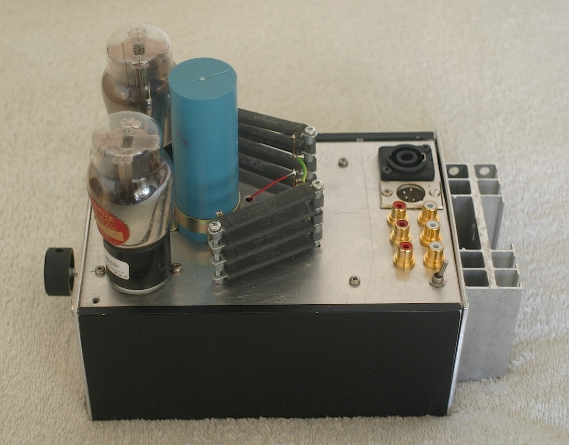

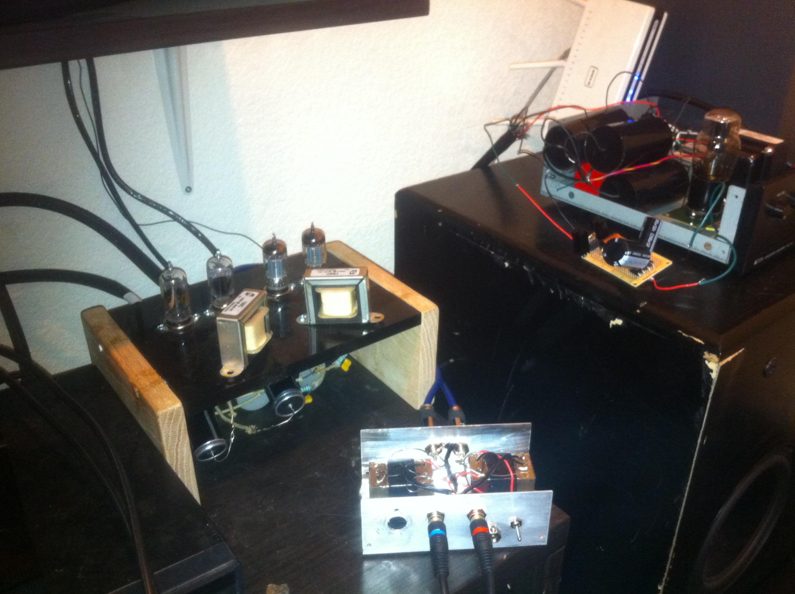

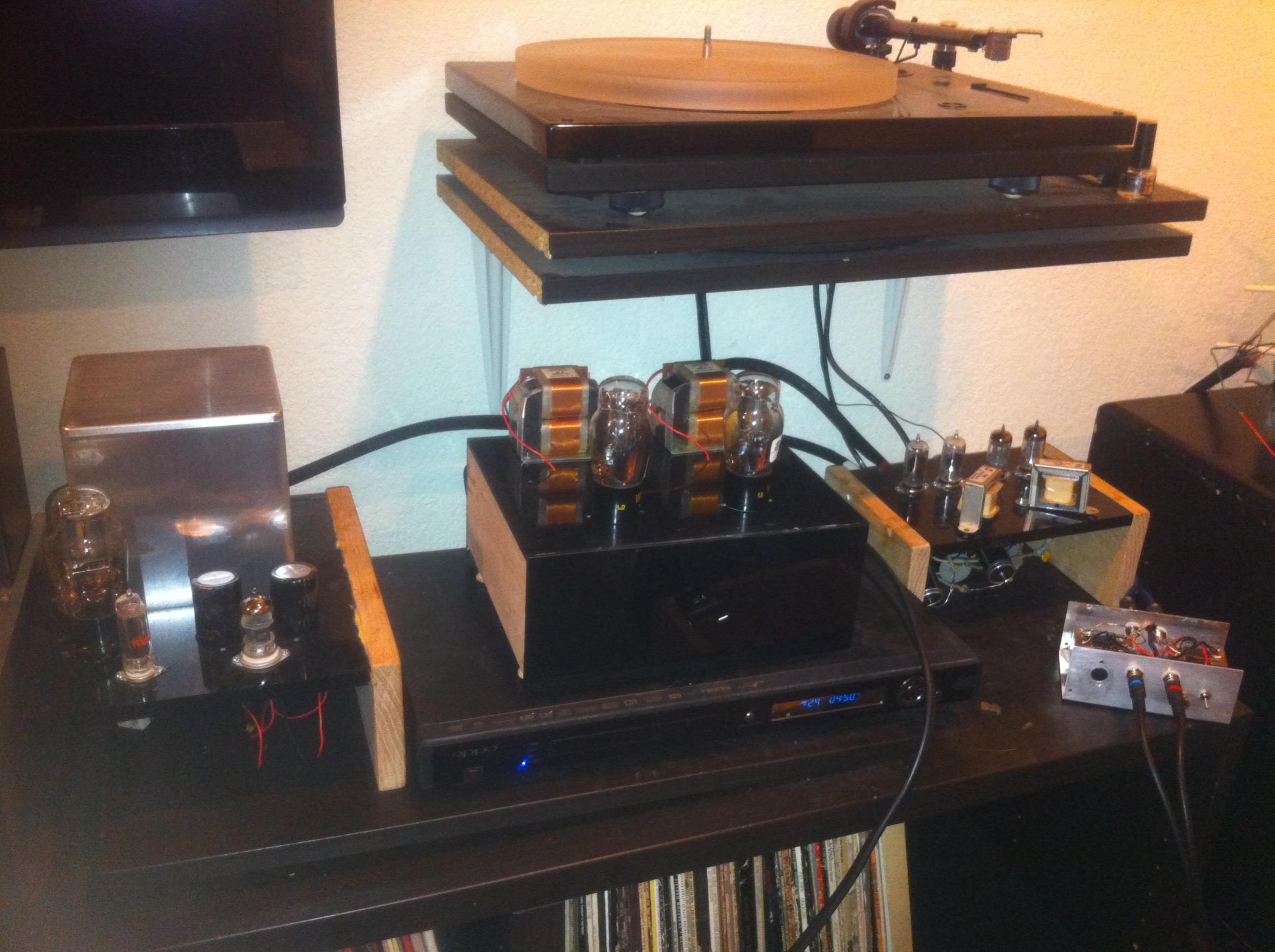

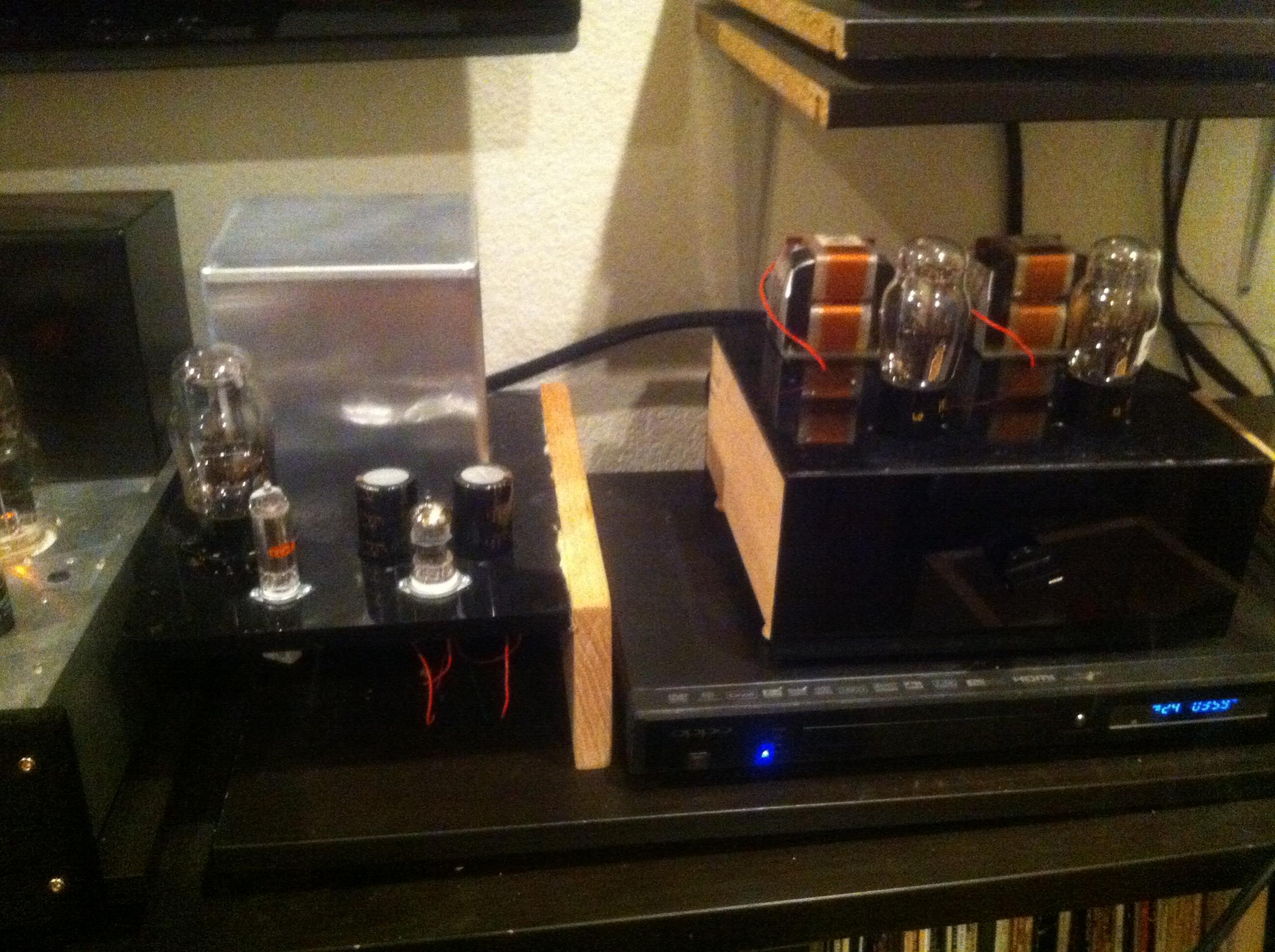

Glad to show! Never posted pics before hope I know how. Heres a few, 26 PSU is on left in the pic, the 0b2 and 12ax7 aren't hooked up, they were for an older design for a series regulated filter that also used 6v6s.. got rid of this circuit due to inferior SQ over passive filtering. Then the 26 signal chassis.. then next to that my phono stage and its psu. The front panels are left off for now due to some recent tweaking. Anyway, here they are..

You need a very clean supply for filament bias, and the resistor types are important - should be wire wound and not those crappy white ceramic ones. Needs about 50 watts. I have some, or use multiples of those Welwyn green ones that Farnell etc sell. I use a choke input supply and a Rod Coleman board - the choke makes a difference. Hammond do suitable ones. You need an 18v secondary on the filament transformer.
