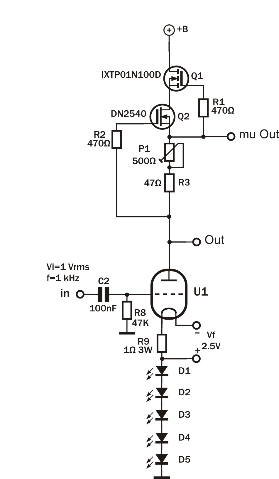

Hi guys,
I have been playing around with a test bed for a 26 pre-amplifier. What I also did was to measure various valve distortion on a simple setup. Mine is a CCS loaded 26 valve with LED bias for simplicity, and also what I had at hand.
My laptop/soundcard is having some issues in measuring distortion, however I had applied same method across the board, so what I aimed at in my tests was to identify which valve/brand had the lowest distortion figure.
I run the 26 at 8mA and anode voltage was around 145V to 160V depending on the valve. In summary what I found was that lowest distortion was provided by the Sylvania ST 26s. See below my table:
The LED array provided Vg=-8.2V @ 8mA
Valve THD
Sylvania 26 ST 0.022%
National Union ST 0.0305%
CX326 globle 0.046%
Super Silvertone ST 0.046%
Sylvania 26 globe 0.024%
I did get slightly better results with the 4P1L! This valves is really linear. Well, Andy said it's very microphonic. So will need to do a listening test.
I will build a modular pre-amp so I can play around and exchange different valve types, loads like choke, CCS, etc. and different bias
Hope you find this simple testing a bit interesting as I did!

Those #'s are very good, this was on the mu out? What was the load? Most soundcard have a terrible load for testing preamps (~1k).
