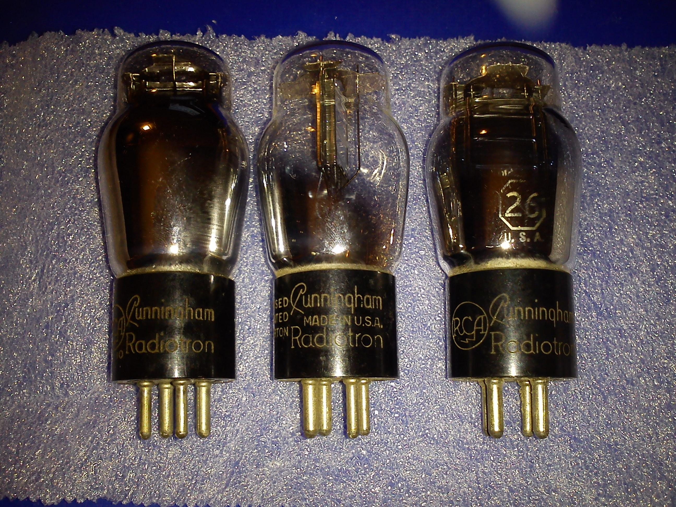

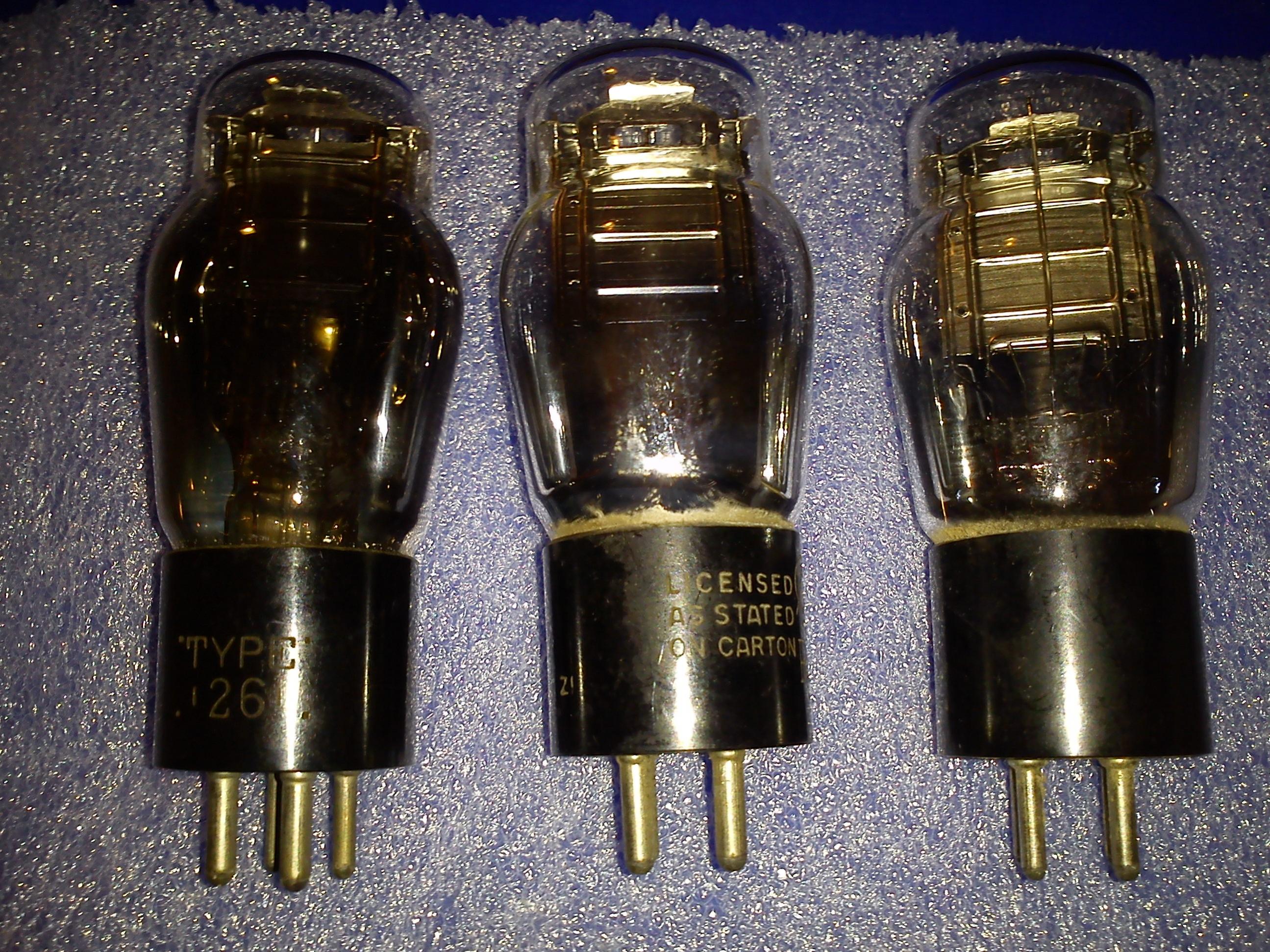

Attached a photo with the 3 tubes Cunningham 26, someone could do a look to see if all three are good?

Regarding tubes, you never know if you don' t try. I did' t have good luck with RCA, and then I had 4 Sylvanias, and after a while one of them had strange noise and I replaced it. But so far I like the sound of Sylvanias better.

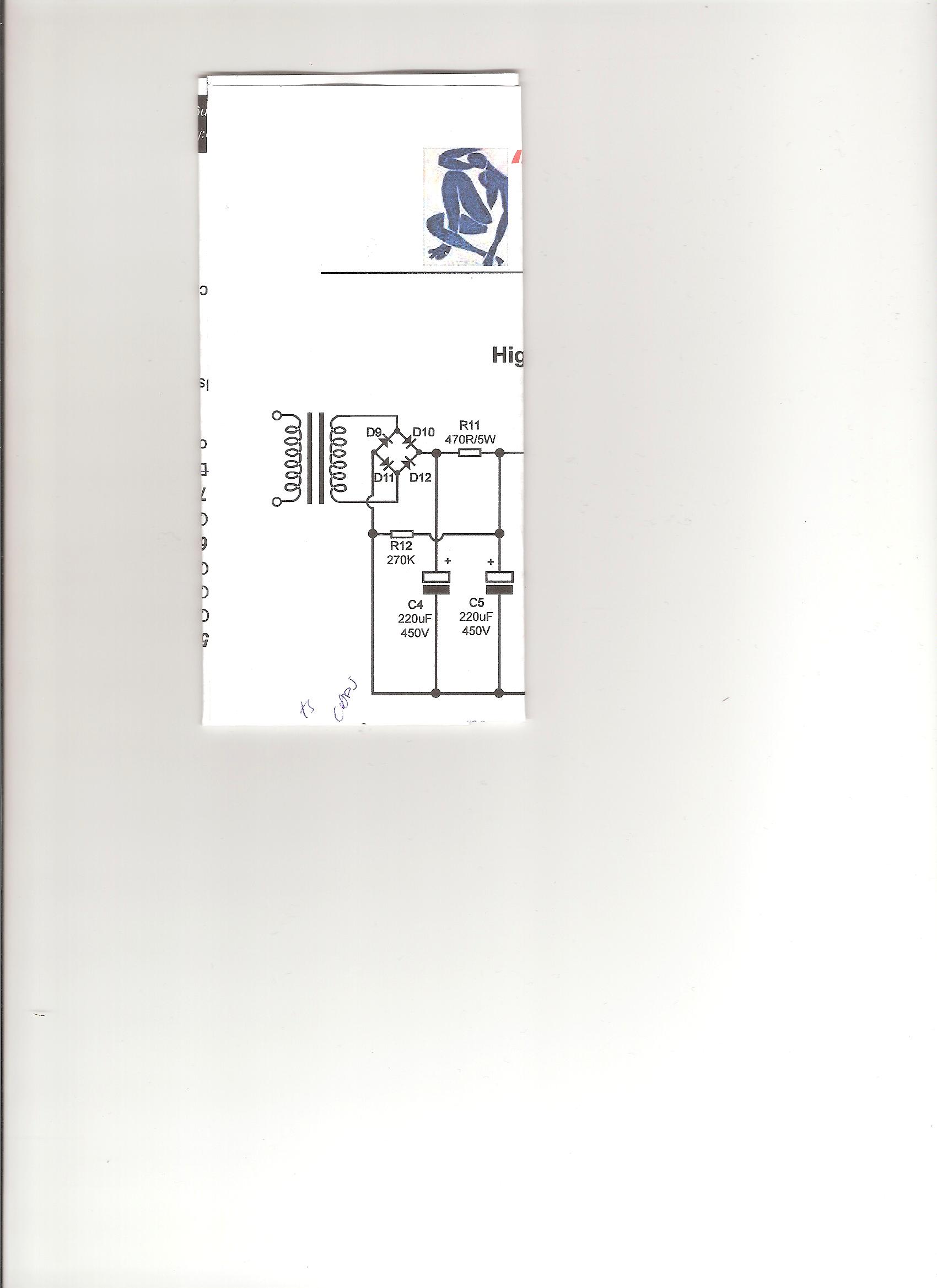

About power/voltage needed for tx I will use this psu
You can use an output transformer, provided it has enough inductance for the tube you will use. It will help me to reduce gain and output impedance also. You can find more info in this thread if you search.
If you use a ss bridge, you can get away with a 0-150V and 100VA transformer. I prefer tube rectification.

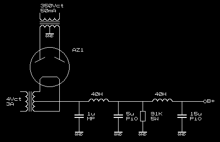

I need schematic for psu with AZ1 rectified & last updated 26 preamp schematic?
This one be OK
