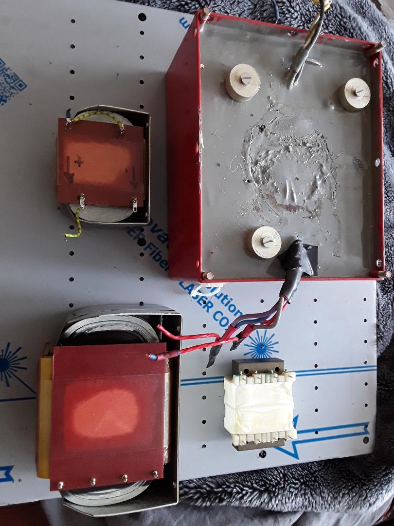

As you can see in the attachment i am using choke input all over!
In the attachment you can see the seize of my old transformer and the little Lundahl ( 544mH) used for choke input for my DDDAC. NOW it has been replaced with a 3000mH and a much smaller transformer. I have tried going for bigger chokes and usually it is a big improvement. The bigger the choke the smaller the transformer. A bigger choke will not be double the price with a transformer prices go up much quicker.

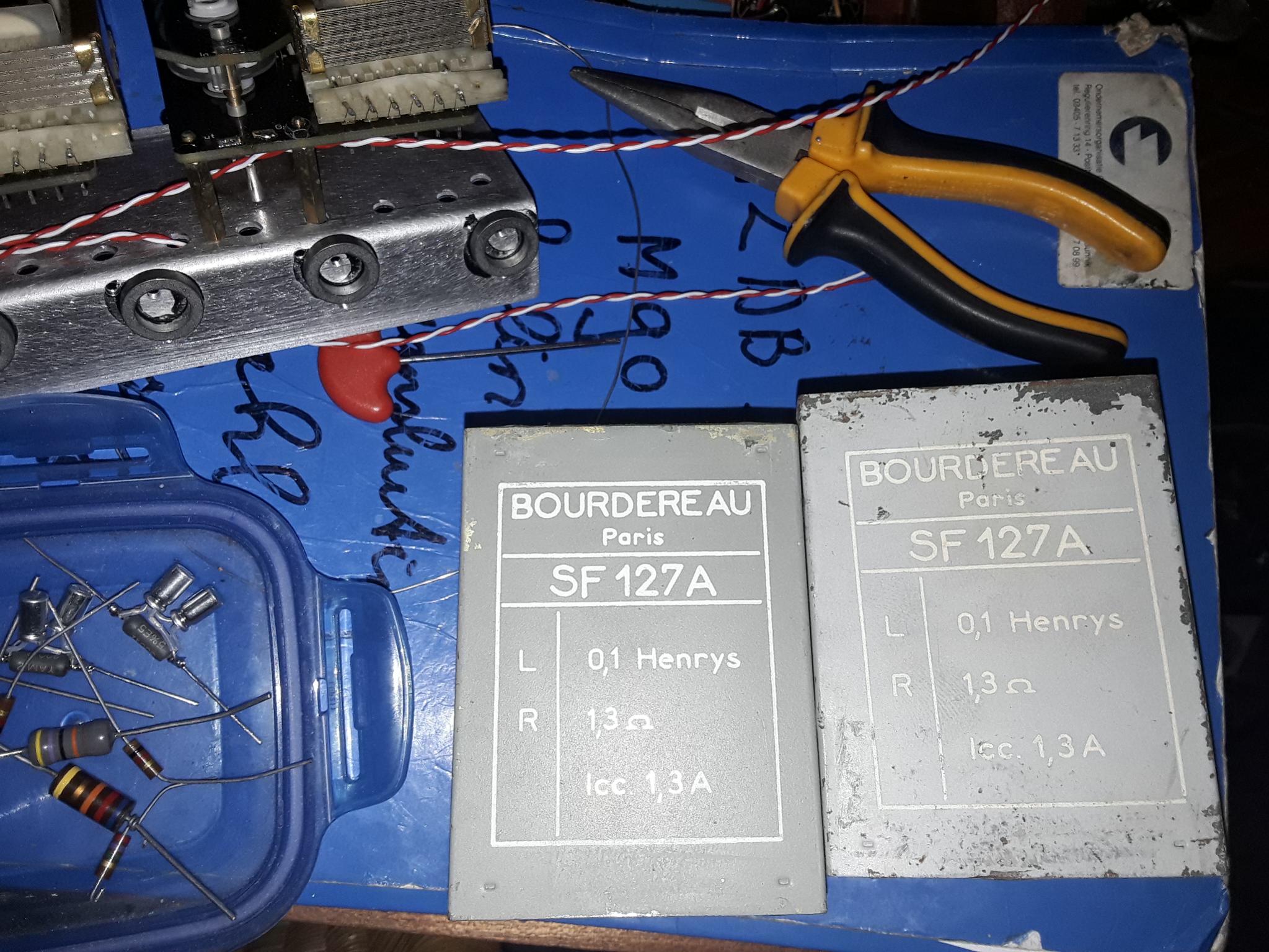

Felipe i can send you a pair of vintage 100mH 1,1 A for 15 euro each can be used for choke input dont know if they are better than the Lundahl but i am sure they are professional made by Bourdereau. FRENCH EMT GOOGLE FOR BOURDEREAU PLATINE. greetings, Eduard

The Bourdereau i have are 100mH, 1,3A and 1,3 ohm. 1,3 A so you can have a little bleeder .Sending a pair to Catalonia would be 12 euro

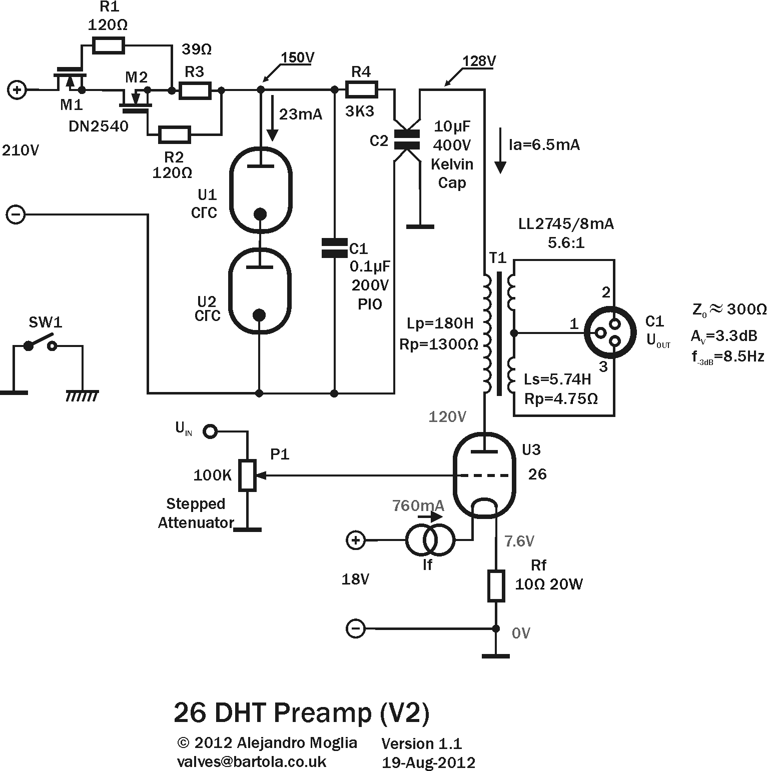

I few days tried the 26 with Ale Moglia Gyrator as headphone amp, I guessed the output impedance can be enough for my Sennheiser HD600 without measurements connected directly the phone to the 6.8uF output cap, sounds tonality was very good but lacks of dynamics like you are listen to long from the sound.
So measured the output impedance giving a value of 867,2354 ohms & a damping factor of 1,38 so measurements confirmed me the need of a second stage to use as headhone amp.
Measured the other headphone amp 5687 triode OPT 15K/600ohms Edcor output impedance 196 ohms and sounds wonderful.
I'm curious, how can the output impedance be that high, the gyrators output is very low.
Gyrator was set 7mA each tube.
330 ohm dummy load (to simulate Sennheiser HD600), 1kHz square wave & true RMS meter was used to do the measurements.
