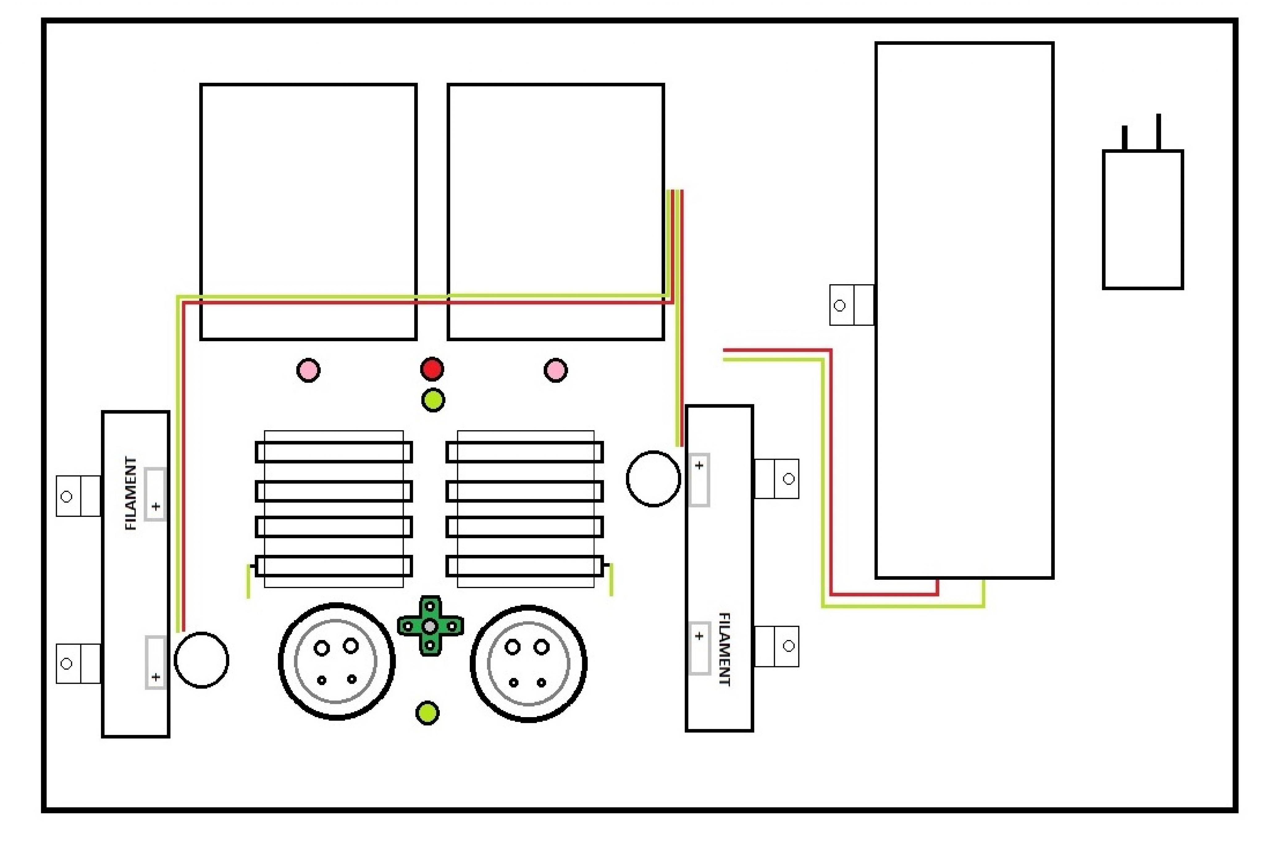

Here is an attachment with an unfinished sketch of a layout that seems to have some potential. With the filament resistors close to rectangular holes in the bottom one should think that there would be some sorely needed cooling from outside of the chassis. But I've seen that almost everybody (not really. Just Andy and Ale) uses vertical stacked resistors. Is there any advantages in going vertical vs. horisontal?

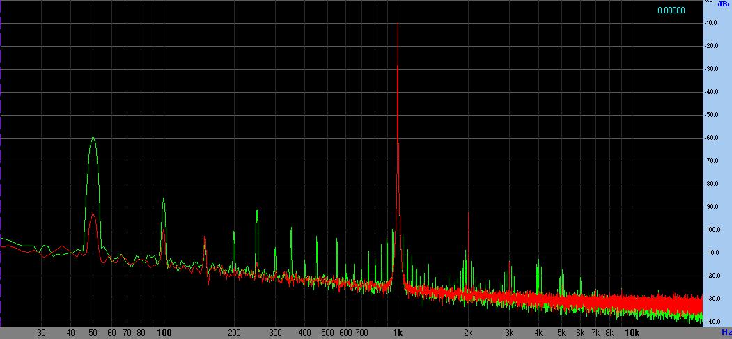

I have few dozens of #26 tube, from different manufacturers (Cunningham, Fada, Majestic, Philco, Radiotron etc.). Most of them is -older- globe type.
My #26 preamp (two box type, PSU away from tubes -about 1m-) has wood frame and 3mm aluminium plate (open in bottom).
No extra shields, and no hum .... with appropriate (selected) tubes.
Some tube sensitive to radiated hum, some almost insensitive.
As you can see (measured in my preamp), within same products the (50Hz) hum sensitivity difference would be over 20 dB!
Sorry, I have no idea.
These tubes are made from -about- 80-90 years, so anything could happen (mechanically?).
The tubes made by the same manufacturer (Majestic), -I bought these as matched pair, gm is almost equal- , the position in the preamp (location, heater supply -incidentally I use Rod Coleman regulators- etc.) is indifferent.
