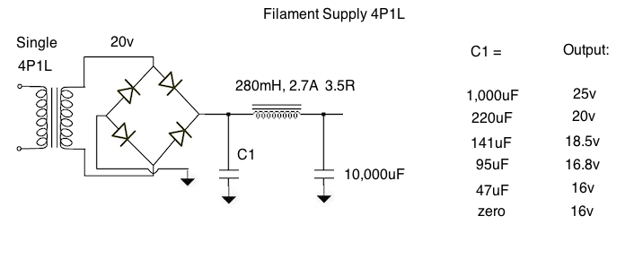

I can supply a couple of my 2.7A 280mH chokes, or you can order Hammond 159ZC chokes from Bluebell Audio. Your 10,000uF caps look OK. A 15v filament transformer like the Weiss you have might be OK for cap input with a choke after it - maybe..... It's a bit close. But choke input makes an audible difference.
For the HT power supply I'd suggest a 80 rectifier - I have a few of those, though I actually use a AZ1 mesh. I see you have a third UX4 socket, which is good for a 80. And a glow tube as a simple reg. This can be fed with a dropper resistor for starters, or later a couple of DN2540 which is a better option. But for caps in the HT supply I would ONLY use motor run polypropylene caps. No electrolytics anywhere. 40uF motor run caps are cheap on ebay. or these:
Universal 25 UF Microfarad Motor Run Start Capacitor (400V 450V 500V) | eBay

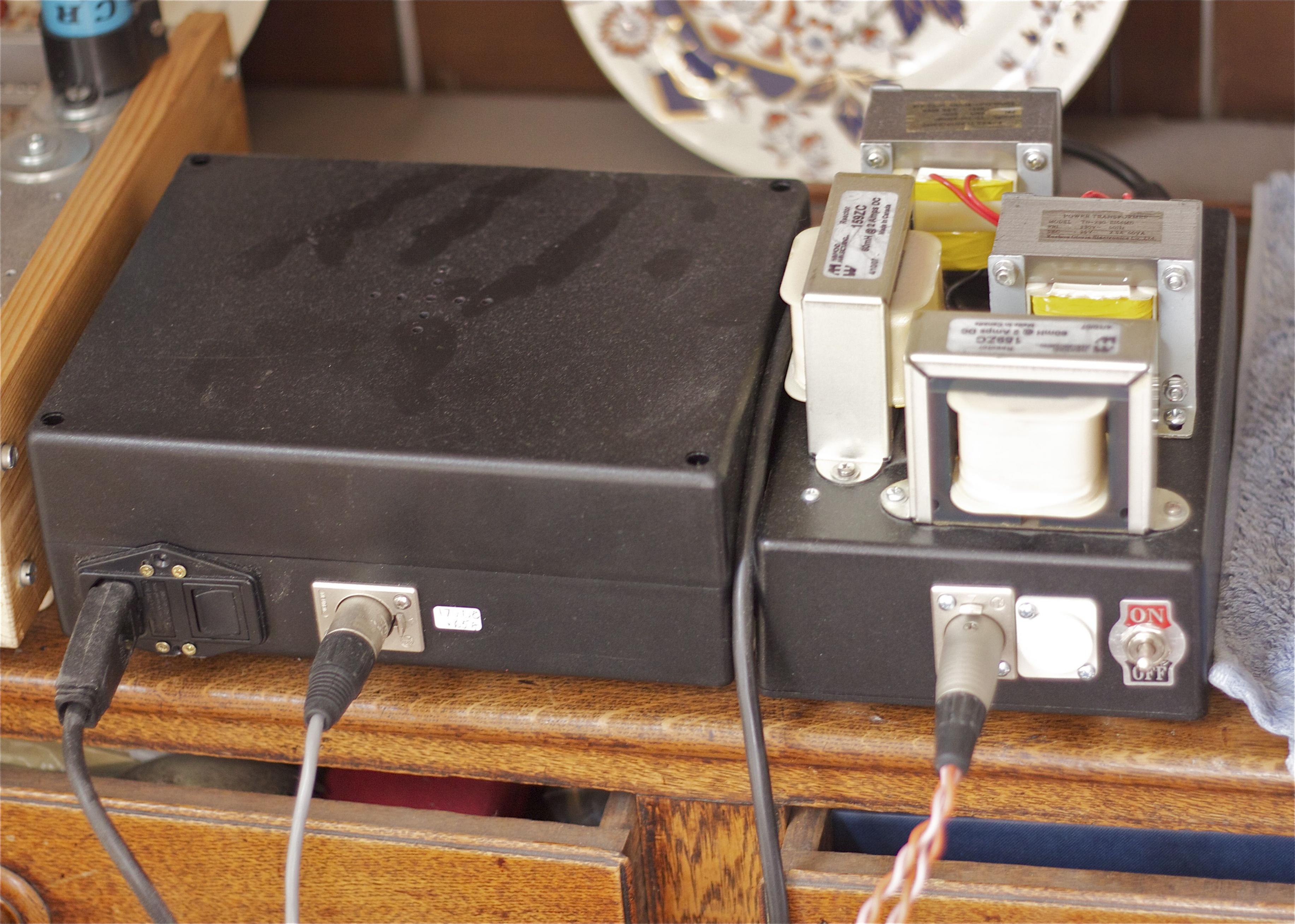

You should be using an outboard HT supply and an outboard filament supply to keep the chokes away from the main chassis. I use 4 pole speakons for the HT supply and 4 pole XLRs for the filaments.
With these kind of filament bias designs, all the real quality is in the power supplies. The actual 26 circuit is very simple.
I've attached photos of my 26 preamp PSU and the filament supplies for my 4P1L amp. One has the transformers and chokes on top, the other inside.
