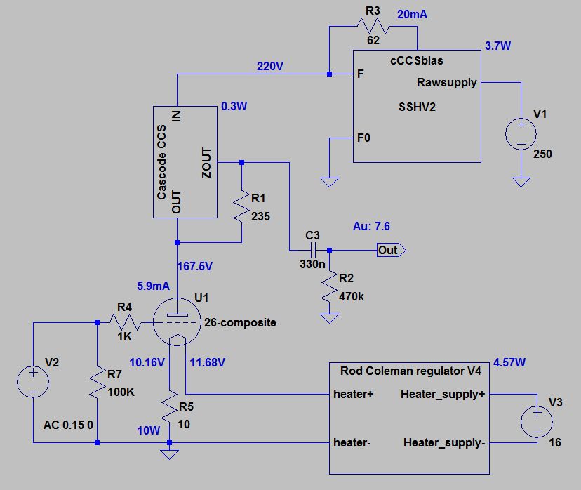

First up I would like to thank Rui Lourenco for building his fantastic implementation of the 26 DHT Preamp, and secondly for parting with it to enable me to finally get up to speed.
Since it arrived I have enjoyed listening to it, and marveling at the quality of work which has gone into it. As can probably be expected, I have also been musing over what, if anything, I may have done differently if I had built it.
The only real change I came up with was a switch from cap input to choke input on the HT. After this I upped the SSHV2 from 23mA to pass 30mA, and slightly upped the 26 filaments from 800mA to 875mA.
Overall a slightly bigger, more muscular performance with a bit more colour. Nothing huge, but I like the outcome.
Finally, I thought I would draw out the circuit of what I now have. For politeness, if nothing else. 😉
Hello,
the preamp really looks good in the pictures, congratulations. Just a small question, after all these chokes and the capacitors in the HV supply, was the regulator really needed? I do not know, but I do not think that much ripple has been left for the 12mA of current and after multiple 10 and 30H chockes and 50uF capacitors... Did you try without?
Best regards,
Pred
It'll work like a charm without regulator. Because the filament is held in a double nelson by the filament supply it's beneficial to tie down the other end too. If both ends were freely drifting on the mains things would probably work out fine too, but how to assure drifting in equal amounts? All for less distortion 😀

Try this.
