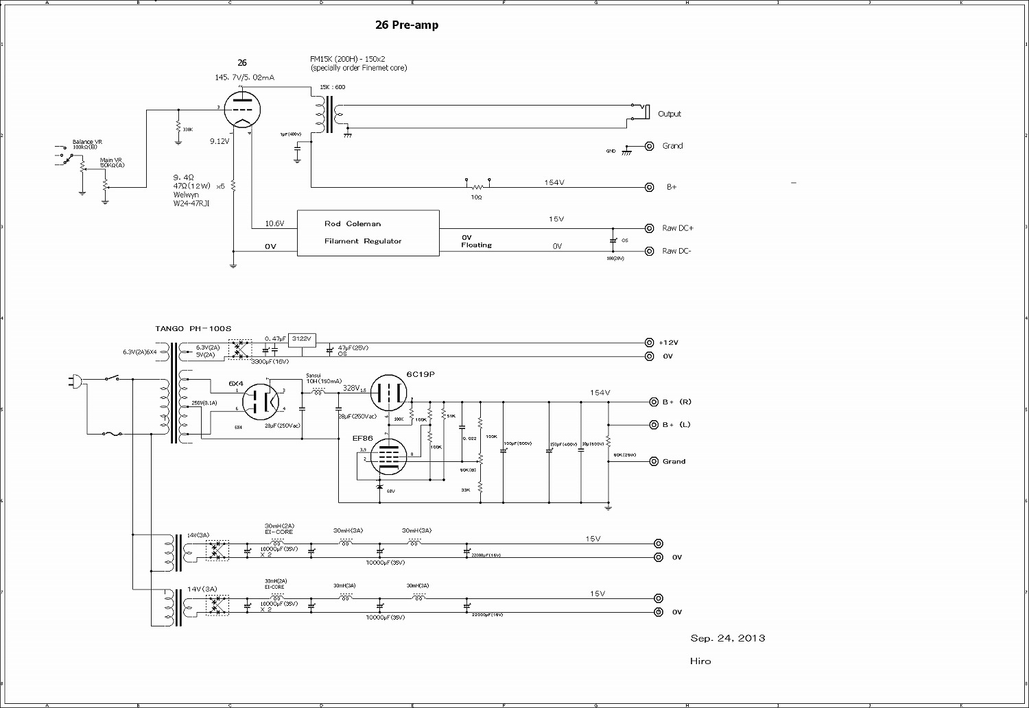

I dont have a schematic drawn out yet but it is basically a 26 with coleman heater and filament bias => 1:1 interstage from lundahl => 307A triode strapped with both screens tied to the plate => Edcor 5k to 6ohm output.

Updated schematic of my 26 Pre-amp

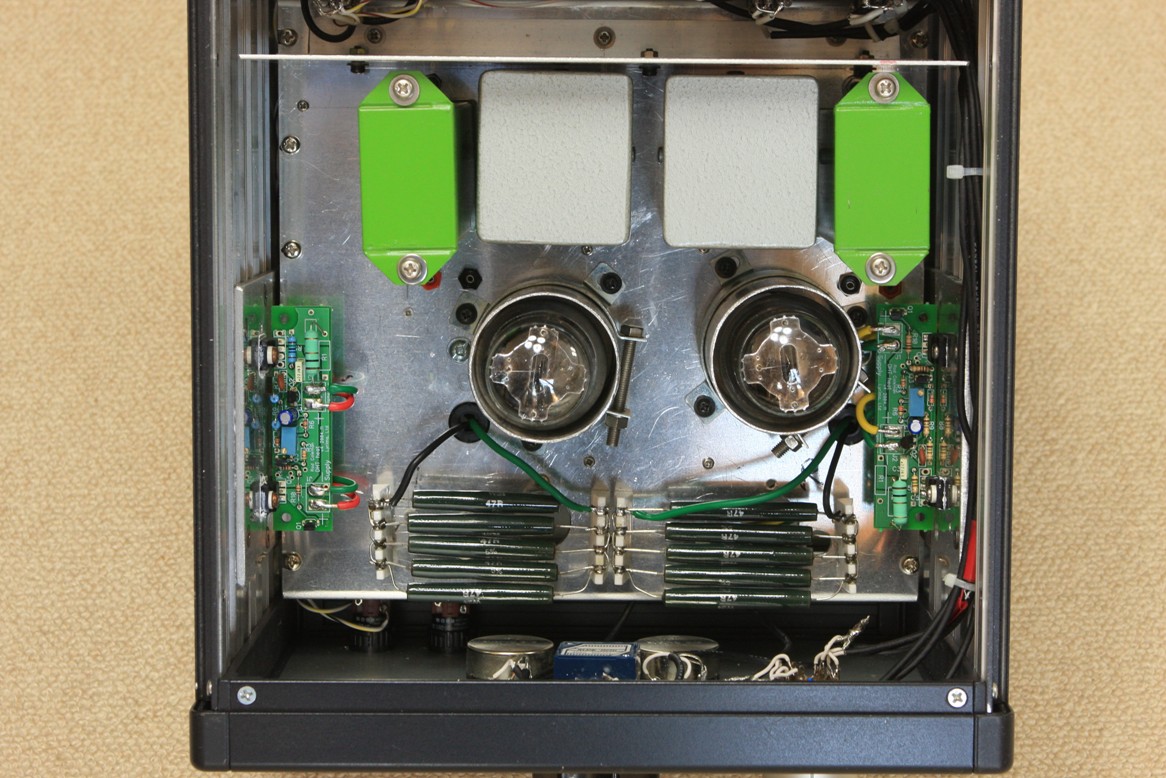

Just one year elapsed since I posted here on my 26 Pre-amp, I have made various modifications to my 26 pre-amp adopting ideas / hints obtained from this forum namely in valuable : Rod Colman, Kevinkr, anyjevans and mogliaa.
As a result, I feel it has got a vital in vocal regardless to Jazz or Classic, though it does not fit to a soft containing wide dynamic range or ultra low end.

Unfortunately, the OPT used in the schematic is not available, however possible substitute are assumed to be available, the following is catalogs for your references.
You can see the price list for Noguchi FM-20K600CT, FM24K-600CT and Andix Audio RT20K600
