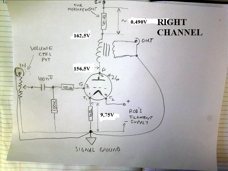

If you take the tube from the left channel and put it in the right channel, and if you still measure 0.18V across the 100R resistor, then the problem is not an old tube in the right channel.
OK I swap the tubes & measures voltage across 100R resistor
So can't change the right channel tube as Iko suggested?
Yes of course. But I would put same values (20k) on both rails to see if its the tubes that differ.
One takes 4,6 and the other 6,4 now, and thats a big percentual difference with almost the same B+

If you have 20 k on both filterlanes, the measurements will be more accurate over that then over the 100R, when changing tubes
Now concentrate on the fresh tube. Let the other one sit but measure on the fresh. What your up to now is to decide how to drop the 90 volts. A resistor gives the feeding an unnessesary high impedance. You should consider a shunt. It drops without adding impedance. VR tubes were suggested. SSHV2 also drops that easy at those currents (in fact im not sure how well it behaves under 10 mA, ask Salas or other guys that has used it here. Glow tubes are nice. 85+85 gives 190 Volts and 40 for SSHV2.

Same tube now measures 0,490V across 100R, I adjusted the tube at the socket it seems don't do good contact

Salas advice is set the SSHV2 to 30mA, 20mA consums the reg itself at the other 10mA for the 26.

Correct. But how much does your tubes consume?😉
You just measured it. It's the voltage across the 100R resistor, divided by 100.

left channel 6,6mA
right channel 4,9mA
So if I will use SSHV2 I have to adjust for 31,5mA🙂, is a pleasure to learn.

Either use Salas' shunt, or use a VR150 tube. Forget the gyrator, that's TO REPLACE the output transformer, which you want to keep.
VR150 + DN2450 would be my cup of tea, depending on my level of noice kill. with higher ripple SSHV2. There you have an out of the box well singing solution. Shunt + CSS is for learning, expect some trouble😉
