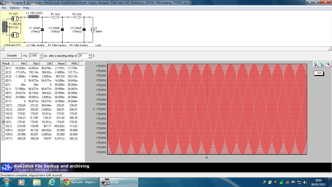

My PSU target for B+ is 170VDC 30mA for Salas SSHV2, what about attached PSU?

I use a small grid stopper, 390R. It may not be necessary - I haven't looked into this. You absolutely have to have a grid leak or the tube will oscillate. I have a 100K pot on the input so that acts as grid leak.
You can use up to 60uF cap with the AZ1. Normally a small cap is good so you have choke input or "virtual" choke input. If you do this you have to make sure the choke is in regulation - may need to be followed by a resistor to earth probably somewhere round 10K and needs to have sufficient wattage.
But since this is followed by chokes, caps and a shunt reg (or DN2540 + glow tube), it may not be too audible. If you need to keep the HT high enough then sure, you can use a bigger first cap. If you have plenty of voltage you might go for a "purist" approach and use choke input or a cap up to 1uf or so. Plenty of choices, and they all work.

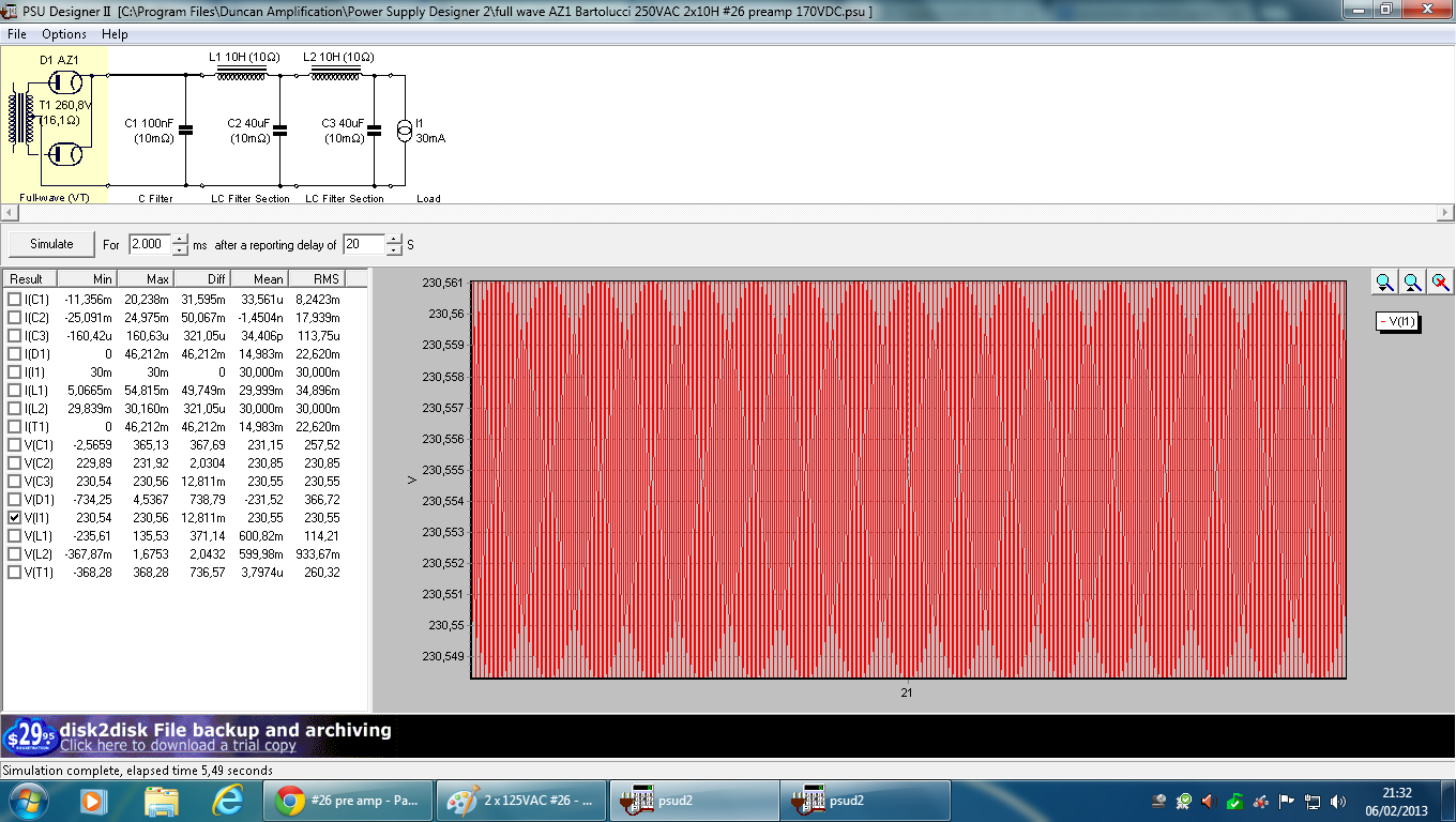

I'd say more like this, with 250v secondary. I use all polypropylene caps - motor runs. The 10K resistor after the first choke is probably overkill - it depends on what the circuit draws in terms of current. I don't know what the shunt reg draws. You could leave out the 1uF input cap or use somewhere between 0.1 and 1uF. I like to put a small cap in there. Choke input with 250v secondary should end up giving you just over 200v with all the chokes, caps, resistors etc, before the shunt reg. That would be fine for a DN2540 plus 150v glow tube. Don't know about a Salas reg - never used one. If the voltage ends up being low (the resistor after the choke will lower the voltage depending what size it is) you can increase the size of the first cap. You need to read about how to keep chokes in regulation and look at the formula for choke input. For cap input above about 4uF it probably doesn't matter. I'm being a bit vague about this because I have a Mac and can't run the PSU calculator.

Here is an article for choke input. You need to work out critical inductance.
Choke-input power supplies, Part 1 - Henry Pasternack - Tube DIY Asylum
Lcrit = Vdc / Ima
where Lcrit is the minimum (critical) choke inductance, Vdc is the supply DC output voltage, and Ima is the load current in milliamperes.
So Lcrit for 250v and 33mA (e.g. 2 x 26 at 5mA plus regulator at 23mA) would be 7.6 Henries. So a 10H choke would be fine without a resistor to earth after it in this case.
For 2 x 26 at 5mA each and 20mA shunt reg, total 30mA, you need a choke of 8.3H so again 10H is OK.

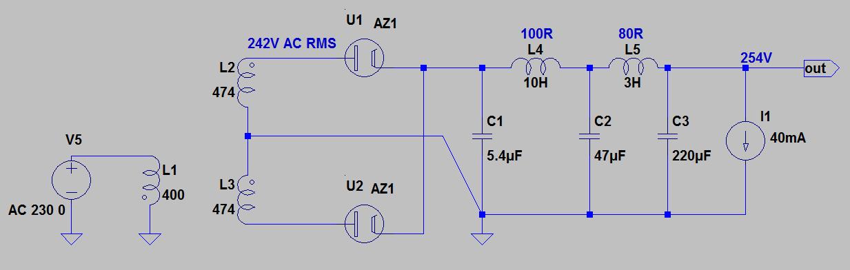

Such a low transformer DCR not optimal for (mesh) AZ1. It would be better 100-200R DCR.
IMHO C1 low, thus output voltage also low. There are no high charging current (AZ1 unable to do so) therefore increase C1 up to 1-5uF. If output ripple bothering you, increase C3.
ps. PSUD a little cheating, output voltage about 220V, not 230.
Ps2. Attachment is my working #26 preamp (common raw PSU- each side: SSHV2- cascode CCS loaded 26 -TVC) raw HT supply.

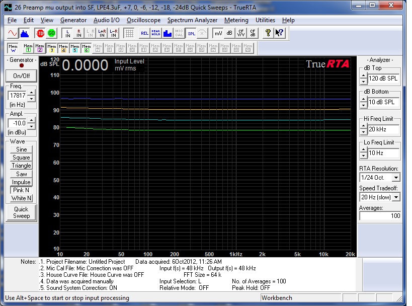

Magz very nice build, do you know what the output Z is?
The output Z varies based on the volume setting, since I'm using the autoformer volume controls as my output "transformer" as well as a volume control. The autoformer is fed from the mu output of the 26 plate CCS in lossy parafeed, so the output Z at 0dB attenuation will be about 1500ohm, at -6dB about 375ohm, at -12dB about 94ohm, etc. I usually listen with the preamp volume control between -20 to -6dB, so the output z is less than 375ohm almost all of the time.
I've attached a frequency response plot at various volume control settings, from top to bottom -6, -12, -18, -24dB. The input impedance of my soundcard interface is 20kohm.
Cheers, didn't realize you were using the AVCs on the output. I'll have to read through the last 30 pages of this thread to catch up.
