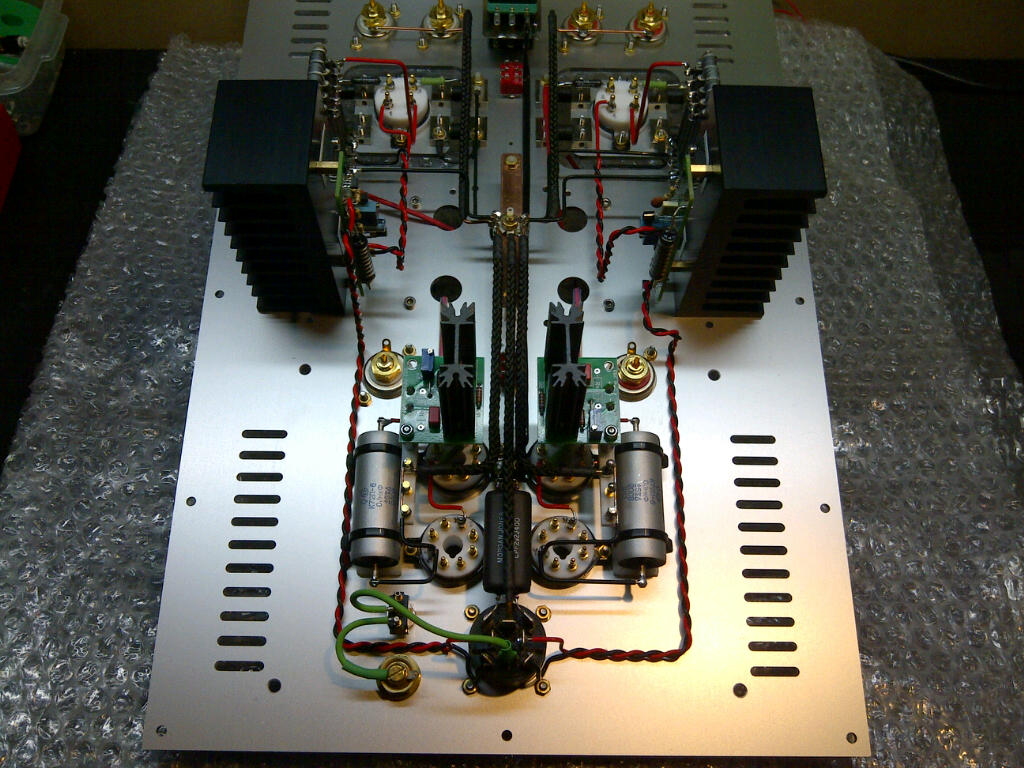

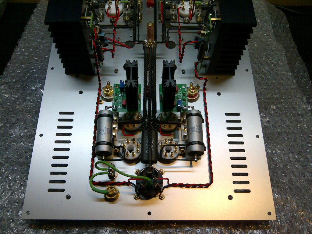

...a litle bit more work done!

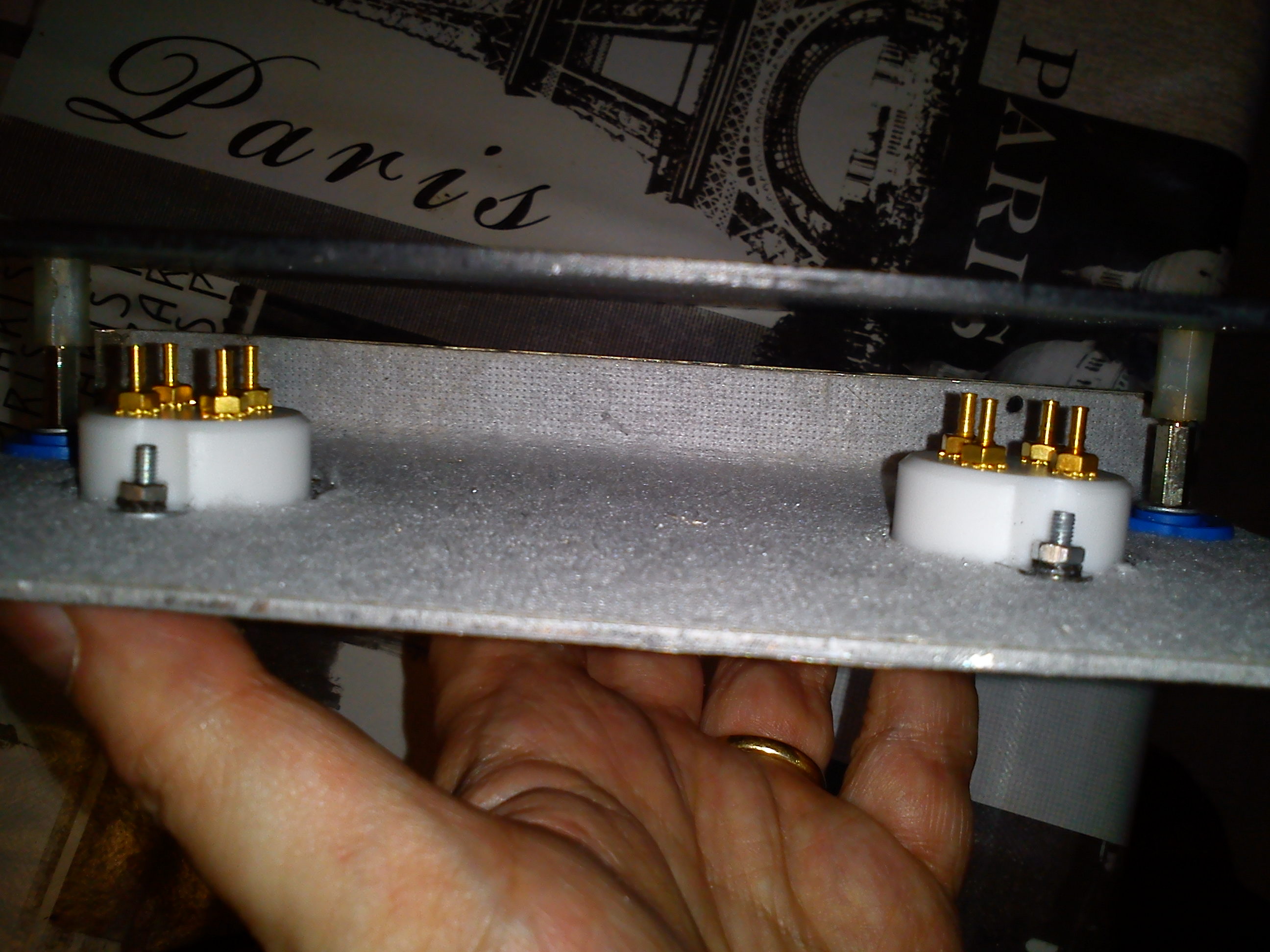

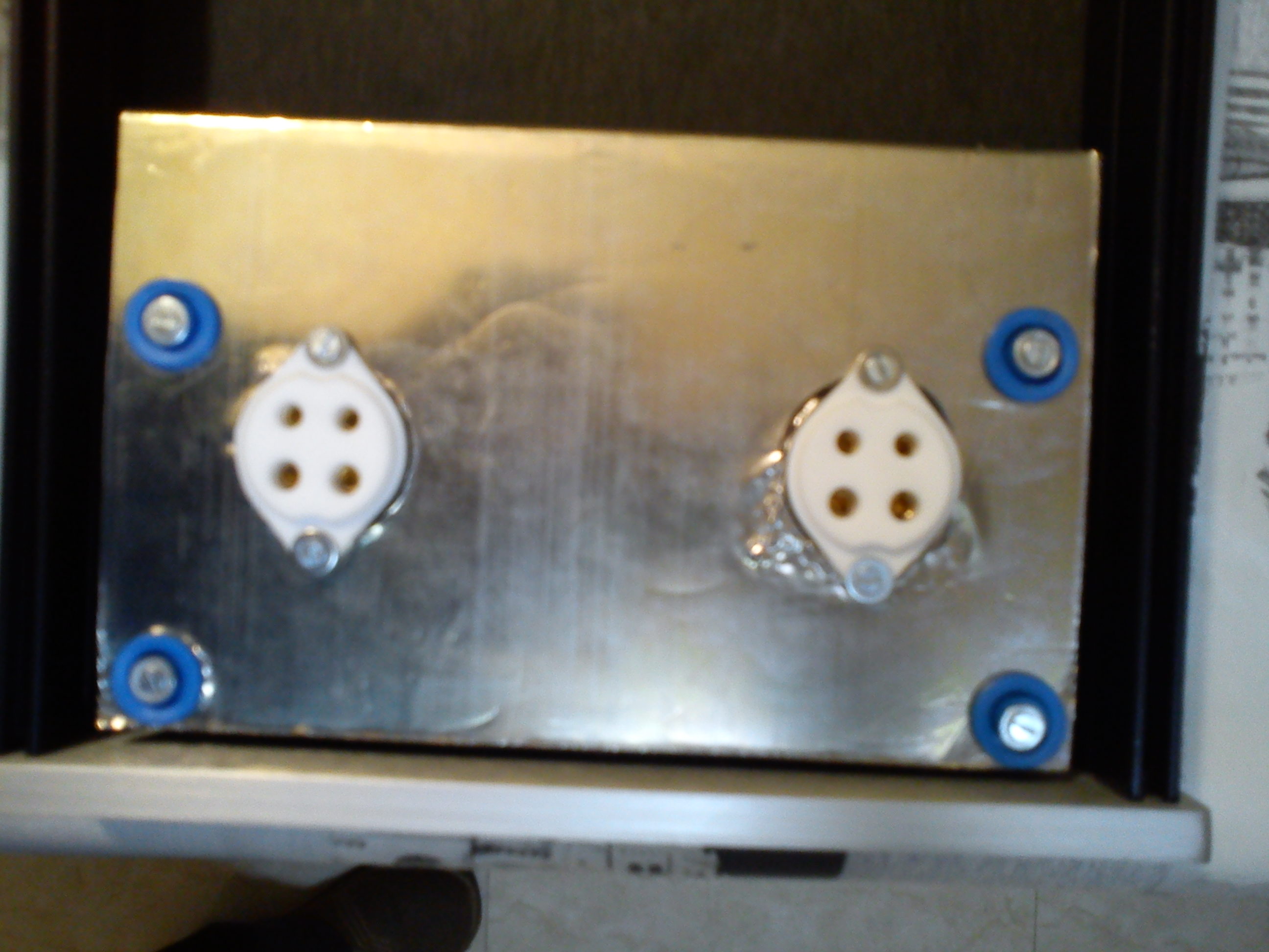

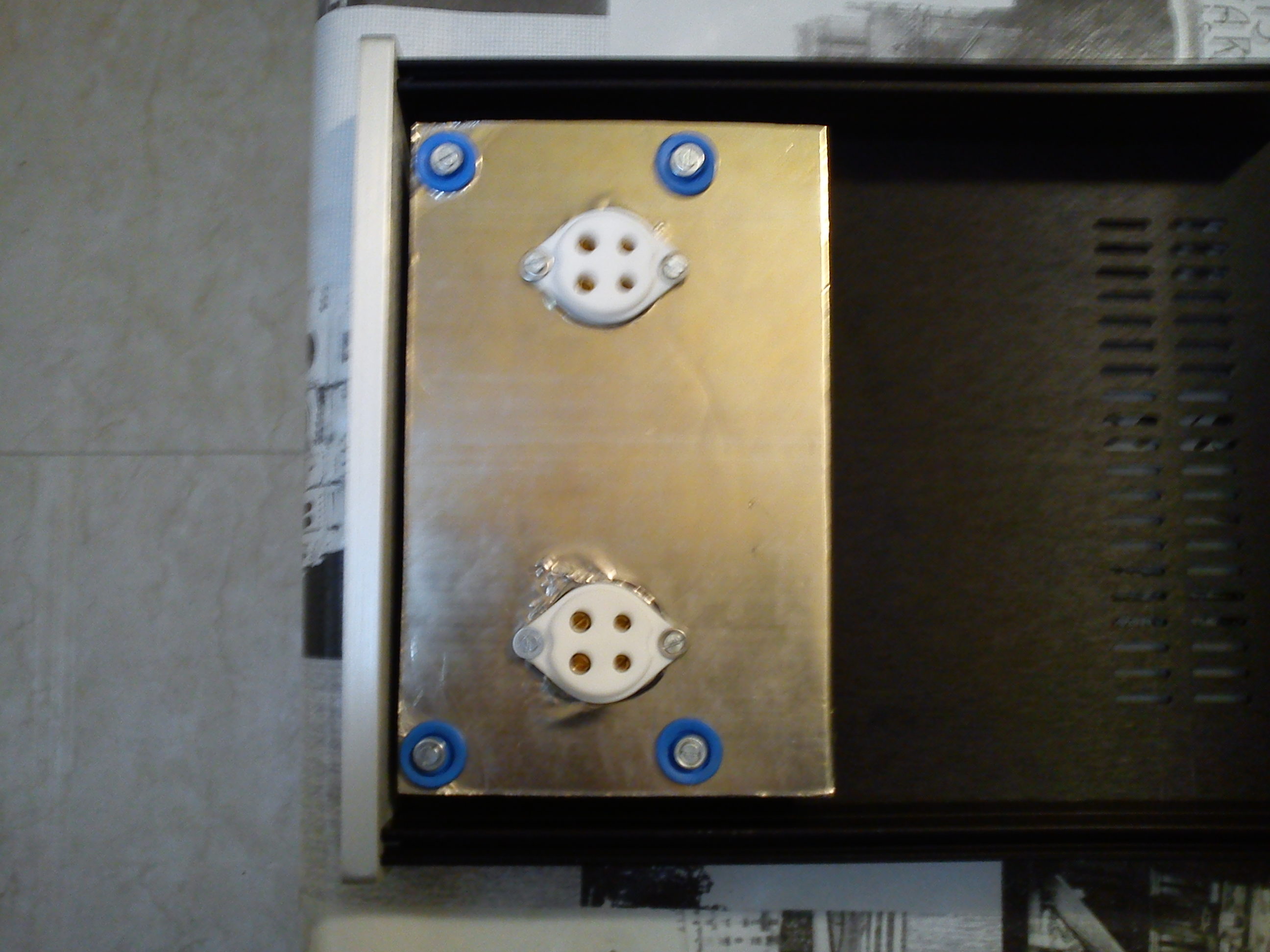

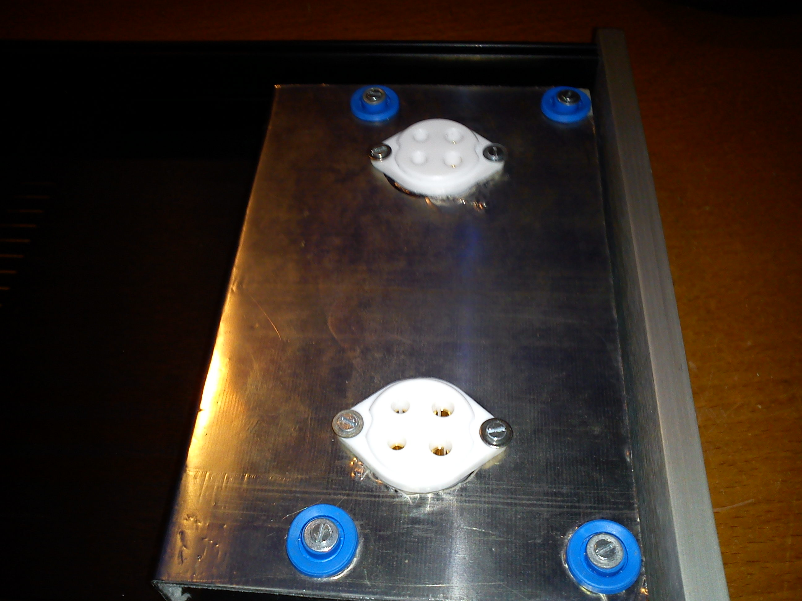

More work in progress: suspended plate with a sandwich aluminium, mu-metal (permalloy) & still-point, of course will be connected to chassis earth.

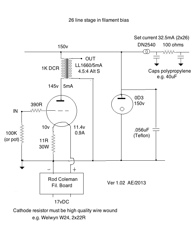

I built another version of the 26 line stage as shown in the schematic, and this is my current favourite. I swing between this and the 4P1L and for now I've gone back to the 26 because it's followed by two stages of 4P1L in my PSE 4P1L amp. I think 3 stages of 4P1L is too much - the particular sonic characteristics get exaggerated. This is working very nicely indeed. Really enjoying listening. Previously I used it in Alt S 4:4.5 but the other way round makes more sense and I still have enough gain in my 3 stage setup. As usual I have choke input filament supply (Hammond 2 x 159ZC) and a 220v PSU CLCLC with AZ1 mesh rectifier and all polypropylene caps. First cap is usually quite small - not over 4uF.

Great Andy, that is practically the same operating point I'm using in my 26 amp:26 DHT pre-amplifier (Gen2) | Bartola Valves
A mix of 26 and 4P1L is better for the sound. The warm of the 26 adds something special that a 100% 4P1L may not provide. Surprisingly I'm not using 4P1L now, I have 26 preamp and then 7193 into the 45 SE. This is why I enjoyed so much the sound of the 4P1L as a line stage before and why I want to rebuild my Siberian preamp!
Perhaps we should learn not to abuse of the 4P1L 🙂...
Cheers
Ale
