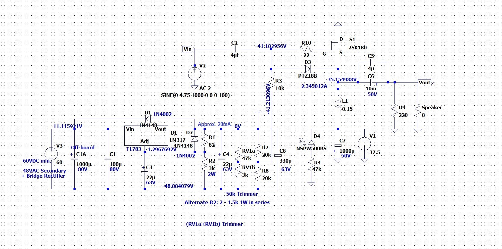

There is a high voltage 3 pin voltage regulator, TL783, that looks like it can replace the LM317. With a few other resistor and capacitor changes and one cut trace, and a higher voltage bias supply transformer, I believe that an independent bias supply can be built on the pcb.

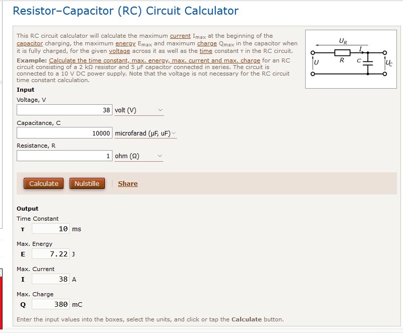

How much power supply filter capacitance and speaker output capacitance do you have? You can calculate the energy over time in charging those up and work out the charging current. Maybe, you can cut back the capacitance values and still be ok.

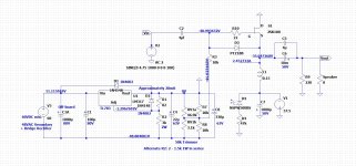

With the combined lower voltage bias supply in series with the V- supply to provide the full bias voltage, the bias voltage ramps up with V-. So at start up, if the SMPS V- ramps up slowly, then so does the bias voltage, resulting an initial high current flow through the SIT. The initial high current lasts for only a few seconds and a linear V- supply can withstand that current demand, but it seems the SMPS cannot.
So I think an independent bias voltage supply is the best solution with a SMPS V-. The SMPS can then be put on a slow start while the bias voltage supply without a slow start can get up to voltage first. That will reduce the initial current demand at SMPS startup.

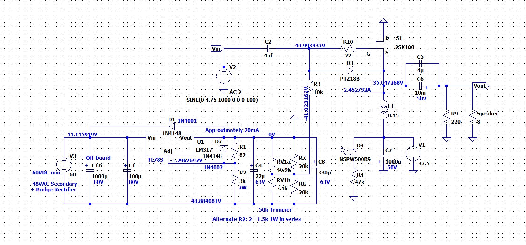

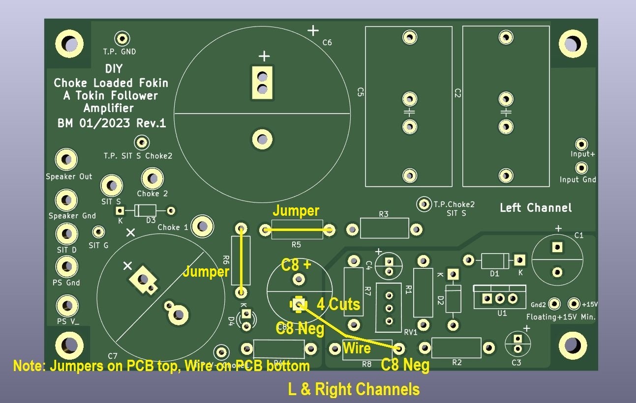

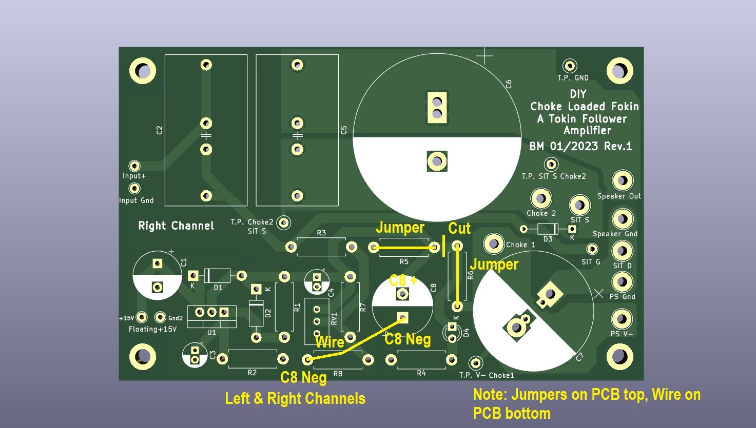

Here is a independent bias voltage supply that can be built on the existing pcb with one trace cut needed. The voltage regulator is a TL783. The 1000uF 80V capacitor is too large for the board but it could be placed off-board and a smaller, lower value 80V capacitor placed on the board so that there is capacitance close to the regulator.

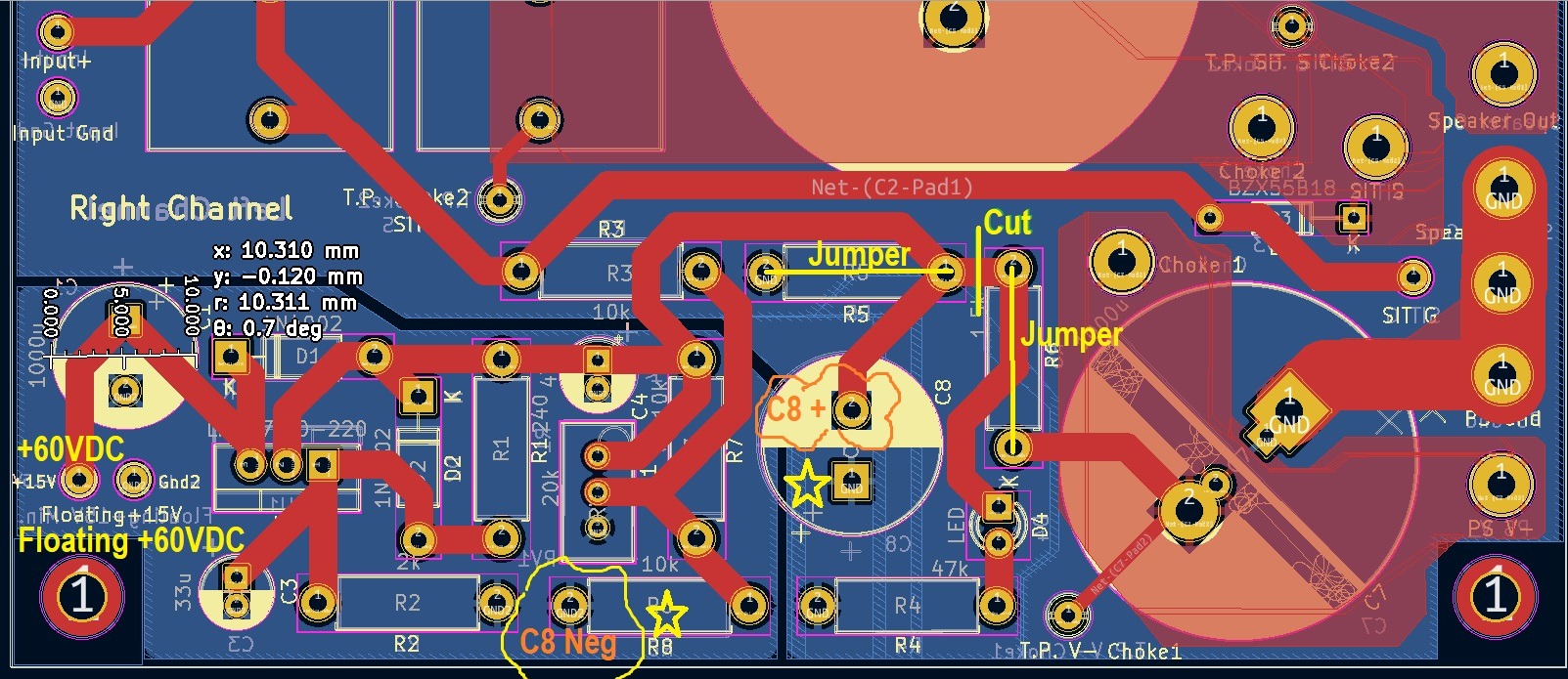

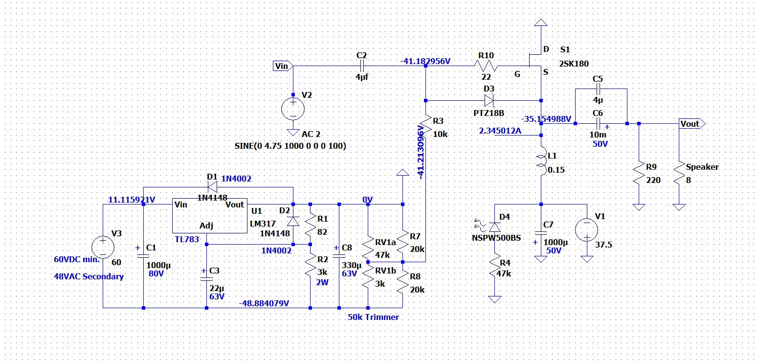

I have done a bit more on the independent bias voltage supply, and refined the design. So follow this new schematic. The voltage regulator is a TL783. The diodes remain 1N4002. Modifications to the pcb are shown. One cut to a trace and four cuts to radial spokes at the ground plane are required. C8 needs polarity reversal and a wired connection
