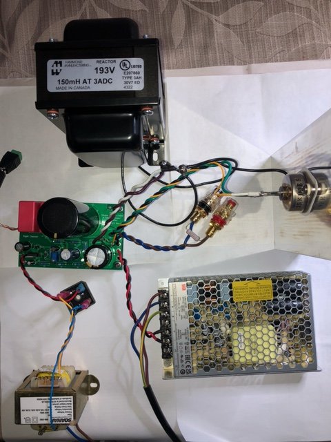

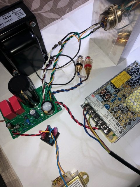

Post some clear pictures of the board and of your whole amplifier, showing all wiring.
Apologies for confusion with ground reference points. I should have measured with reference to TP GND. To clarify:

The way it is currently connected to the Tokin Follower PCB is floating. That is, V+ isn't connected to safety ground.rolotube, how is the Meanwell SMPS connected? It needs to be floating.

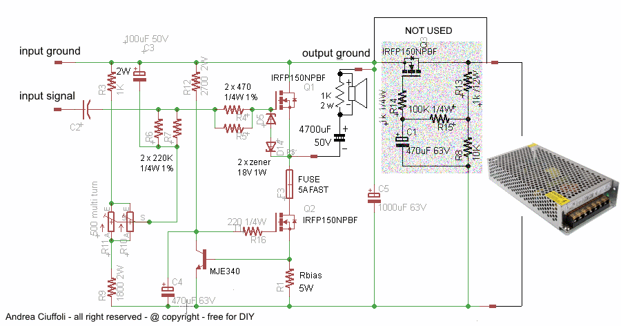

I've used this SMPS to provide V- (with V+ grounded) in Andrea Cuffoli's Power Follower design. He replaced the original linear regulated supply with Meanwell LRS150 claiming it was quieter (https://www.audiodesignguide.com/PowerFollower/index3.html)

All is well - amp is running as it should with lab PS. Put a 1A fuse in V- line, just in case. Powered up bias, let it settle at -11.7V, then slowly increased voltage to 24V. Trimmer was then wound clockwise to get current flowing through SIT. Currently running happily at 1A. Vds = 22.4V. Vg = -25.6V. SIT (using 2SK182ES for this test) is warm after 15 minutes.For now try using your lab supply. If your lab supply does not have a current limiter, you can still use it. Wire a fuse in the DC line to the amplifier board. Also by starting the lab supply at zero Volt and slowly increasing the voltage you can stop if you see the current rising too fast. If the circuit is working properly, there should be no current flowing with the bias voltage set to maximum.
So problem is not with PCB, its the SMPS. Despite working with grounded V+ in the Power Follower, for whatever reason it won't work in this configuration with the Tokin Follower.

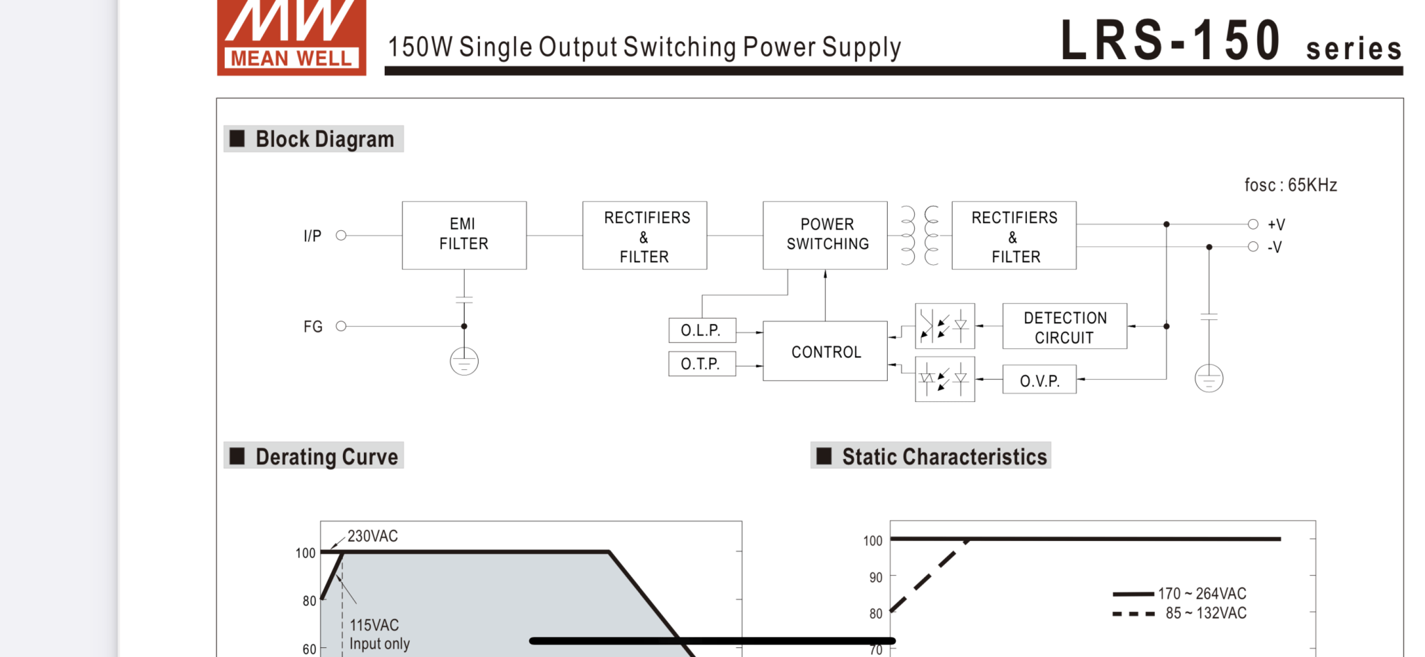

The only thing that I can think of regarding the SMPS is that it is in series with the bias supply. That way I could use a low voltage bias supply. Without the V- supply in series with the bias supply, the bias supply voltage would need to be the sum of V- and Vgs, so in the neighbourhood of -50V maximum to be on the safe side.
I found a Meanwell manual that does mention supplies in series. See page 84 where it mentions that series supplies should have a diode connected to the SMPS output. So try attaching an 1N4002 to the SMPS output (cathode to V+).
I read the article. Sadly, it didn't work.So try attaching an 1N4002 to the SMPS output (cathode to V+).
