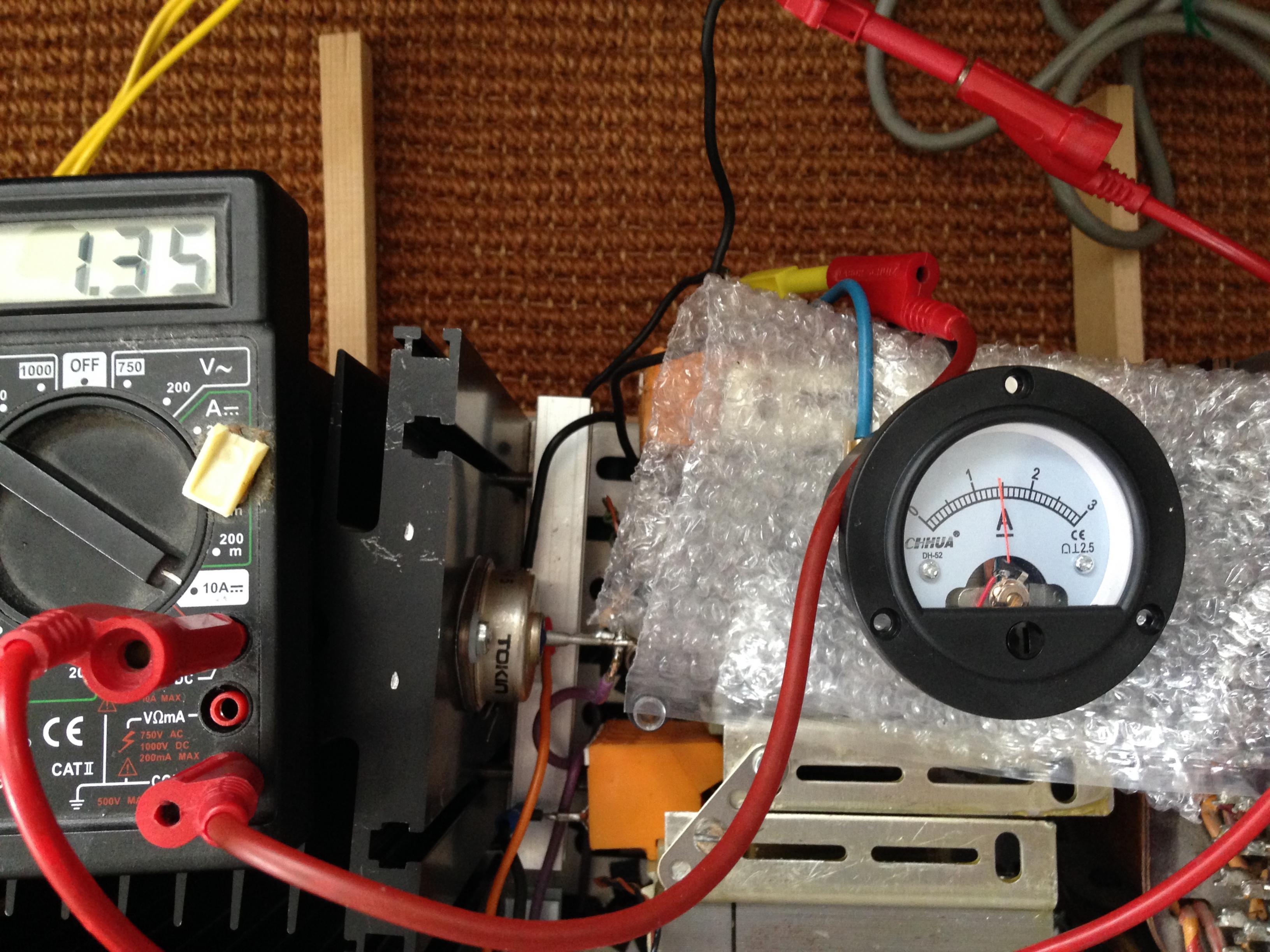

triode_al, I have a question about the meters i- mine they are FAR FROM accurate, not usable at all...
I bought DC-ampere meters.
Might it be that you bought AC-ammeters? That will not work in the DC line, probably only in the output, being AC there . . and not accurate for the power;

- Your question makes me a bit unzen, I expected the meter is just a shunt resistance which is flat i.e. not very inductive and hence have no impact, because its value is swamped by the big 'power line' choke I have. But seeing I have 1 mm thick drain wires & 2mm source-earth wires I use - it can count.

proper way is to use that sort of meter as regular mV meter - either having proper "shuntless" one, or get rid of internal shunt if there is any
then tap to appropriate points in circuit and take fraction of available voltage to route to meter

I see, I'll check the shunt value
I like the comforting analog indication it gives. Should have a little real bulb behind it. It gives me piece of mind.
Anyway I am thinking to go to an CrC anyway, the R being 0,1 ohm. But I can't open the meter up, I'm afraid it will self-destroy.

I bought DC-ampere meters. Might it be that you bought AC-ammeters?
no no, mine is DC ammeters. I double checked mine, and I find they look different from yours. I bought mine for less than $5 each... Cheap meters. Thank you anyway.
you really don't know better than to put meter inline with circuit?
I bought tiny LCD digital voltmeters and 0.1% resistors instead. I only turn on the voltmeters when I need to see them. Is this a good idea?
I have no objection
same as I'm not having nothing against use of in-line Ameters in CRC filter .... thougg, care needed in powering On sequence, to avoid needle bang
