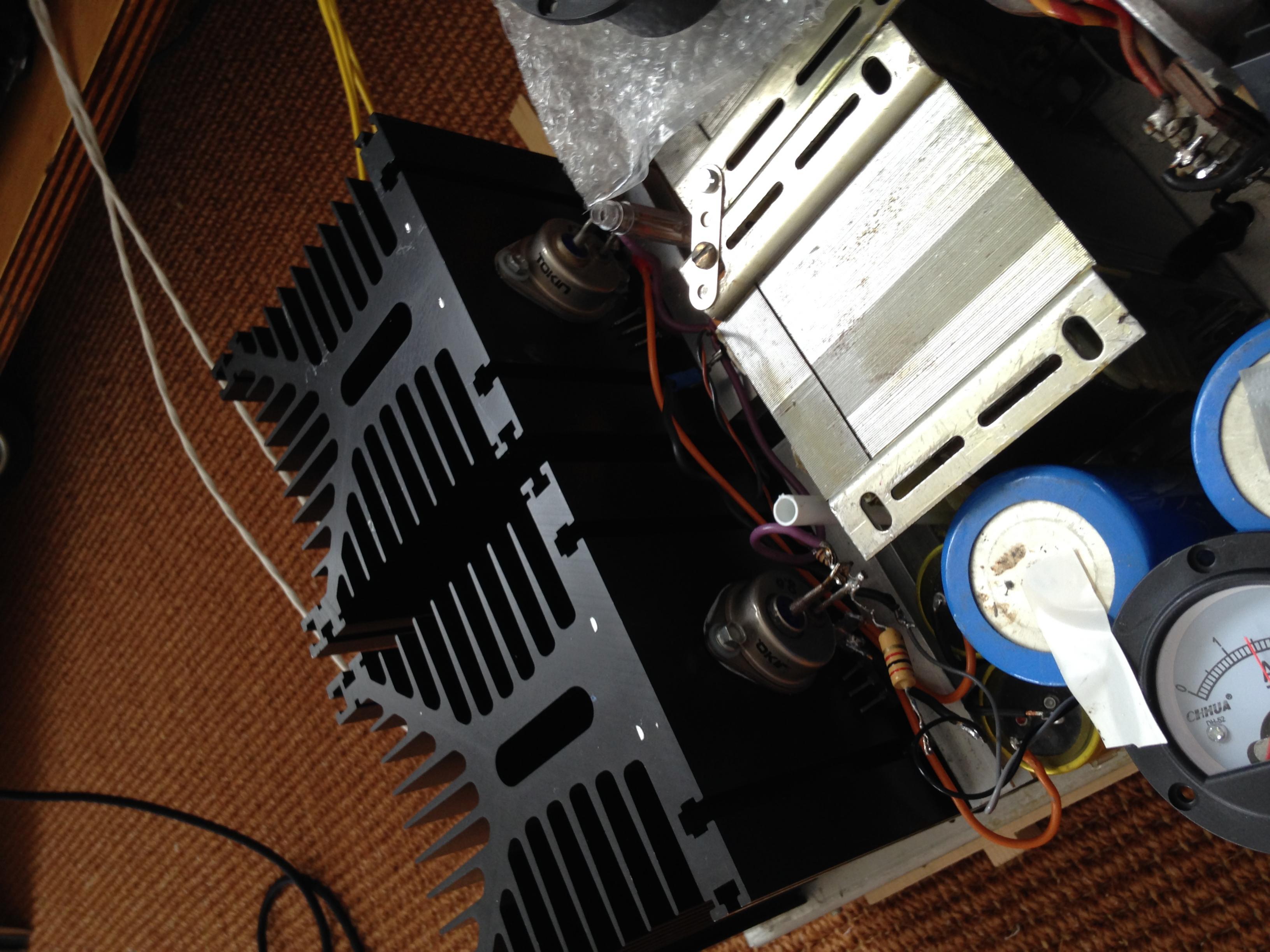

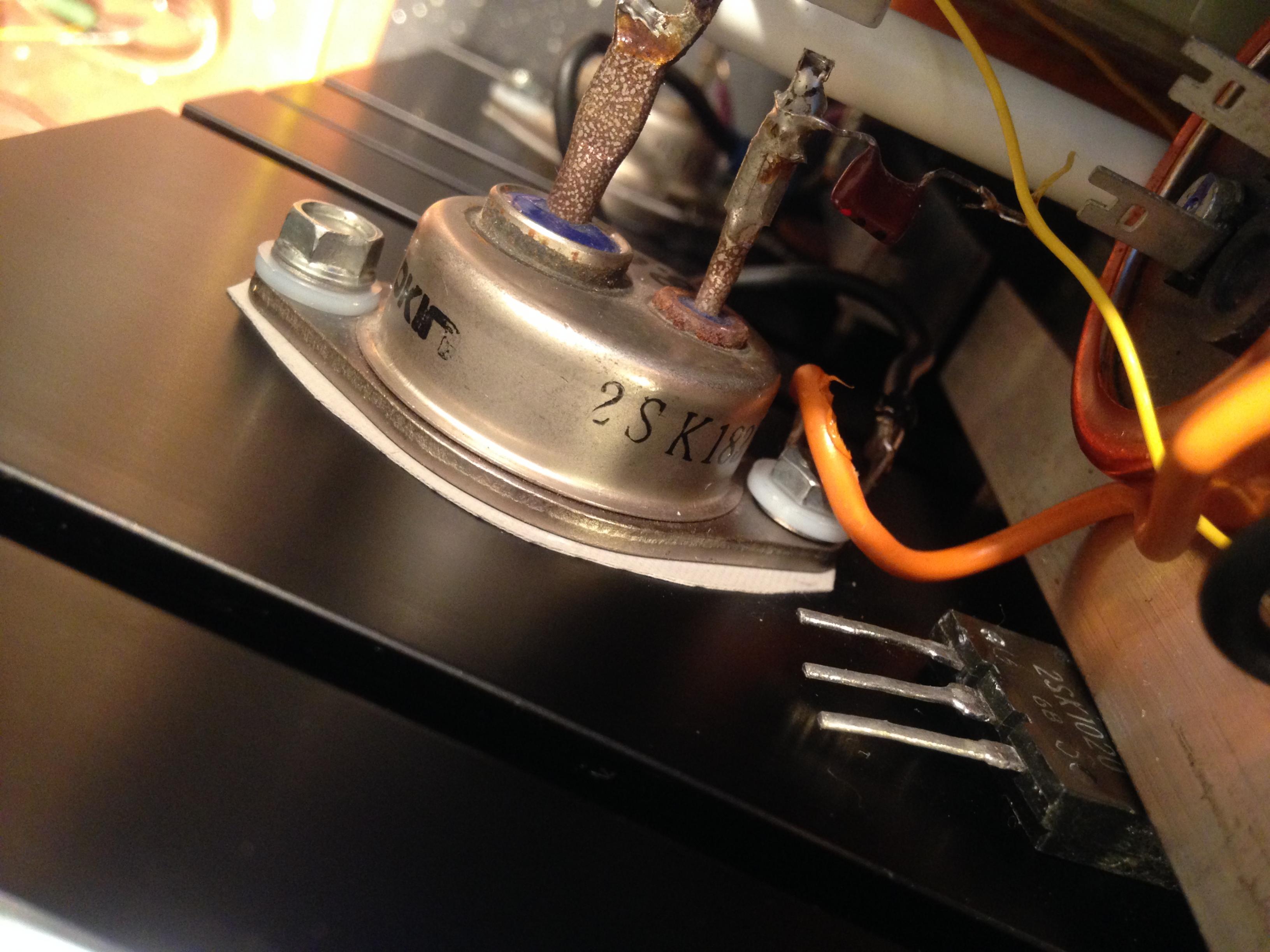

It is worth checking that the insulating shoulder washers (Nylon bushings ?) are actually a little bit shorter than the thickness of the Tokin flange, so that you can apply proper pressure on Tokin towards heatsink.
I did cut a bit off my insulating washers to have them shorter than the flange ...
Regards, Claas
Official Court Jester
Joined 2003
yup, logical and normal procedure
one without wire eyelet - put it in hole, cut protrusion with xacto
other with wire eyelet - place it together with eyelet in hole, cut protrusion with xacto
don't mix them later
if torquing with proper force (say 1.5Nm is OK for M4 taking in account all sorts of thermal pads), there is no much squish force, if plastic bushing is too long
Great remarks; I did cut it off a bit (but not in ZM's smart way); but what I did, is drill (dia 5mm) in the tapped hole a mm or so in order that the whasher ring would protude in the sink. I do see the problem of it squeezing out and prohibiting a good contact. This just to prevent any metal to touch base.
[test with a glass plate . . . ]
Took the whole apart, now use mica's. Indeed, the rings was protruding slightly (but I had resesses), but worse, the sheet of heatsink stuff was folded at the screwmount on one transistor . .
  • So previously I had gate current already starting at 50 mA DC; even with a secondary coil of a 2k4 transformer. In the first mounting the fit of the case on the sink was bad; I filled the back down to even flatness on a whetting stone
  • I note yesterday the failing SIT now remains longer stable, I could turn it up to 800 mA.
  • This morning, I took the heatsink off the amplifier base. [To see if the case/sink capacitance was the culprit]. No, but turning slowly at 70 mA I could see the output (at 2x ampl); the instability was there too then. I could now touch the house (=drain) and the amplification would drop just like the current; I could also see the gate current changed a bit.
Left alone it creeps up. When turning the current beyond 1 amp all at once the case gets hot and there is thermal runaway. In 5 minutes there is 2 and even 3 amps. I have to turn the bias back quickly. After being turned off, it is stable again untill I hit that that 1 amp tipping point. Vb is 22 volts; Rchoke = 0,65 ohms. The choke is connected to a 30.000 capacitor.

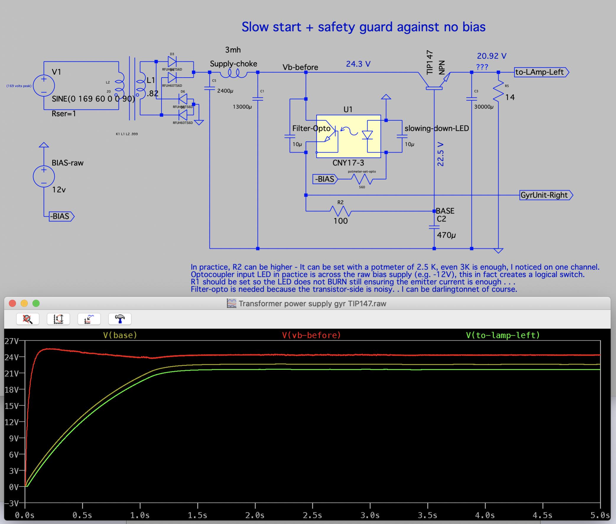

I wanted to share my thiughts about a minimalistic power supply for the L'Amp.
It has a safety net in the form of the optocoupler. (4N35 is OK)
It only allows passing of current to the drain of the SIT IF the bias voltage is there.
This precaution is important, as having drain voltage before bias will melt a SIT; I am afraid. Anyway, maybe not th real reason for the death of SITs on the test bench, but such a logical error state is avoided now.​
Slow start; without the opto, the unit fires up in 0,5 sec.
Both channels have their own cap-multiplier/that is, a TIP147.
There is no difference I see between TIP122 and TIP147, the latter is more sturdy.​
In practice, the pass transistor does not heat up; I bolted it to the cabinet.
I have not made the opto-part yet; the rest is fully working and in practice 2 to 3K for the base is enough (I used a potmeter to set it; both TIP147 transistors Left and Right differ in the current amplification factor).

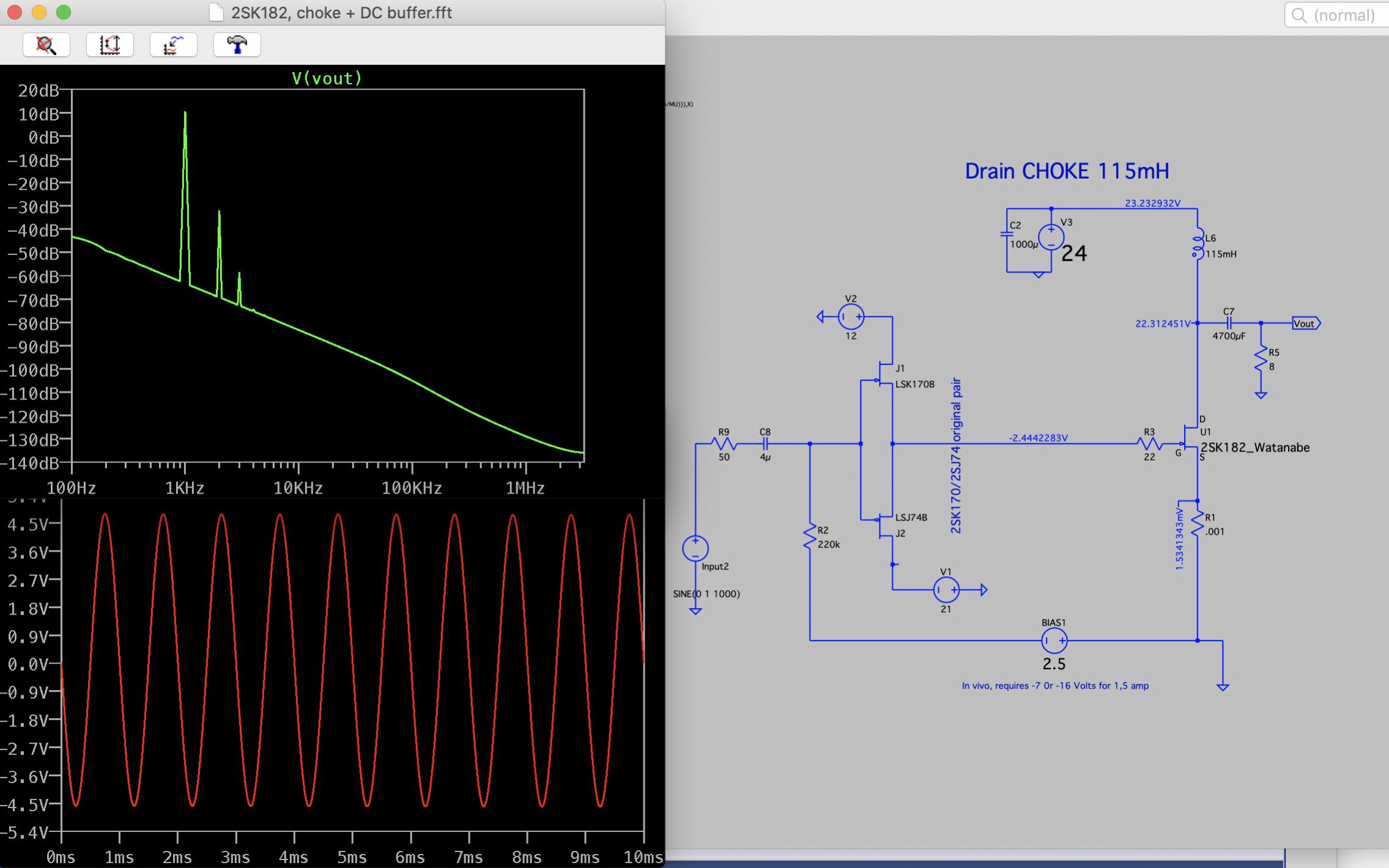

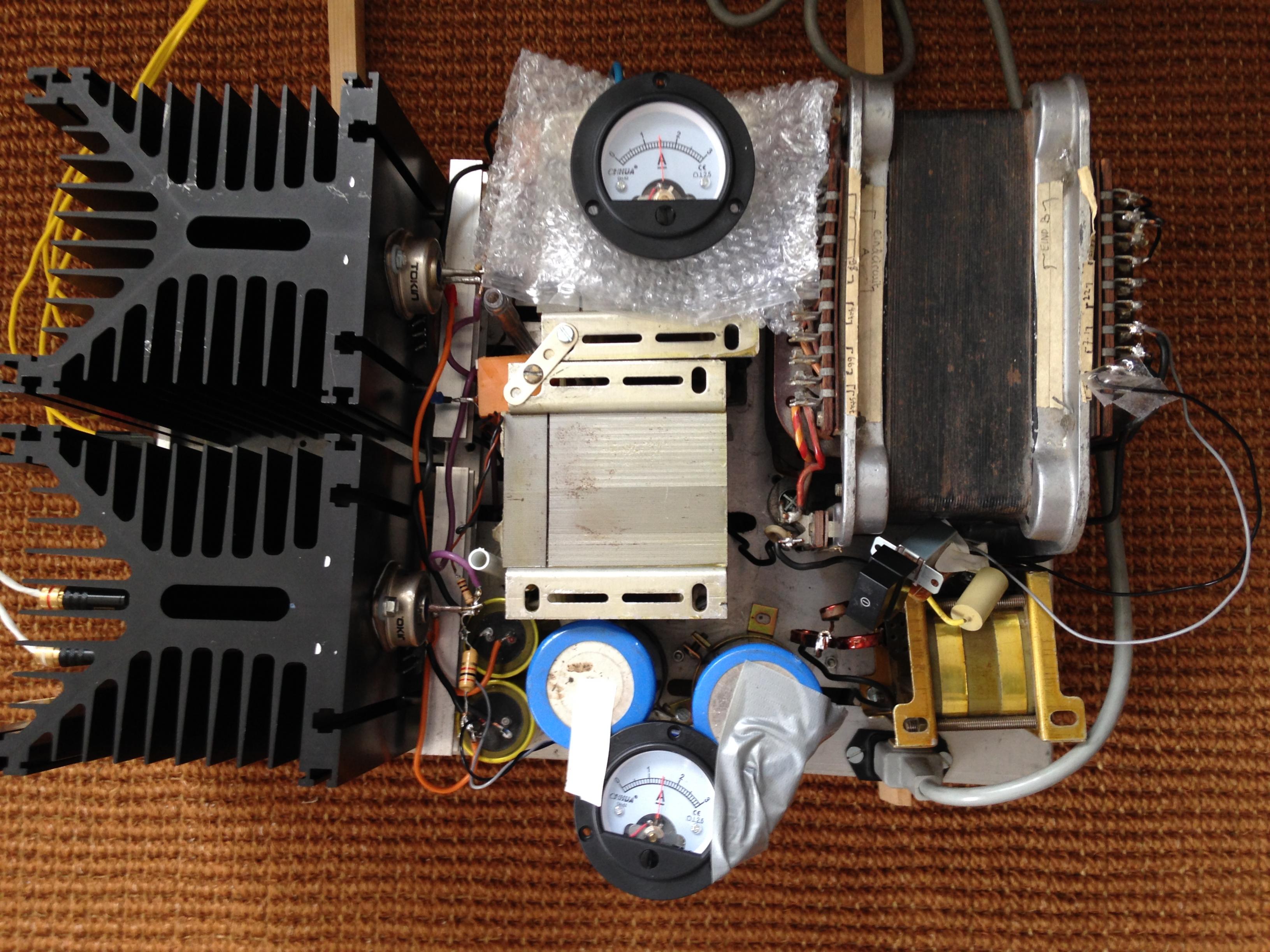

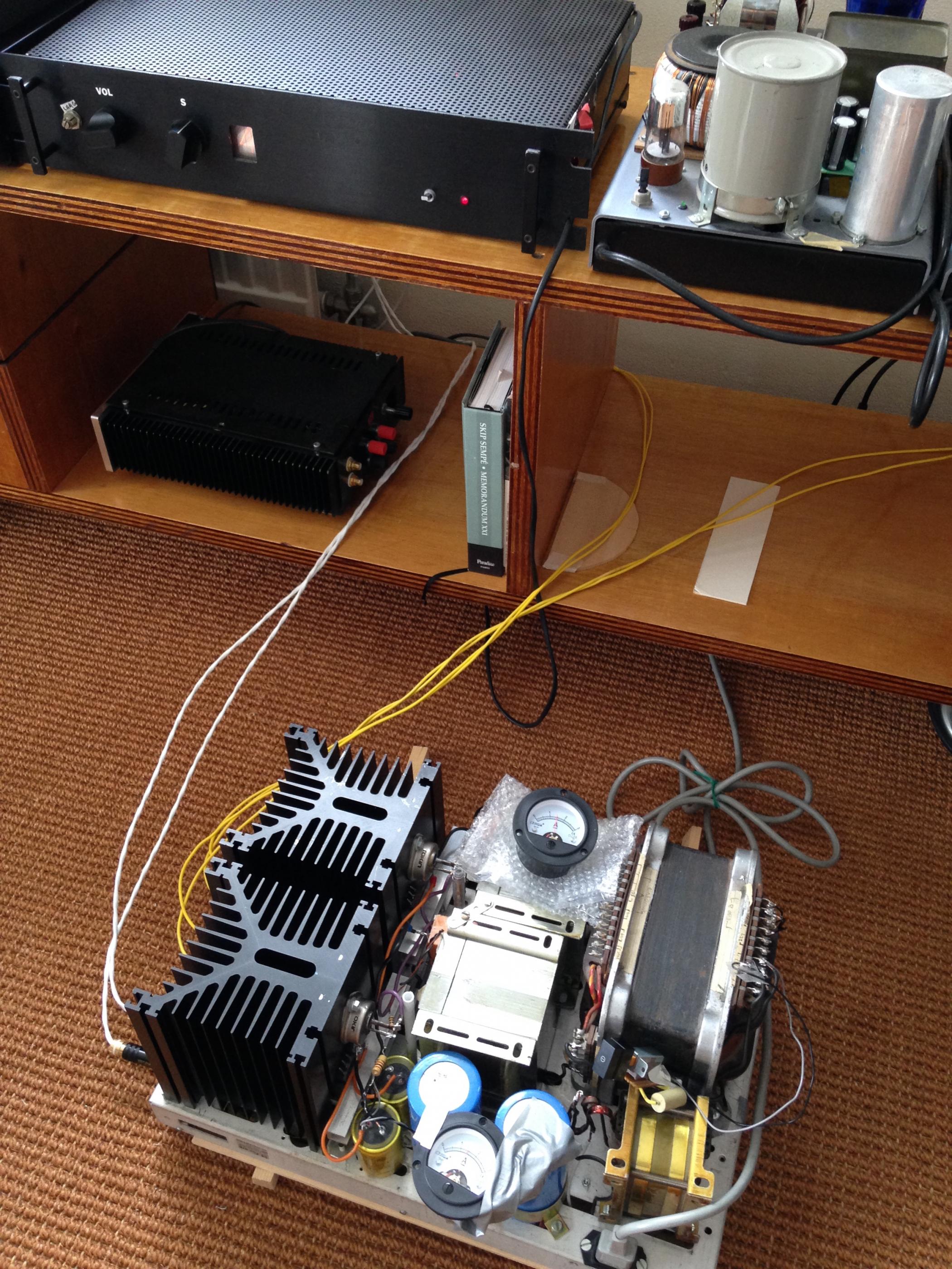

Firstly, because one SIT is leaky, I went for DC coupling. The 2SK170/2SJ74 buffer is biased to the potmeter, 220k and 150nF. This works well.
I had to reduce the V+ to balance the power supply of the buffer a bit.
Current is stable both channels with the DC buffer, over several hours as the heatsink heats up to ~45 degrees [25-23V/1.2-1,5 amp]
My earlier initiative with an emitter follower 2SA1015 I used with a CCS @ 5 mA was stable, was not good enough: slow rise time, slow fall time. [I know, charging an 8nF gate charge is not a simple thing]​
Channel balance 0,5 Db - I can't hear that.
My choke is 0,5 ohm Rdc. BIG BIG thing in the middle.
Sweep goes 7 Hz to 68 KHz. Rising edges without any sign of oscillation.
