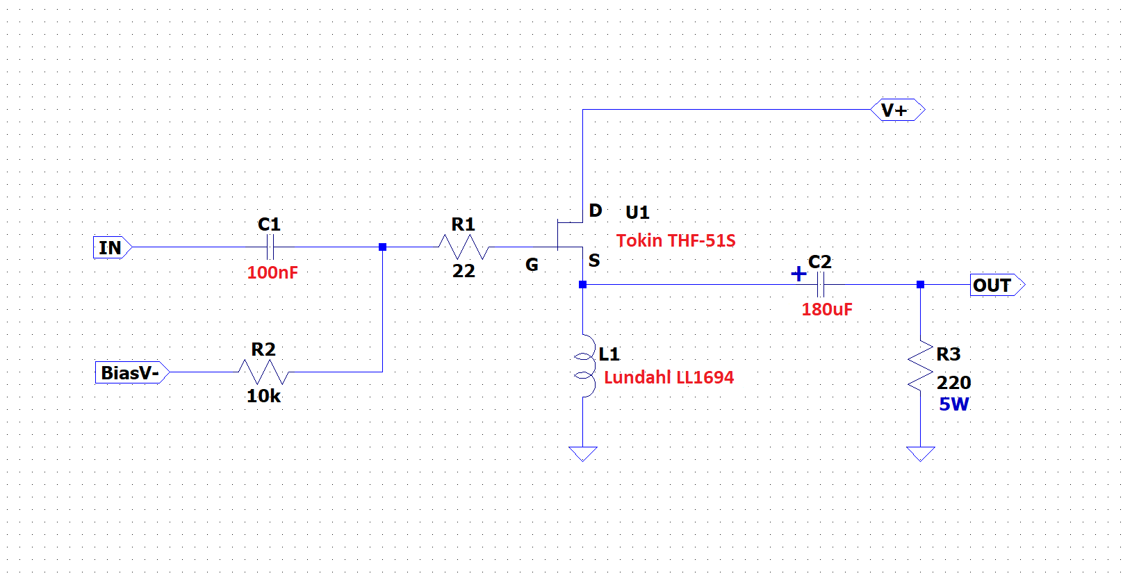

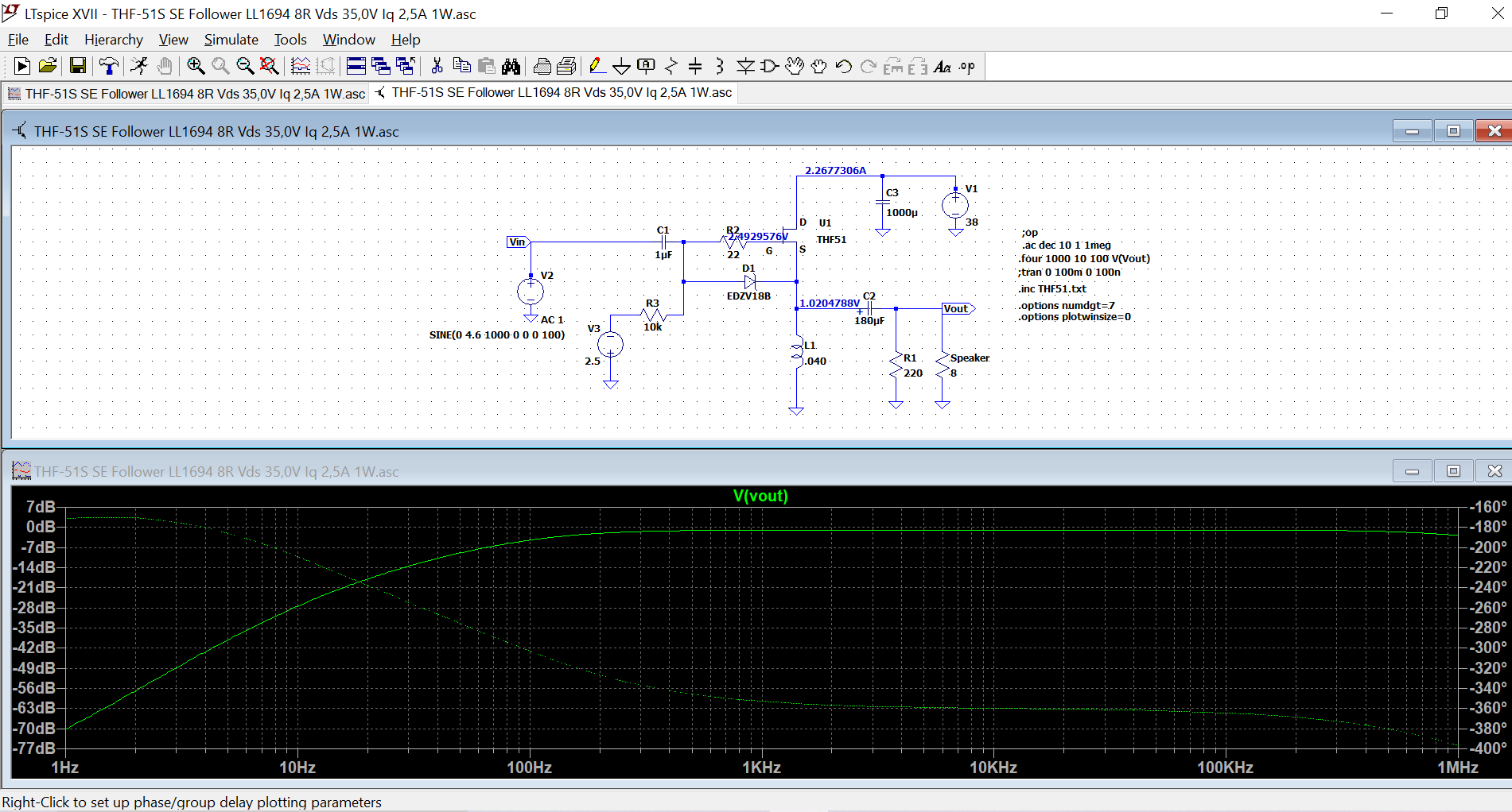

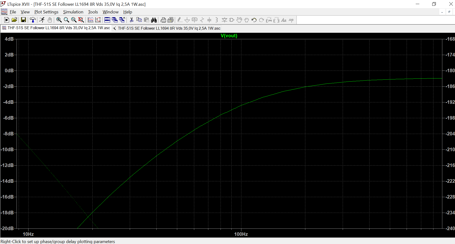

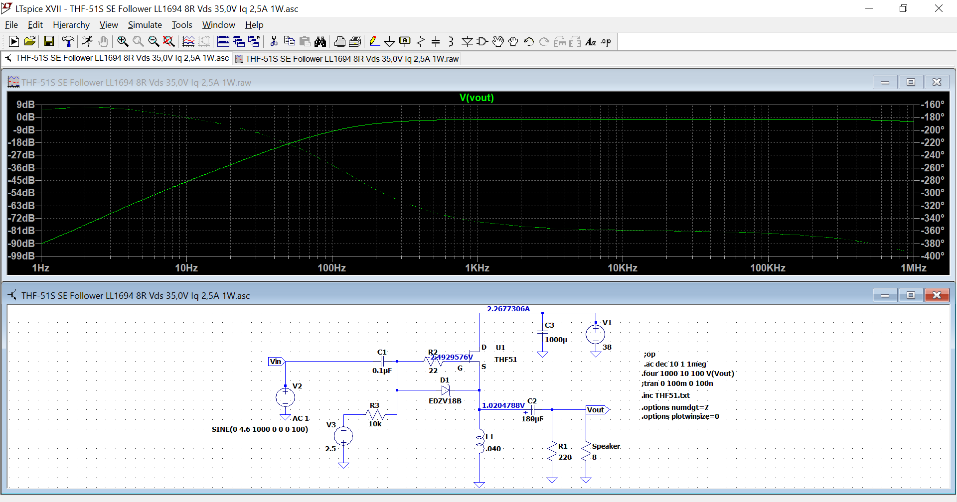

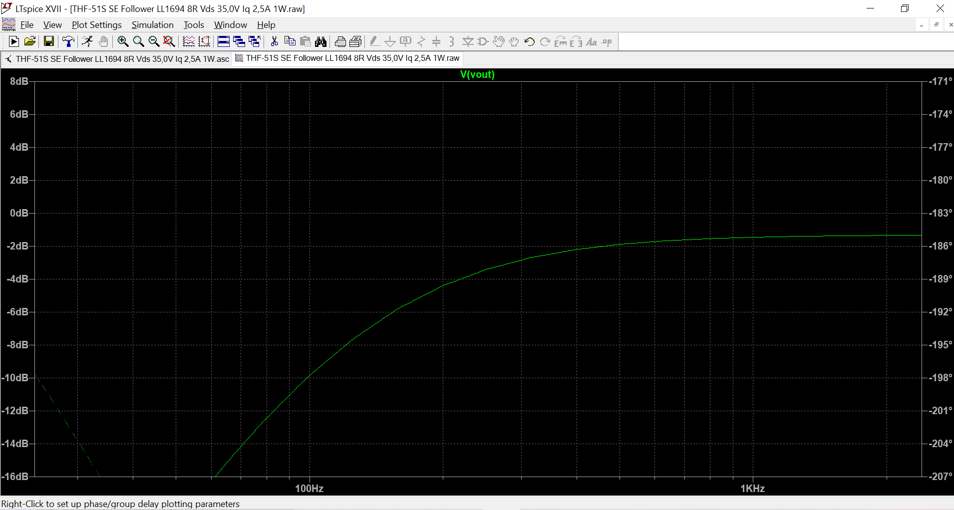

Just to remind, my build will be bandwidth limited, rolling off below around 150-180Hz as it will be driving the 'full-range' section of a Pass Open Baffle (I have a chip amp to provide the bass). Below is the circuit I'm working on (note the film cap on the output, made possible by the bottom end rolloff, which, with the speaker load, creates a LP filter with a -3dB point at about 114Hz). This is the cap I'm looking to use on the output:

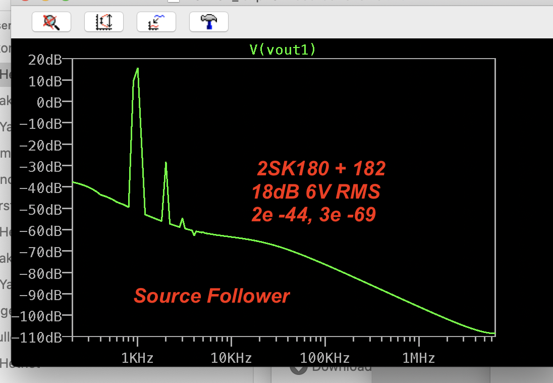

At 24V = -38dB @2.2A; and at 40V = -46dB @ 2.4amp. (my reliable source, LT Spice.., 2SK182)

Fwiw, the measured distortion on my THF51 amps is much lower than what the SK180 model i use predicts.
And apart from reducing distortion raising current leads to a lower output impedance, a decisive parameter for my speakers.
I'm not trusting much in sim with THF51 model, for THF51 amp, let alone 2SK180 model - for THF51 amp ....... speaking of THD levels
. . not very trustworthy maybe, but it does allow a design decision here and there.

What is very interesting on paper, is that the 2SK180 and 2SK182 models are so different that in a choked lamp, the K180 has many more harmonics , say 2-7, nicely degraded; while the K182 shows only 2-3 or maybe a tad of 4th.
The degradation is interesting, the level not, indeed, like you say. The level changes at a whim on paper. Just change the parameters a bit.
