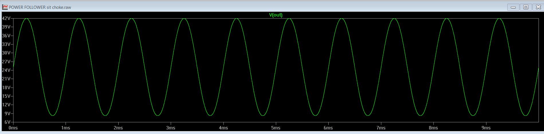

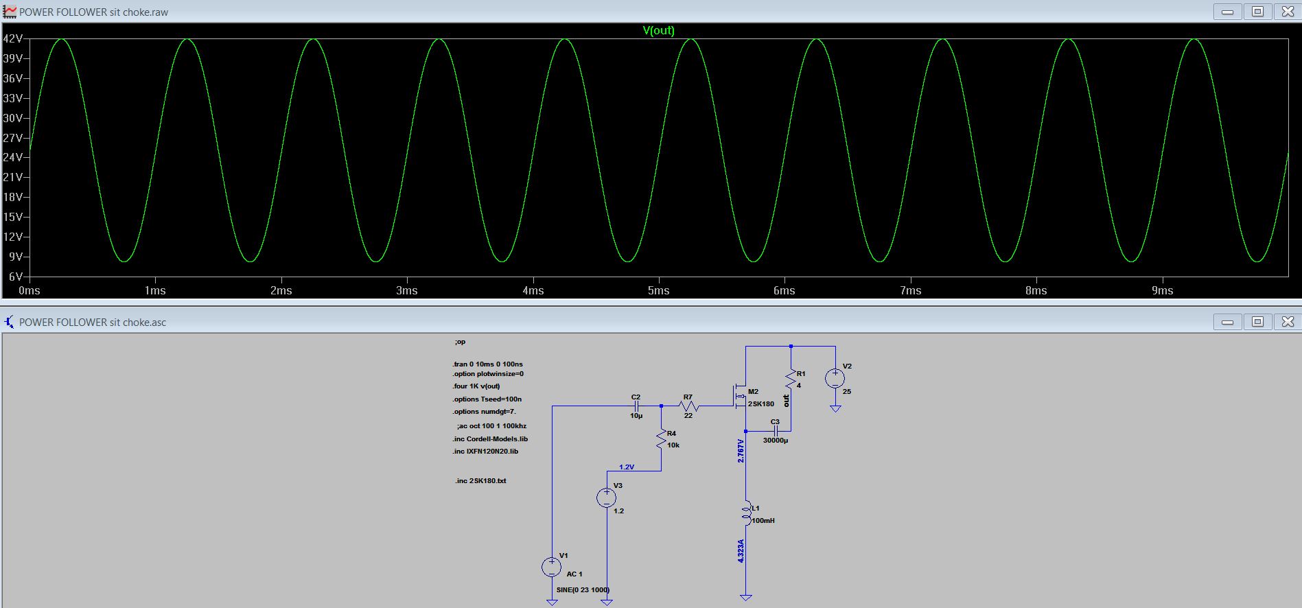

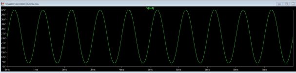

34v p-p with a 25v supply. 35W in 4ohms @ 1.33% thd. For some reason the model i use indicates a much higher distortion than an actual THS51 on the bench but to be honest i have not measured this particular setup, due to the lack of a 5A capable choke.

The two speaker returns produce identical results in the simulator if the PS has zero impedance and no ripple. As it usually does. In a physical implementation there are differences.

I don't think I would connect the output of the circuit to speakers as it appears to have a 25VDC offset. Or is that a simulation issue and does not happen in real life?

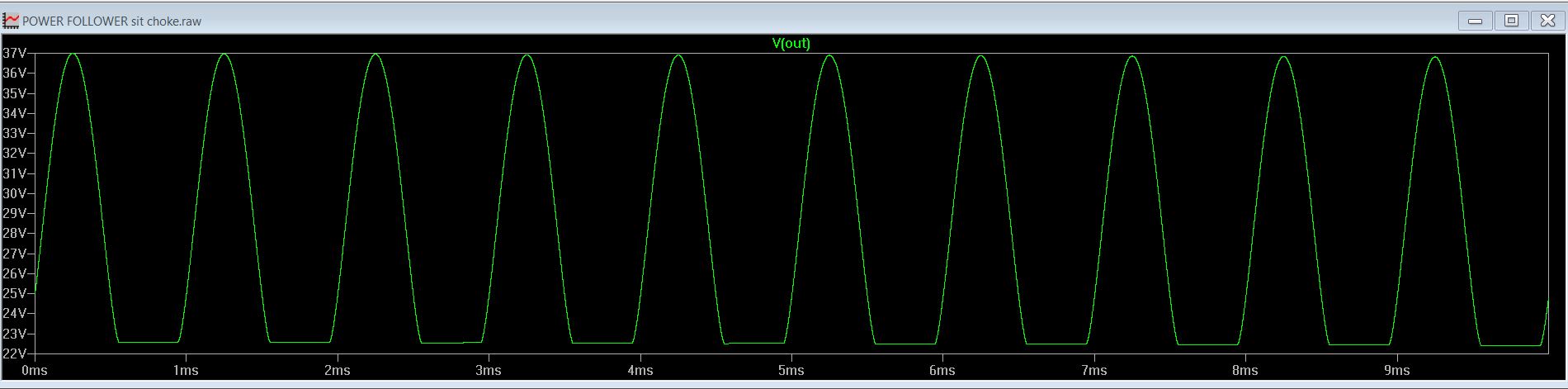

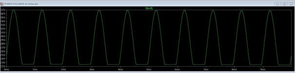

The high THD that your simulation showed was due to clipping. I copied your model and simulated it and the output waveform showed a flattened bottom when zoomed in.
I also did some runs at lesser input/output voltages and although the waveform was not chopped off, the waveform was asymmetrical with the bottom compressed. The distortion profiles also showed large amounts of higher order harmonics, a sign of asymmetric non-sinusoidal output. As far as I can tell, the asymmetry started at peak to peak output voltage greater than 25V, but I may be wrong.
My simulations of the same circuit with the speaker return to ground gave the same peak to peak output voltages, except with so DC offset. So the AC output waveform was the same, as expected.

The LTSpice output is relative to ground, but the speaker sees the 25V at both terminals so there is no DC current or DC voltage drop at the speaker.

Some bits are easy. Add ripple to the ps and observe the amount of ripple passed to the speaker.
Perhaps, but so what? You get extra headroom with a little more distortion. It's for free 🙂

Under ideal conditions an inductive load can double the available voltage span of a stage.
But components are not ideal in real life. So the practical acceptable output signal voltage is somewhere in between, depending on the inductor, the Iq, and also on the listener's tolerance of distortion.

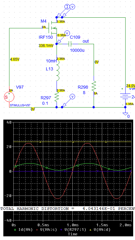

22.8V peak, 45.24V peak to peak, on 24V supply, 0.4% THD, mostly top-clipping.

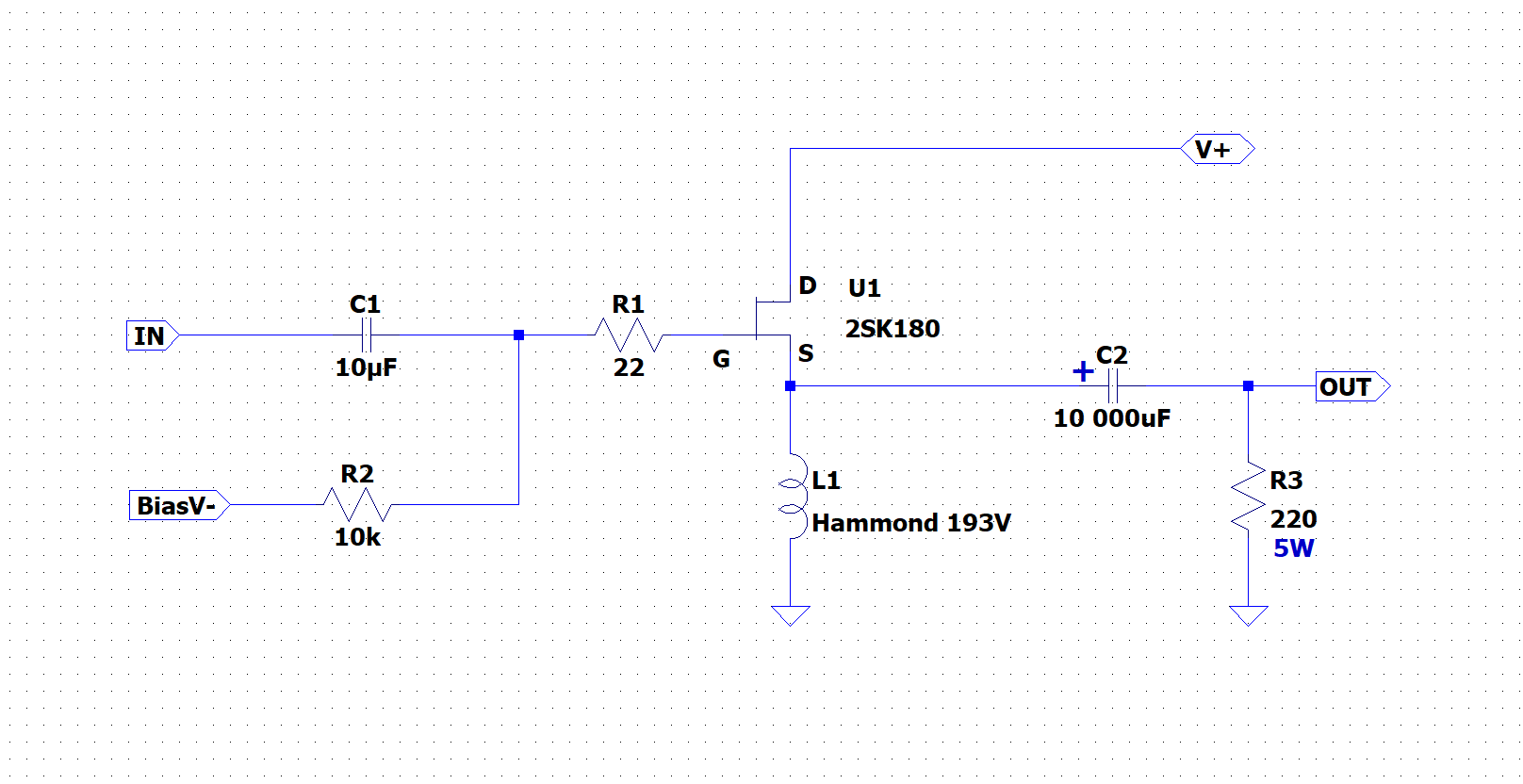

Can I just confirm that the Tokin TH-51S is a straight drop in for the 2SK180 in this schematic from post #109? Would just like to understand my options.
I appreciate I may need to tweak the operating points.
yes
all are depletion* devices, similar power, similar transfer characteristic
*if you are familiar with triodes- same nature as them, regarding biasing - normally fully open, you need to apply negative voltage at gate/grid (ref. to source/cathode) to decrease and control their conductivity/internal impedance
