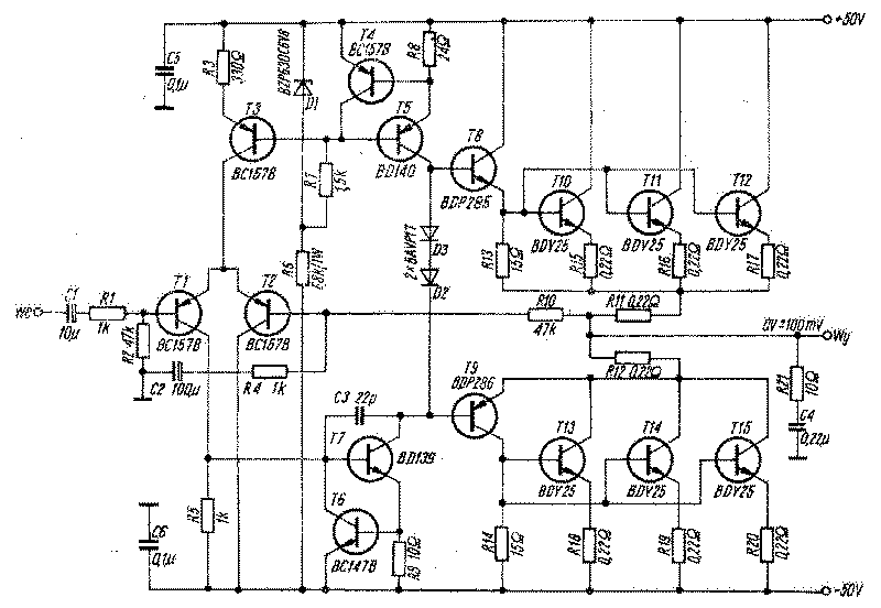

Hmm... Hmm... Hmm.... Hmm.... So.... What sort of total power output amp could I make?? Hmm... I have no money, but have speakers.. and no amp.... Well... 4 transformers will cost me $100 and thats 1000VA, right??? which should give me 600watts of output to the speakers??? 60% efficient?? atleast? Thats 6 X 100watts into 8ohms....??
Whats this do?? lol
Whats this do?? lol
Hey,
Great design especially for its simplicity!!!! My question.... What are the extra .22Ohm resistors doing there before the main output besides blowing up? No, for real, what are they for?

are you askin me?? lol
http://web.tiscali.it/audiofanatic3/Tipo/Stato_solido/pic_finaliSS/150W_BDY25.jpg
is where it came from... its linked to on the diyaudio links page. . lol
Diode said:Hey,
Chris
Setting bias. The output stage is quasi-complementary 😱
It is Verboten for me to access that site from this server.
No I wasn't asking you specifically.... I was being serious AND sarcastic. There's no way that those 2 .22 ohm resistors could take the output of a high power amp and survive. At least I can't fathom that..... You mentioned that you had spent $100 on transformers and were considering buying more? If I'm wrong, I'm sorry but use the next $100 for transistors and perf board!!! 😉 I'm looking at building a 500W amp and I don't think that all of the transistors will cost $100 and there's 7 per rail plus the others!!! I understand cheap and simple real well. That's my motivation behind the amp I want to build. I'd consider Anthony Holton's amp but FET's are a real pain for me to get at a reasonable price without huge quantity. Too much money for me.😡 Dude, Good luck with your endevour. You can check out my thread "500W amp" and look at what I'm trying! Look at Blackwidowaudio.com I think that's the site or do a search on Google.com for blackwidow audio. He ahs a 60W circuit that is simple and easy AND probably could be tweaked for a bit more power. Just a thought.

"There's no way that those 2 .22 ohm resistors could take the output of a high power amp and survive. "
A sine wave is off 50% of the time. If we use a 10W part it will handle 14.14W on half-cycles, 14.14/.22=64.27(I^2), P=(I^2)R, 64.27 * 4R = 257W
On normal program material it will probably handle twice this amount, or 500W
Hmm... lol 🙂 So... its correct then.. lol should I make the circuit I posted, or the one from Rod Elliots site?? hmm...
