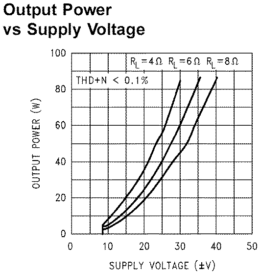

Okay, I thought about this... I think an transistor or mosfet amplifier would be better, with 2 transformers per rail, that is +-50volts.... The reason being is that I wanted an amplifier that was stable into 4ohms as well as 8.... Using a single pair of LM3886s didn't give me that, and using 4 bridged/paralled was getting rather messy and expensive.... So, now I have 4 transformers weighing 4KGs each, a total of 16 kilograms just on transformers... and, I have to order these from interstate.. and hope they still have some... and hope dad is willing to lend me the money... hmm.. I still owe him some from the speaker I bought.... NO!!!! Okay, what applifier should I use?? I was originally going to bi-amp my Peerless tweeters/woofers, but have now decided to invest in a good quality crossover, rather than another amplifer.... So, if I have four 18volt 250VA transformers, Whats the max size amp I can run off of them?? I really don't get this.. lol.... hmm... lol
Will this really give me 300watts?? Into what? 4ohms?? If I use +-50volt rails, will 2 X 18volt 250VA transformers connected in series per rail provide enough current to run 2 of these amplfiiers?? hmm... I really gotta learn what I am going... lol Wait, I was considering a 4 channel 100watt per channel into 8ohm amp... that would give 2 X 300watts into 8ohms or 4 X 150watts into 4ohms... is this possible?? HMM!!! BAHH!!! I look, but c an't find... lol
Before going bonkers let us look at some numbers.
If you wire four transformers in series you will have 36-0-36V at about 1KVA.
Rectified and filtered this will give about ±50V no load.
The Adcom GFA535 runs on ±52V and is rated at 60W at 8 ohms.
The Hafler DH120 runs on ±52V and is rated at 60W at 8 ohms.
The NS chip is rated at 68W/4R, which is 23.32V peak. At this current output this chip needs about 5V above this, or about ±28V, REGULATED.
If you run a high voltage tier at ±57V for the voltage gain stages you will be able to get four channels at 100W/8R, and 150W/4R, or two channels at 300W/8R bridged.
You can add the extra turns for the high voltage tier to one of your transformers, two added windings of five or six turns will be all you need. Any 20ga~24ga insulated wire will do.
You will need 20,000µF~30,000µF at 63V for each rail. Apexjr has 12,000µF at 80V caps for $4.95 each, you would need four of these.
