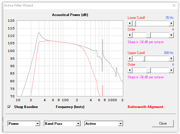

Honestly I don't believe this is working this well either, and not having problems with, SPL, distortion or mechanical throw.
Case in point, we watched Magnificent Seven the other day (DTS) and when the army of mercenaries rode in the room was shaking. The bass is remarkably quick and tight.
Group Delay; I guess that is worth investigating, although the crossover is set to 60hz. I would be interested in experimenting with a sealed box, maybe a 10" Creative Sound woofer (whatever size box they recommend).

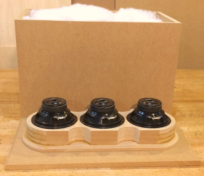

Update on the 6 woofer 6,000 cubic inch box; almost completed and keeping my fingers crossed!!

The cause of high Group Delay in BR is due to the behavior of the port near its resonance. Above this range, group delay is the same as a typical seal box.
The preliminary impression is good, digs deep, sound natural. btw, I did toss in a big ball of light fill.

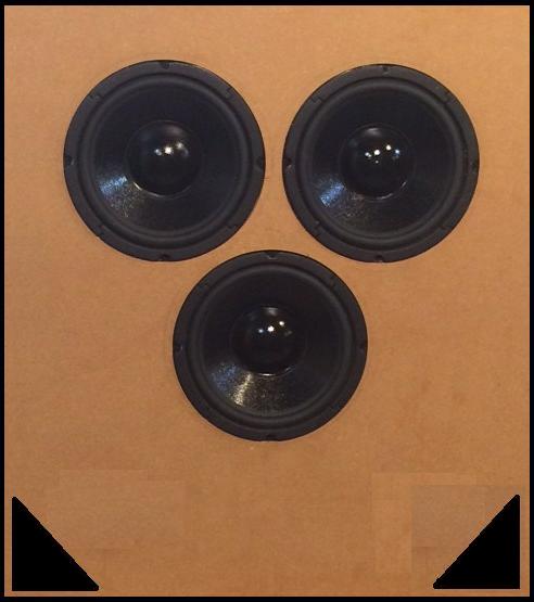

Now just thinking about a small modification for a re-design.
Small triangles in the lower corners would work well - yes?
They could be equivalent to 3" round, that would save a little size/weight?

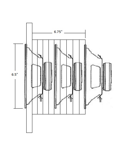

Triple Speaker Tunnel?
New Name for above: "The V6" 😀

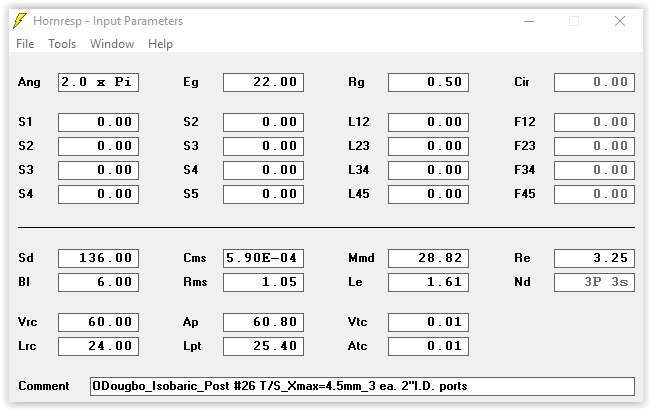

This mini woofer seem to work well in Iso configuration, and have been pondering what is involved with a triple speaker tunnel.
The wood working would be easy enough with wood rings, gaskets, counter-sunk holes and extra long screws, but wouldn't know where to start with a box size, port, etc.
I don't know any box programs where 3 speakers "in-line" can be calculated, but maybe a few of the parameters can be changed and modeled as a single driver?
Any thoughts or recommendations?
Thanks!

Hmm, in HR's Driver Arrangement Tool one can apparently choose up to [9] in an Isobaric module. Seems kind of extreme, but if the drivers are cheap enough.......

Holy Cow...Thank you! I was running out of ideas and found couldn't find any examples of a triple tunnel on google search images.
Also thanks for the sealed box suggestion and curious why WinIsd defaulted to vented when the qts is over .45.
6 drivers seems to hit the mark and the impedance ends up at 5ohm: 3 in series, than parallel connected. Using one SA1000 amp, btw.
Three 4' x 8's sheets on standby and plenty of the mini speakers, where to start....

Howbout one iso pair in a sealed .73 ft^3 box?
Still have the first box box from OP, easy to run it back through the saw to make it smaller, remove port and seal it up.

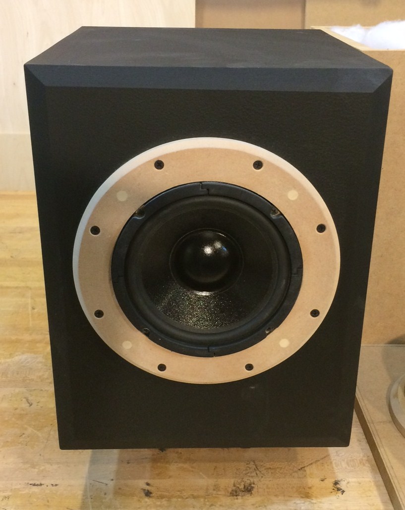

Ok should have started this project here:
Sealed or Ported Speaker Box Enclosure Calculator
The calculator recommended either, so went ahead an trimmed up the single Iso box by cutting the vent off. Next found a 12" x 12" x 9" cardboard box and filled it with shipping peanuts, then transferred the .75cf of peanuts around the speaker/tunnel and proceeded with cutting/modification.
Stuffed it with fill and tested it.
Again, the mini woofers really pour out some nice clear bass and plenty of thunder. I kept turning it up, although eventually the rear speaker dust cap hit the back of the front speaker (no damage).
Worth pursuing a multi speaker sealed box, 3 or 4 pairs of iso woofers.
Although, I may need more shipping peanuts for a 3.0 cubic foot box 😱

One last hurrah, 6 woofers in a 2.64ft3 sealed box.
Although attaching front baffle last with screws so it can be replaced with woofers bolted face-to-face/clam shell.
FYI, the front woofers can simply be tuned around on all the boxes (empty 3" tunnel).
Total SD? thinking 6 - 6.5" woofers at 33 cubic inches equals 198CI which is approximately a 15" woofer.
Edit: adding pic of the box from the OP with mods.

Dougie,
Not cubic inches, square inches. Of the surface area of 6 woofers, only the three outer woofers figured in when used isobaric, so divide by 2.
Don't build the triple stack, waste of time. 🙂

Oh thanks for clearing that up, approx. 100 square inches then.
Not using the stop-light looking manifold either, saving it for another day. However, want finish the sealed box with 6 woofers bolted clam-shell, the front baffle will be bolted on also.

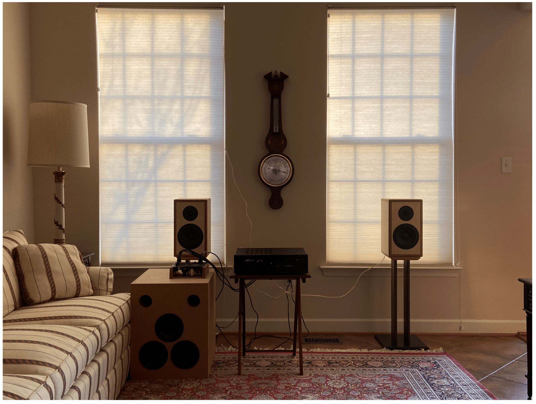

It's a monster! Never did set it up until today, it sat in the shop on a dolly for 4 years. I wanted to check out a 80's receiver that has a in/out bridge on the back; I just replaced the bridge with RCAs to a small plate sub amp. The receiver also has a subsonic filter, which is on.The Beast!
Tuning is a little low, 25ish, maybe the woofers will loosen up over time.
Getting plenty of low-end extension and sounds like live music.
