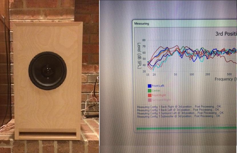

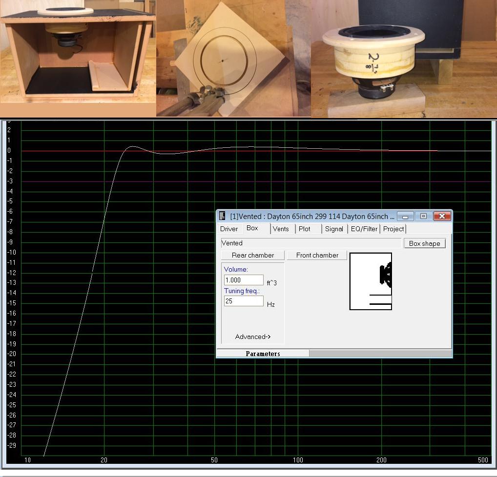

I wanted to try an Isobaric with a removable cylindrical container and made a "one piece motor" by gluing 3/4" x 3/4" rings together. The setup was way better than previous attempts.
1. cut the inter circle first
2. use the waste/cutout to center the piece to the sliding table (2nd pic top).
3. glue together with spring clamps, etc.
Box size, 1 cubic foot with deductions for venting and cylindrical container calculated in.
The woofer is a Buyout from PE, very low cost but well made.
Simulated in WinIsd, clearly shows a response down to 25hz.

A few more finish steps to go, will be testing soon though.

Box with 1 cubic foot and low 25 Hz tuning has high group delay. Simulate 0.6 cubic foot volume with 27 Hz tuning - better group delay with about the same F3, but check if port length is feasible.
Thanks! I did sim .6 and the response looked odd on my screen, I'll reload the parameters and try again.

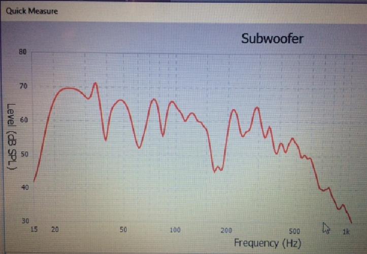

However, here's a room response with mic in middle of room using the 1cf box. I reset the processor to factory default, so there shouldn't be any eq. The box is located in corner of room, on 8" stand.
Sure enough, 25hz!! but again a 40hz dip; something about the room I guess :confused:
[same results as other projects]
btw, the port is 10"wide x 1/2" x 18-3/4" It was supposed to be 18" long but forgot about the deduct for the 3/4" baffle.

Ok ran a quick sim and could cut the existing box down to .8cf and keep the same 18" port, tuning would rise to 29hz.
...Pretty much a success although:
Are they tunned to low? 25hz now...
Poor group delay, maybe someone can chime in on that a bit more....edit...Ok ran a quick sim and could cut the existing box down to .8cf and keep the same 18" port, tuning would rise to 29hz.
Hi there O: Lower group delay is sensitive to the location of the big peak on the HR group delay curve. I have found, lowering the frequency of the peak by adjusting input parameters will push the knee at the bottom of the group delay curve to the left (lower hz), where you may be able to attain 10ms group delay for the lowest desired frequency. However, doing this tends to cause a decrease in low corner of the frequency curve, which I find not desirable. I have found that 17 to 18 hz tuning produces this effect in simm's ...regards, Michael

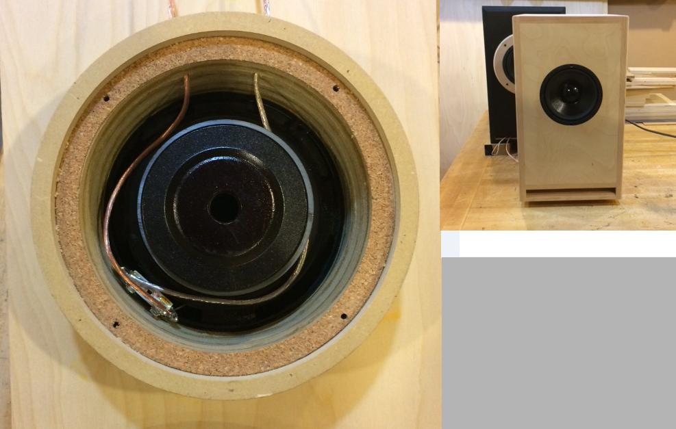

Another Version:
The port is slightly shorter and vent is 9/16" vs. 1/2" (first mdf speaker)
Wood - light weight maple ply with U brace at the woofer(s) center.
Red line is the response with mic in center of room - no eq except the high pass filter.
It's a little clearer sounding, and woks well with the new placement/location.

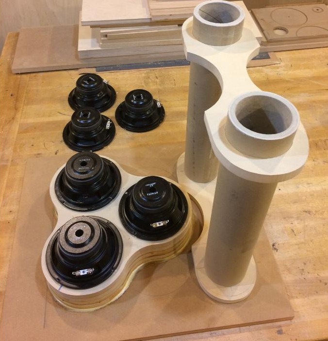

Made a second light weight plywood box, and and added it to the front three.
L (sub) C (sub) R
At first two subs didn't work as well as I thought it would, but was able to move the high pass filter lower a bit and sounds more like what I had in mind.
I'll check out the recommendation soon.
Pic: Four (4) 3/4" spacer rings and 3/4" front baffle. Rabbit cut(s) 3/8" front and back, which ends up back at 3" I.D. Add a extra 1/8" for the gaskets (cork, ordered from ebay)

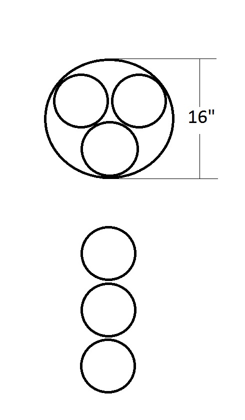

I still have 6 speakers not being used, thinking about a 2.5 - 3.0 cubic foot cube or similar sized tower.
[2 speakers each circle]
The question is what would be better, a "Y" or a Vertical Straight Line configuration?
Any thoughts?
Thanks!

Went with the speaker wheel. Made a 4 layer wood, 3 hole yoke, same ploy as before.
The 20" x 24" baffle is face down, all I need is a 5 sided 2.75 cubic foot box and some gaskets.
Thinking a removable front would be the best bet, could always cover it with formica to gussy it up (someday).
I really like the two iso boxes (stacked) that I'm using now, really nice solid bass, hopefully this will top them.
