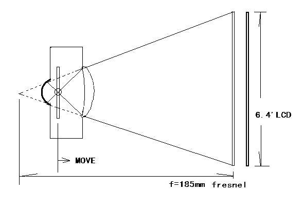

light source assembly
ywh said:·´¹âÍë $9 ¾Û¹â¾µ $9 µÆ¼Ü×Ó $14 µÆ½Å $8
Õâ¸ö ¹âÔ´×Ü³É ÔÉè¼ÆÊÇÓÃÓÚ6.4'LCDµÄ, ÒªÓÃÔÚ´óµÄLCD ÉÏÒª×öЩ¸Ä¶¯,ÈçͼËùÊ¿,°ÑµÆºÍ·´¹âÍëÒ»Æð¿¿½ü¾Û¹â¾µ.ÒÔÔö¼Ó³öÉä¹âµÄ½Ç¶È,ÕÕÉäÕû¸ö15'LCD.
translation:
reflector $9, condensor $9, frame $14, lamp holder $8.
The frame is designed for 6.4" LCDs. to use on a 15"LCD, the lamp and the reflector need to move toward condensor, so the angle of emiited light will be large enough to cover whole 15".
Can you move the reflector and light in the frame, from looking at the pictures looks like its fixed..
slodki said:Can you move the reflector and light in the frame, from looking at the pictures looks like its fixed..
no, i hve not move the reflector and light in the frame.
DO IT YOURSELF
you must breake some jointing and fit them with screw.
