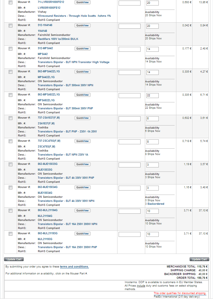

Thank you for posting. I'll take a look at the no-clip circuitry in a minute.
You said in post 127 that i should modify the schematic a little. What you meant was that C5 should become a C5a and a C5b each of 220pf tied in series. A 1k resistor should be tied with a leg in between the C5a and C5b and the other leg just before R47, right?
Also, about the prices, this is how my cart looks at Mouser. I added some devices just to have a spare in case i fry something.
