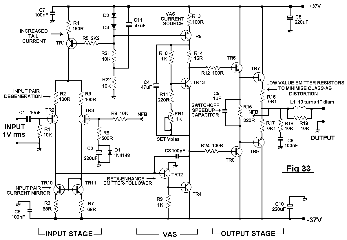

From Doug's own site, you can see the fig.33 below. To make it suitable for more power, just add more output BJTs with current sharing emitter Rs.

So this is the schematic for the Blameless amp? If so, what transistors are those? I can't even find his site. I mean I don't know which one it is.
