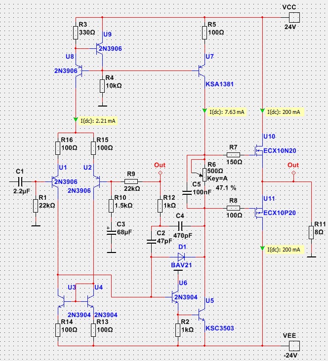

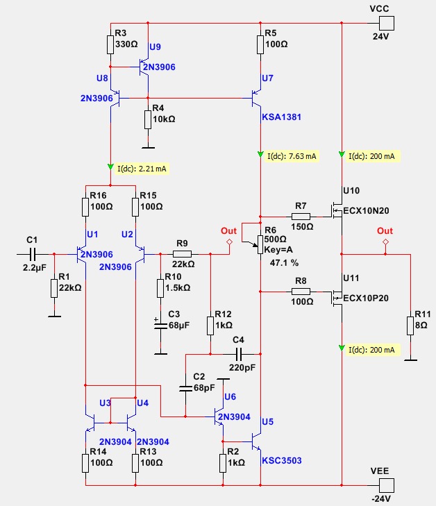

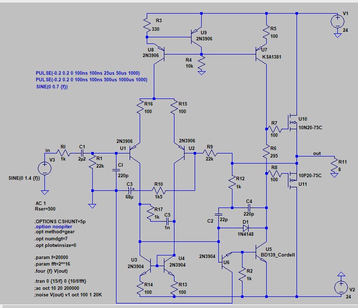

25 Watt Kinda Blameless with TMC, fast amplifier
I changed C2 from 22pF to 68pF.
Now the overshot should be gone.
Bandwidth is now like 1.5 MHz.
What can be done about the clipping behavior?

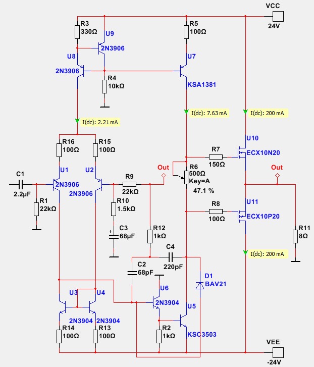

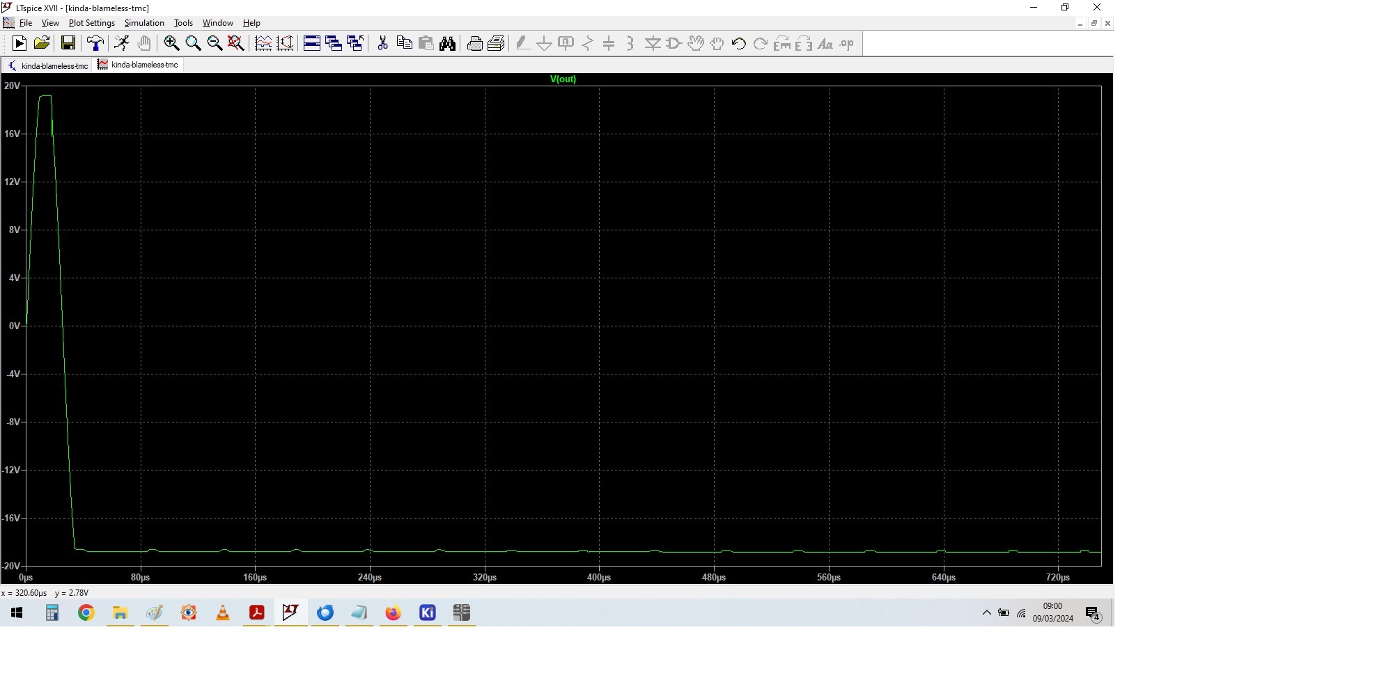

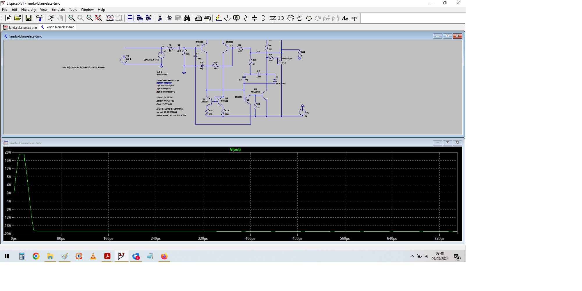

But there is also very bad clipping behavior in case of overload, e.g. with input sine 1.4 Vpp, see attached picture.
Seems the output went to constant voltage
What about this? This phenomenon seems extremely dangerous to me
Imagine a source with a high level and suddenly we get about -18V DC voltage at the amplifier output....
The speaker goes up in smoke....

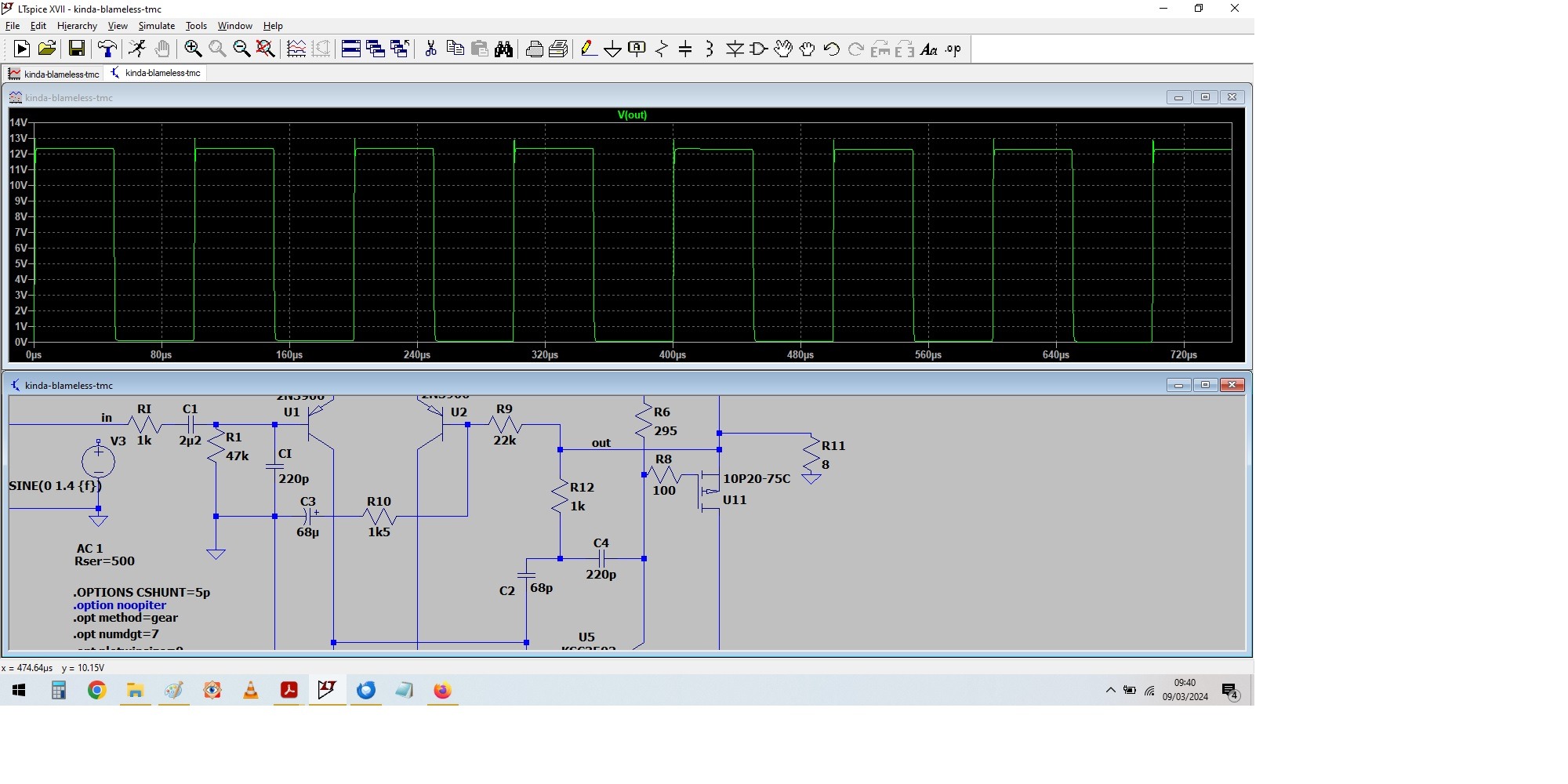

catd - thanx for sharing .asc file
Reactions: lineup
C2=68pF Square wave 20kHz....
To compare this correctly with the @lineup-circuit, you should disable RI, CI. (Then it gets worse).
To reach the same result as with RI,CI, but only by increasing C2,
C2 must be min. 100p.
This then increases THD by an order of magnitude,
while THD is decreased when using RI,CI.
I don't really know what's going on there. ?Seems @lineup hasn't simulated this?
Is it a "special feature" of LTSpice? can't imagine this....

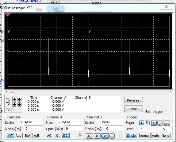

I will try with C2=100pF
But my squarewave doesnt indicate a problem with 68pF
I will input those MOSFET models. Hope they work.
Does your simulation see if the anti clipping diode work?
MOSFET models do not work.
There is not somthing called VDMOS in Multisim.
I tried with NMOS but this did not work either.
Actually the squarewave is perfect with 47pF for C2.
How come you see a problem?

My simulations (based on the .asc file added by catd) are still bad even with the values from the last post#37
I don't understand why. In the topic of the Cello amplifier, the results between LTspice and Multisim were very similar Where is the problem?
