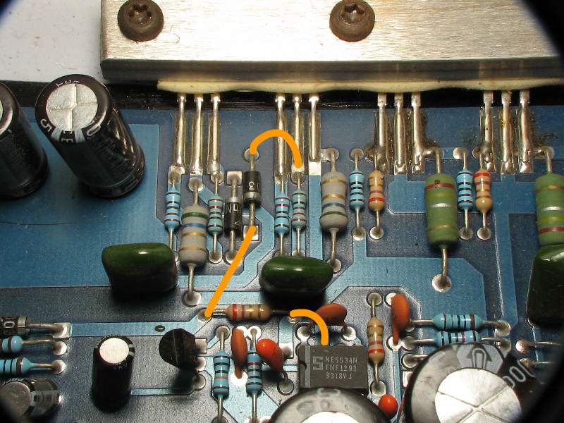

In the orange channel, you can see that the low side transistors are being biased on (barely but enough to allow them to conduct). This would cause a negative DC output. The high side outputs are probably on also (although 0.4v isn't generally enough to make BJTs conduct). If both are on, the amp would certainly draw excessive current.

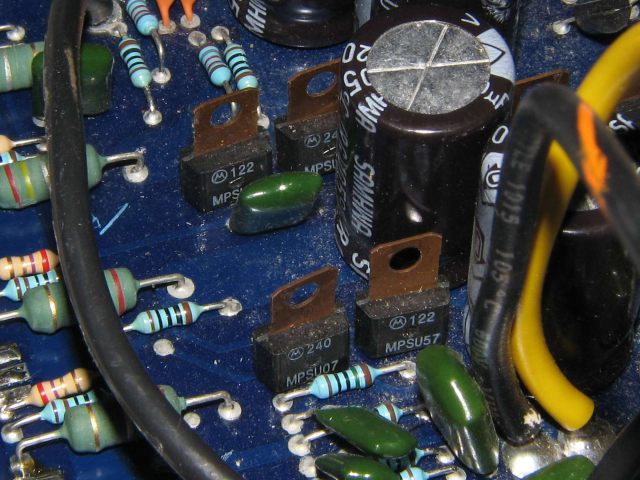

The attached photo shows the drivers from a working amplifier. The U07/57 is hidden but you can use the code at the top of the transistor to see which is the 07 and which is the 57.
Check the drivers before reusing them.
If you have MPSA06s and MPSA56s, you may want to use them to get the amp playing and then install the larger drivers after you've found all of the problems.

yeah i was supicious of it from the beginning, but i heard it play with the drivers backwards so didnt give it much consideration.
i guess now i know why it blew....oh btw after rearranging them, that high current (100 amp )draw stopped, now its only around 12 amps.
a couple sets of those 2ne's get hotter than the others....i hope the AO6/56 hold up for testing..since the 2ne's themselves are heating up.
that lone 2NE5639 was also backwards.

If the yellow channel isn't causing problems, you can leave all of the parts in it.
The drivers and predrivers are (were) the U07s and U57s.
You can identify the drivers by measuring the resistance between their collectors and the collectors of the outputs. All are directly connected.
The base of the predrivers is directly connected to the point where the 4 series diodes connect to the resistors. One predriver connects to one end of the diodes and the other predriver connects to the other end of the diodes.
Using the information above, are you sure you installed only the drivers and no predrivers?

pulled the pre drivers for orange channel and got the same number...i think i measured the wrong legs previously and got 1.92....but still the same if i measure the same legs
for the two legs (correct legs)top and bottom by the tantulums, this time im getting 2.5
no excess current draw...no dc on speaker outputs
readings for the yellow channel are the same...

The NE5534 has the positive regulated input on pin 7, not pin 8.

The reg should be easy to troubleshoot. Confirm that you have rail input on pin 3 and output on pin 2 of the LM317. See the attached photo for the circuit path to the 5534. Both 5534s are powered by the same reg.

In general, you never use you meter on diode check or ohms when voltage is present in the circuit. The voltage in the circuit will skew the results.
The resistors look OK.
The reg looks OK. The resistor between the diode and the IC is likely open.
The muting transistors don't need to be in the circuit.
Did you see this? It was posted earlier.
http://www.bmpt1.com/images/orion01.swf
The next step is to reinstall the predrivers. Be sure to get them in the correct locations (NPN and PNP in the correct locations).
Before you power it up, solder a small jumper wire across two of the biasing diodes (the 4 diodes in series). Solder a jumper across each of the two center diodes. I want to be sure that the predrivers are not biased on.
If the predrivers are out of the other channel, leave them out.
Power up the amp. Does it draw excessive current?
