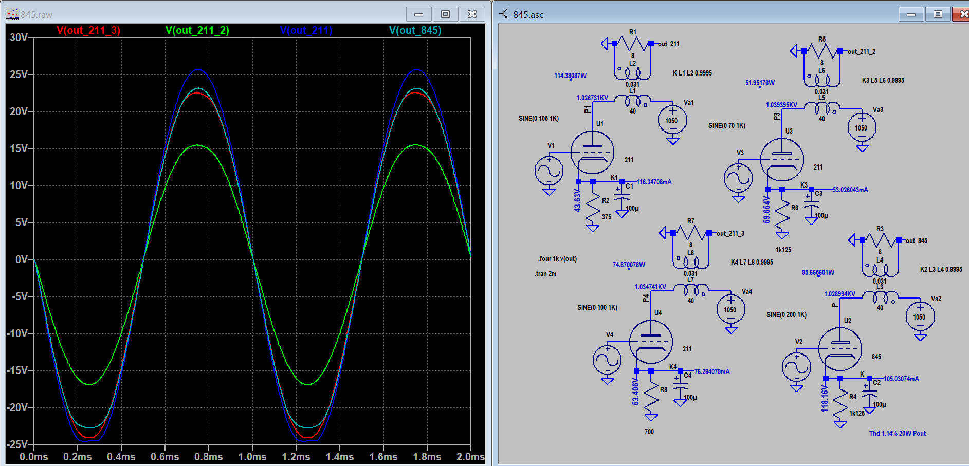

If you're close to max Pdissp(75W), power out is not much different from Pdissp 110W.
SpreadSpectrum,
I built the circuit I've got around an output transformer that was not wound for high voltage and the winder asked me not to run it in the KV range. My way of taking care of that is to run it as a grounded grid into A2.
Yeah, I was planning on using a 5k transformer at 110mA and 620V (68W). The transformers I have are built for transmitting tube voltages, but I'm trying to develop a circuit that can get really good performance with transformers that aren't exotic, like, say a standard Edcor 25W SE model.
575 Ohms in 211 cathode seems reasonable.
Tube bias -43V
Voltage across tube 917 V. 960 on plate minus cathode bias.
Current 75mA
Plate dissipation 69W. A bit below 75W max spec.
Output power is at 26W before clipping. This is close to what Koons simulation shows.
