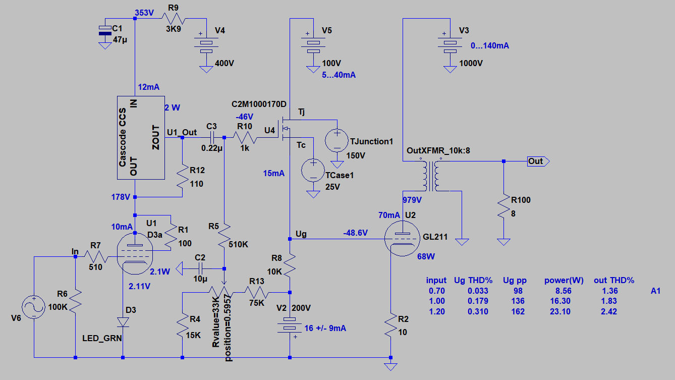

From all I've read in this thread:
- 20k opt it too high. 16k is best in achieving good power 16-18w in A1.
- 211 driver gain is not high enough to drive the 211 even with a 1:4 input and 1:1 IT
- ya I'm lost. I want a two stage DHT amp able to do 15-17watts, stay in A1. Gimme a driver tube guys!!! I thought I had found it in the 4p1l, it was close but....

You can do it. It's just that DHT's with higher gain that can work well with interstage transformers are just a few and are not cheap.
If you fancy vintage stuff and are prepared to pay big money you could look for NOS RS-241, for example. If you want to be safe, spend less money and possibly get better results then current production Emission Labs 20B.

If you fond of -medium to high gain- DH tubes, the choice is limited.Gimme a driver tube guys!!!
EML 20...30 -even mesh- is very good tubes, but expensive toys.
I usually use 841 (VT-51) as VAS DHT tube, up to 150-200Vpp.
Choke loading is feasible, but good 200-300H 10-15 mA anode choke is rare. I tried it with custom made nano core 400H choke, with limited HF transfer (about 25k -3dB).
Instead of choke I use CCS or gyrator as anode load, then impedance separator (cathode or source follower).
With active load and CF/SF the HF transfer would be satisfactory (about 35..40k -1dB, 60..70k -3dB).
10Y (and my favourite 801) is good tube, but not a gain champion.
If you use it as IT coupled single stage, the step-up (about 1:3) IT is necessary, but difficult to make (for example 10k:30k at 25mA primary current) this IT.
Best choice to use step-up input transformer and -about- 1:1 IT.
Ps. I prefer CCS loaded high gain -trioded- pentode (D3a/E280F), cap. coupling to high voltage MOSFET (SiC) source follower as VAS stage.
Hi euro21,
Could you share the schematic of d3a trioded with ccs, cap coupling to 211 ?
Voilá.Could you share the schematic of d3a trioded with ccs, cap coupling to 211 ?
