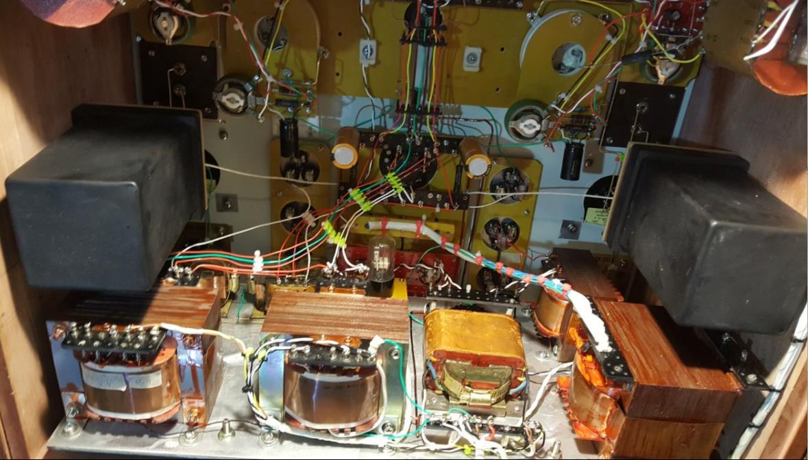

hey, I built a preamp using the 211 at 500V/30ma (with CCS and colemans) and transformer loaded: it sounded very nice.
I also built half a dozen of variations of direct coupled 801A to 211/GM70/813/EIMACs and I would not suggest to build such a beast to anybody. Tons of irons and capacitors, unimaginable heat, buckets of $ but, oh man!, that amp was fabulous.

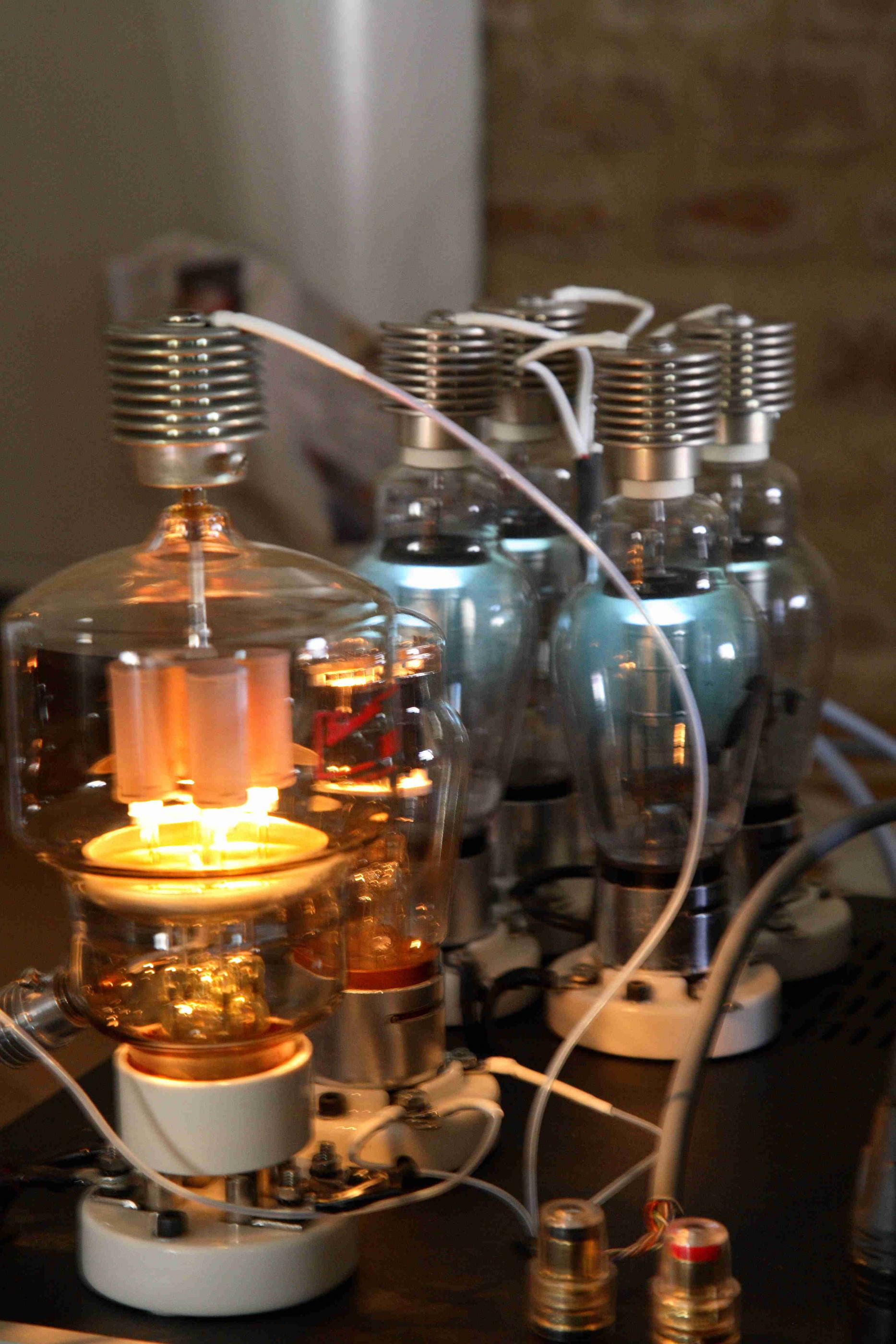

sort of! I had the 304TL version there but they were not yet directly coupled. i dismantled those amps and rebuilt them as 4 chassis and stacked the output tube on top of the driver. 1500V
Me assembling the system in Monterubbiano (and fixing a smoked choke in the PSU) and a close up of the 304TL and 801A (in the background the 866A).

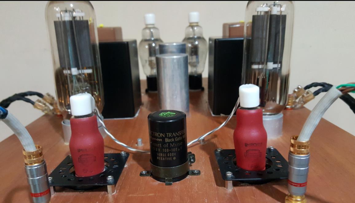

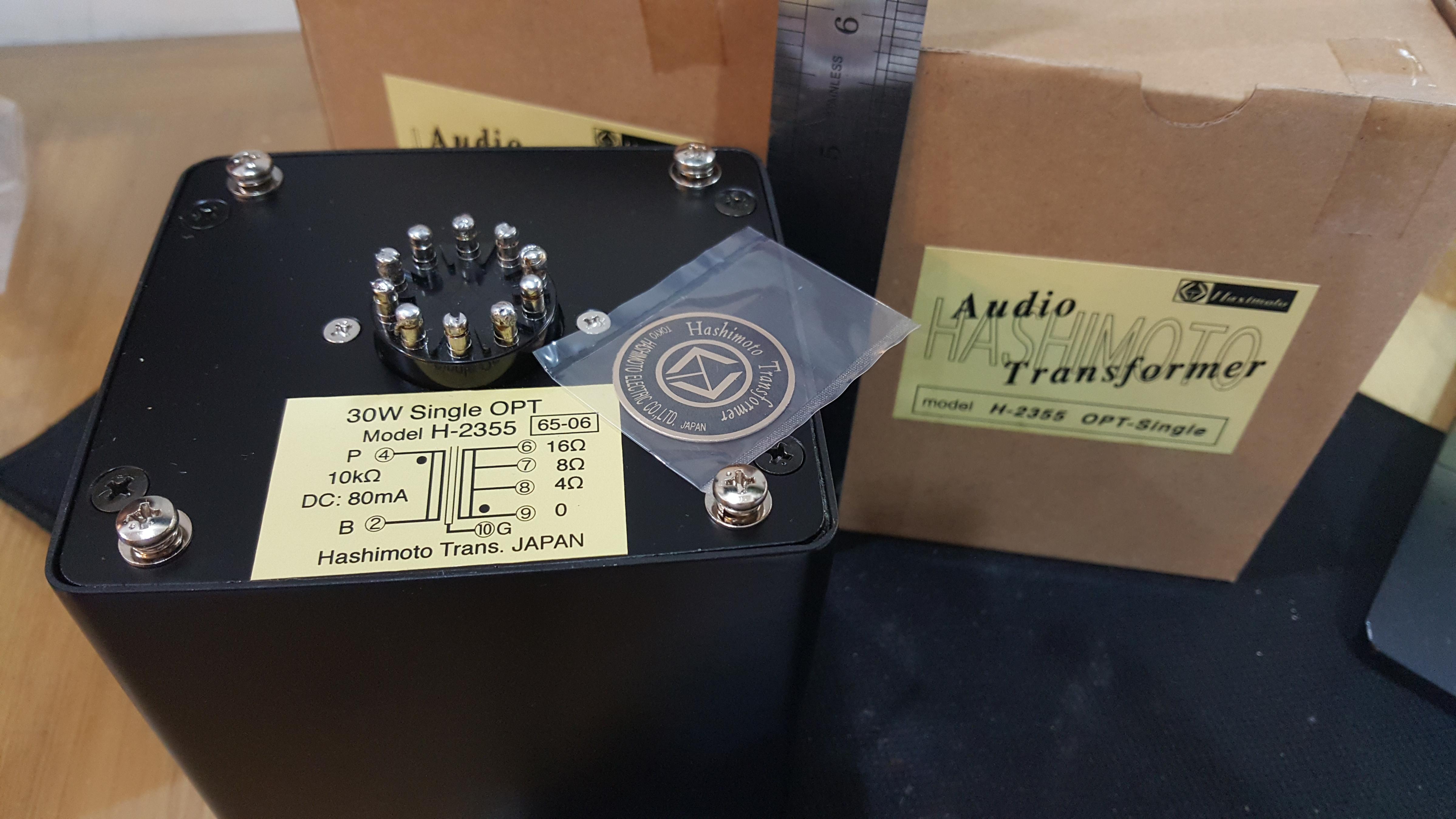

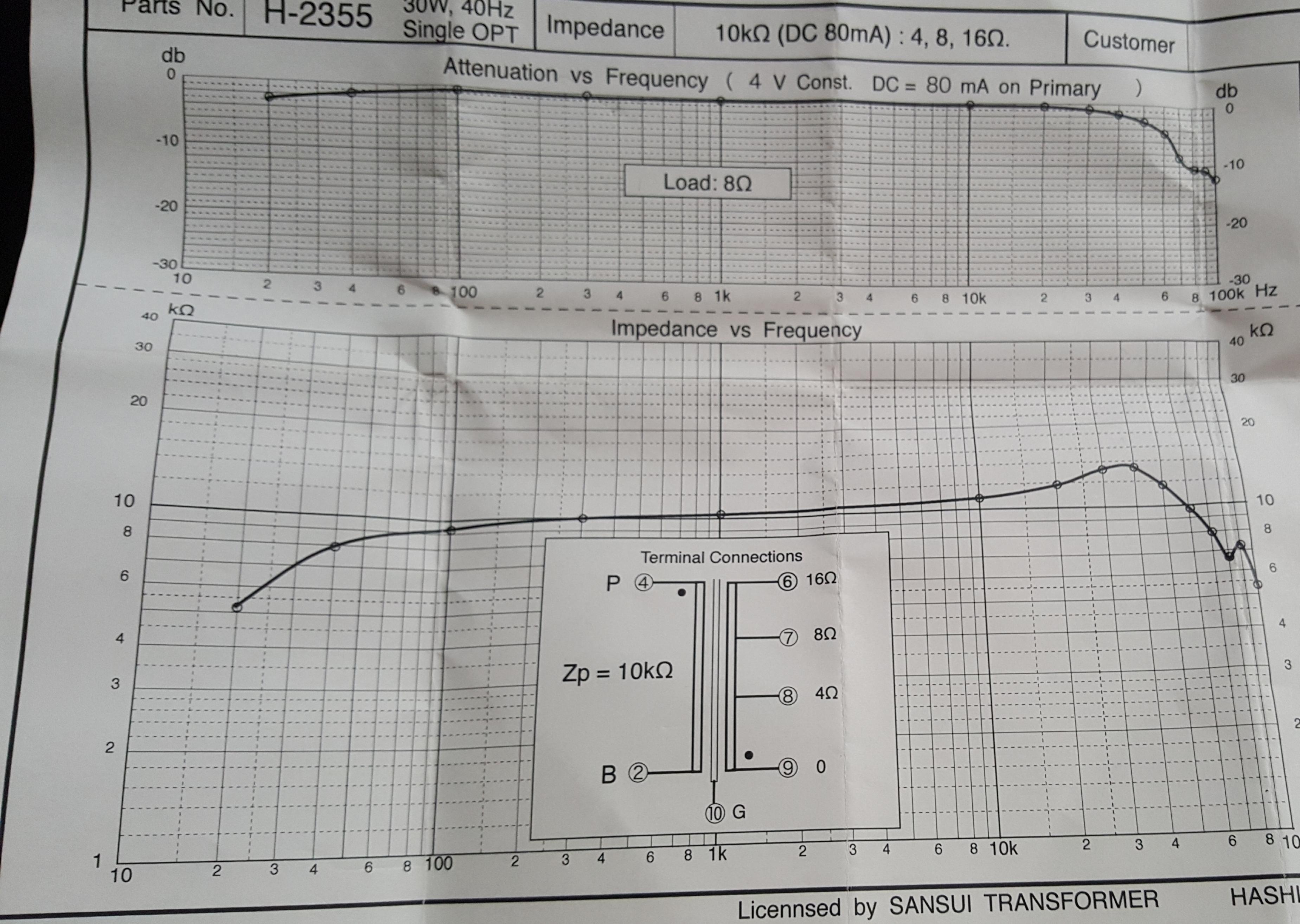

hi,
I have this Custom the SE Output Transformer ordered to Hashimoto, with specification Primary Single Tap : 10kohm /80ma / 30 watt, will give enough room for my 211. They provide the Form of test results. I feel this is fair.
inductance is important in the frequency response (low) i seen, they have left more.but in my opinion of my Custom OTP HAshimoto, that this is enough balance and flat.
I have used many transformers from Hashimoto, I think this is not bad and good with the price. when we see other made-japan transformer with rare condition.
for the stock OPT of hashimoto OT does exist as you said, maybe they consider it from the price, but it can still be overcome with matching circuits and parts.

IMHO, that Hashimoto is good for a relatively small 211 amplifier. It's 30W @40Hz which means about 17W @30Hz if the tube runs at 80 mA. I consider 30Hz a better frequency to assess transformer capability.
It looks like it has a minimum inductance of 40H (very small signal). It will be a bit higher with signal.
If you run the 211 at 1000V/60mA you should be able to get about 10W in class A1 with low distortion. For 1000V supply the data sheet suggests 7.6K to get 12W. You will get that into a 6 ohm load which is a typical minimum impedance of a true 8 ohm speaker....

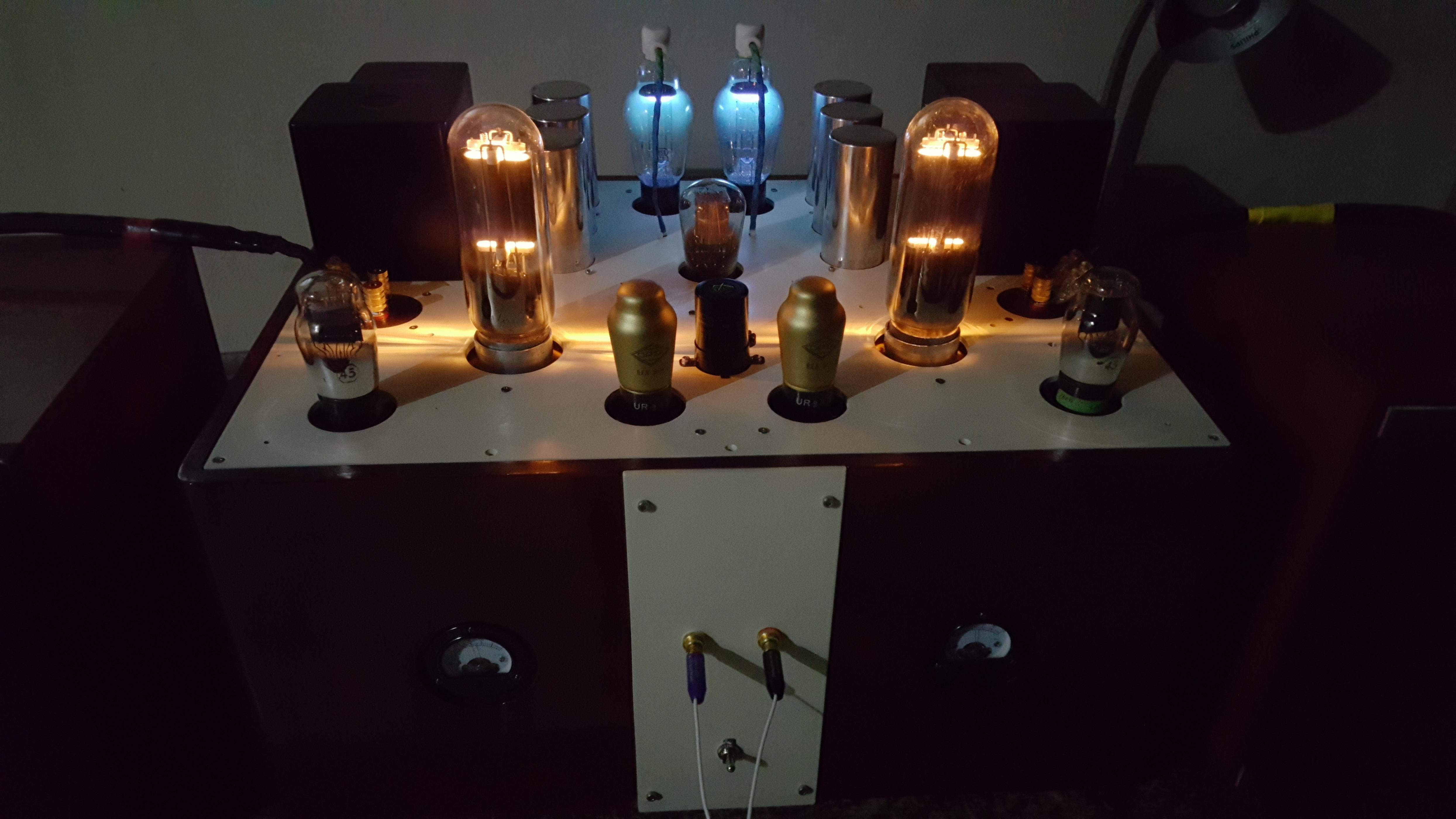

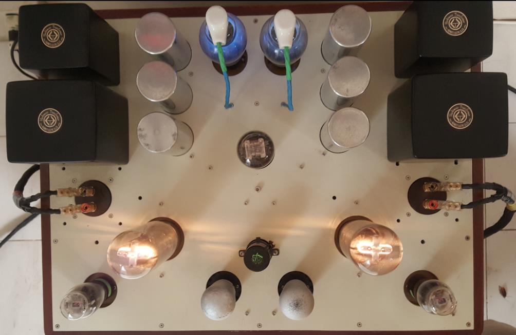

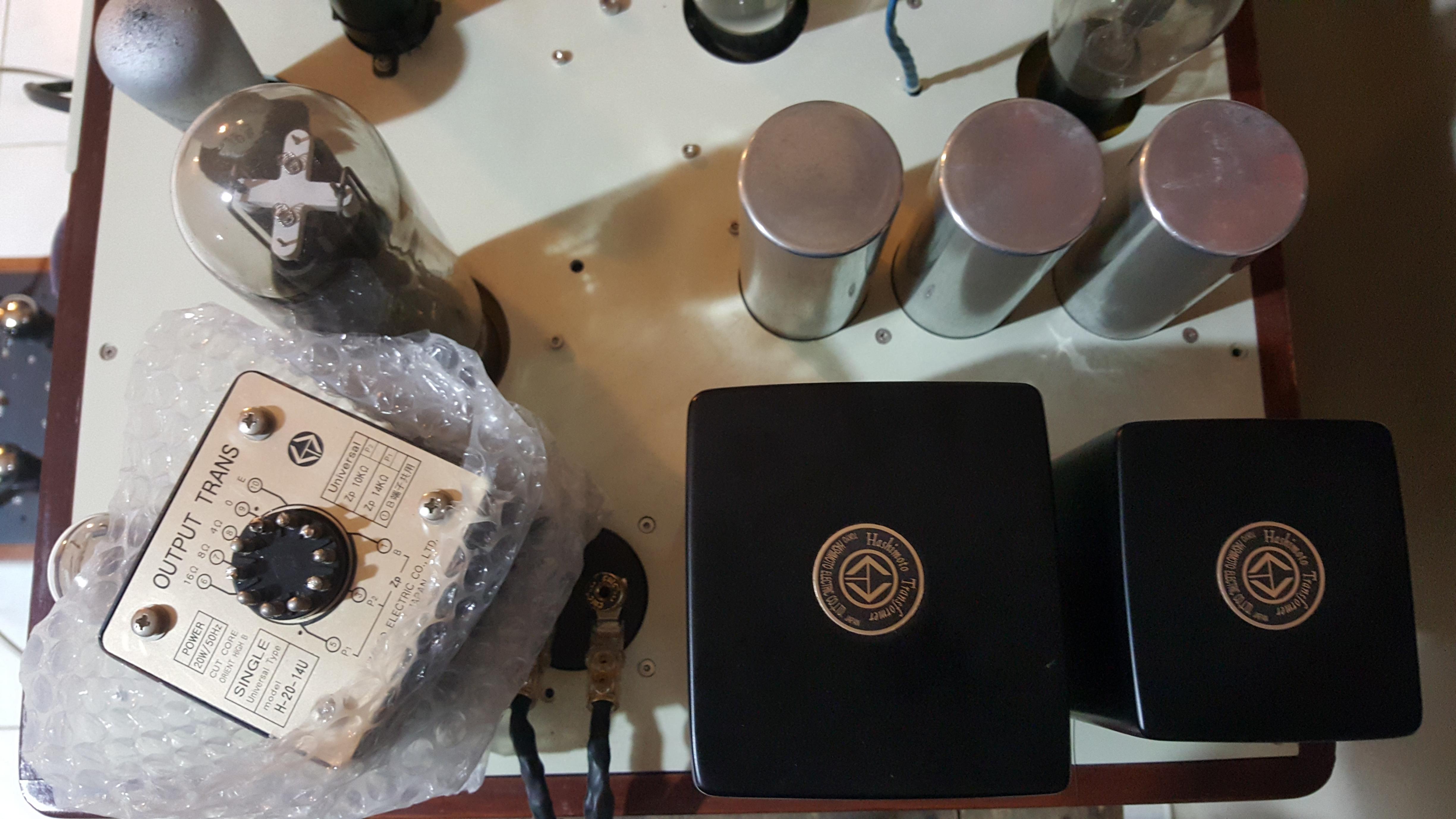

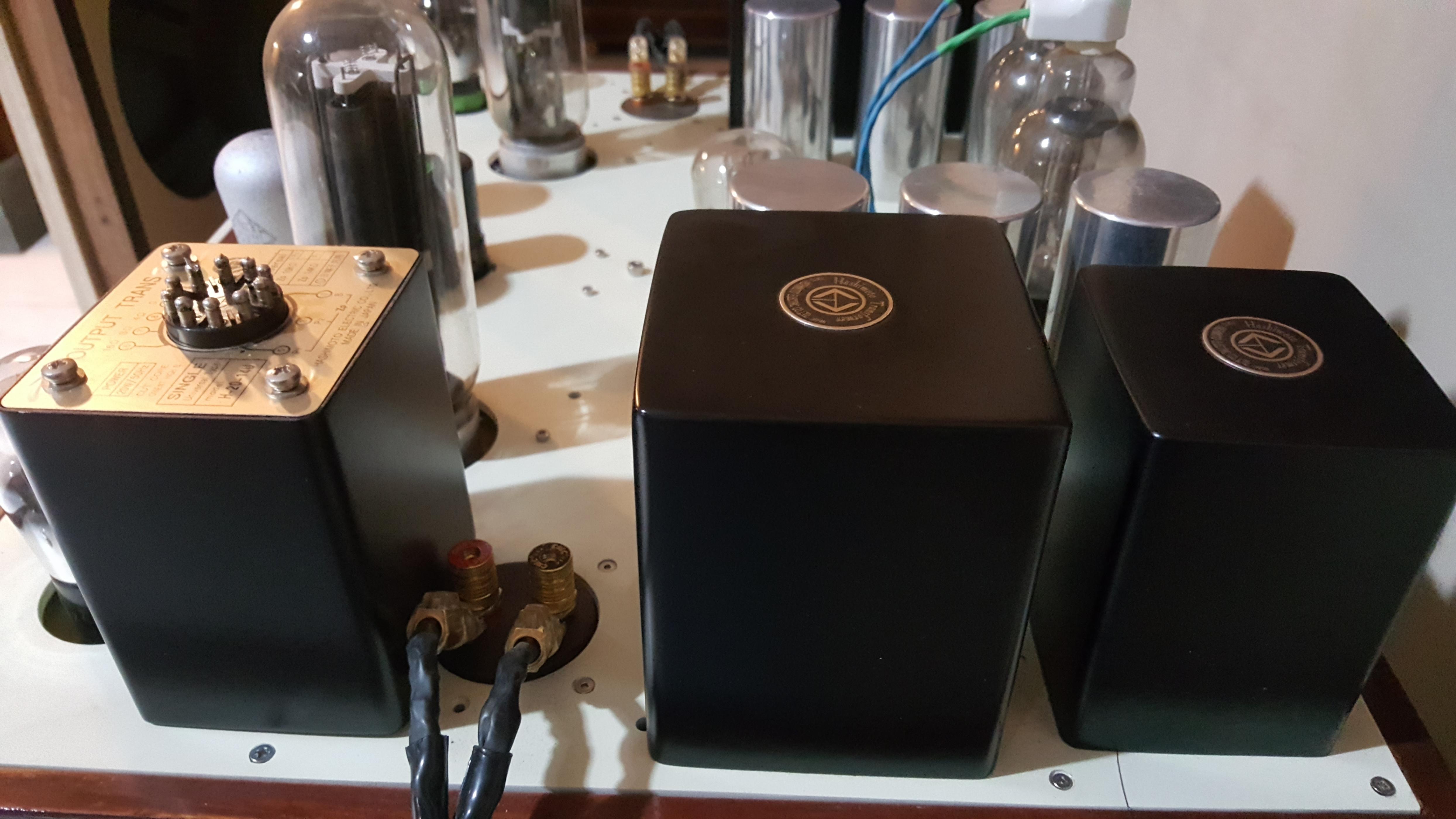

Hi 45,
Thanks for your opinion, i like
My hashimoto OPT has 57.3H, this size is quite large compared to the Hashimoto H20-14U series.
I use this for Project Single ended 211. a small output power.
I still prefer the SE than a PP or PSE, in my opinion SE gave a nice sound,
my 211 have not reached optimal, because I only get B + 850V, because MY diy PT only get 1550V-ct, for next i will try to winding again but at now delayed due to busy.
Can you give suggestion for a good driver tube of choice for 211?
i have try used a pentode (Mullard EF6) as a single stage driver, that is not bad, i like its speed of course with a boost of 211.
but i am fanatical with triode which i think is correct ....
i have changed it with 2 stage driver using REN 904 (indirect Heated Triode) as input and 45 (little Mu but i get enough current) for swing bait on grid 211. i am still try and learning , Next.. looking for A VT25 for replace 45 when i making a new PT .......
