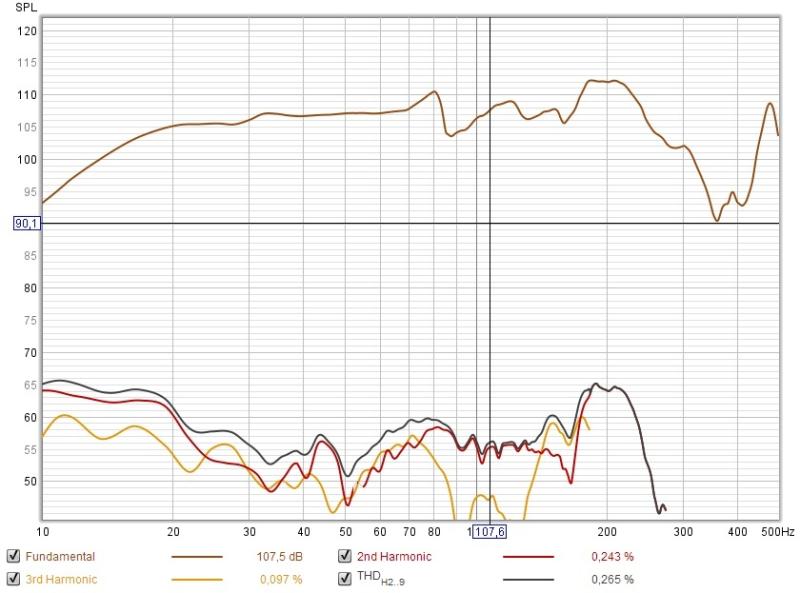

The plan of the Ripole with the dimensions in centimeters.
https://goopics.net/i/h9uucn
I first built a larger prototype. I then looked for the best curve with 1cm plates in the tunnels.

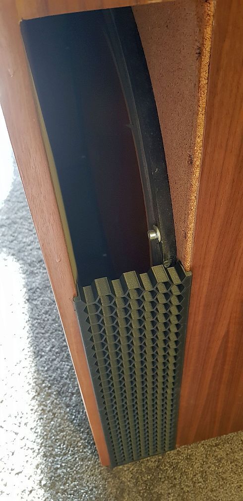

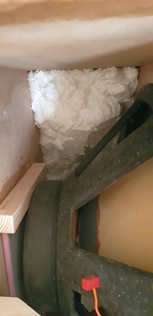

I don't get the meaning of that drawing and your explanation. What is that diagonal grid? Did you use flexible foam bords that fold around the rear 180° of the frame so that the back of the cavity is a semi-circle sitting right at the edge of the driver? Or is this absorptive foam?
Reactions: NBPK402

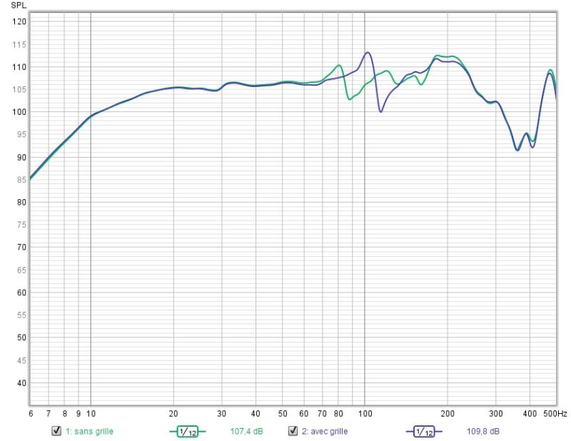

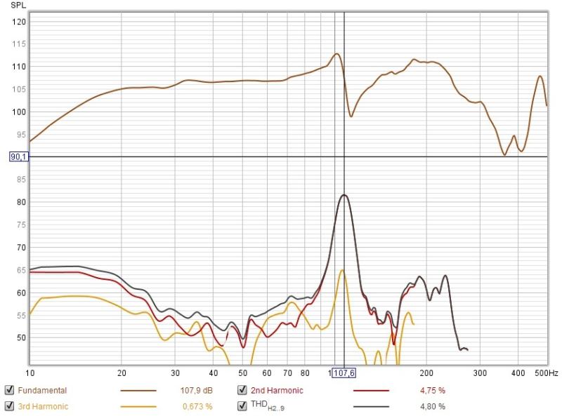

It is a 3D-printed grid, to stiffen the output. It also has a role to equalize the pressure and slow down the exit of the air.
The foam is rigid. It is injected and cut with a cutter. Unnecessary cavities are removed, and subwoofer rigidity is increased.
Reactions: NBPK402
Thanks for the clarification. You don't do thing half way, do you? 🙂
Seriously, the foam in the back will change the cavity resonance, even if it is 100% reflective in the bass region (which I doubt). It won't do much do increase rigidity because the walls do not have much leverage so close to the back wall.
The grilles are visually nice. I doubt they change the air flow a lot. I'd be concerned about potential rattle if these things are not glued to the wood frame.
