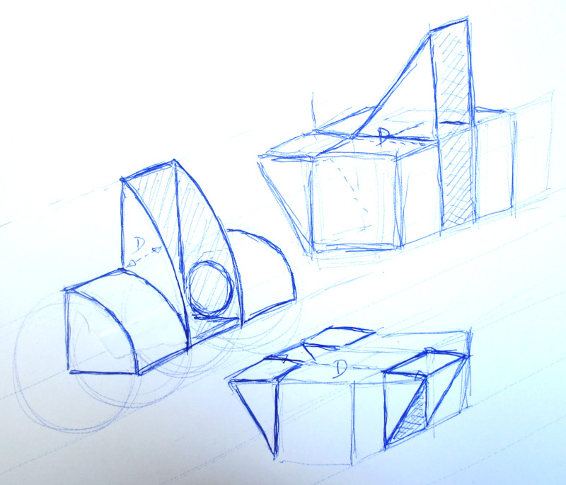

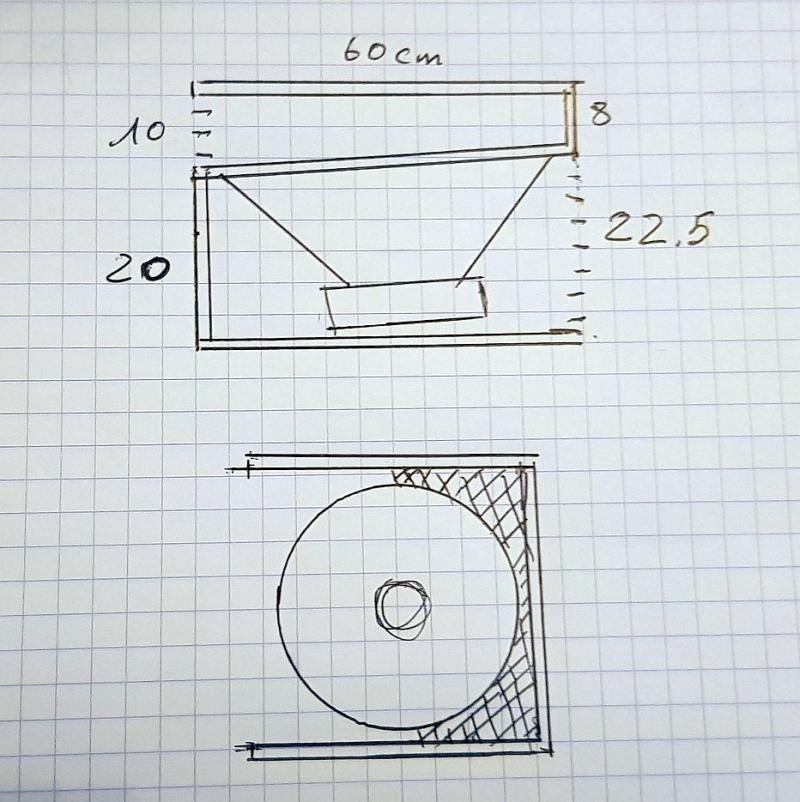

The plan of the Ripole with the dimensions in centimeters.
https://goopics.net/i/h9uucn

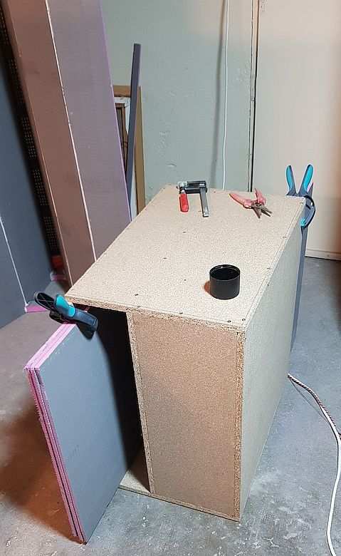

I first built a larger prototype. I then looked for the best curve with 1cm plates in the tunnels.
I don't get the meaning of that drawing and your explanation. What is that diagonal grid? Did you use flexible foam bords that fold around the rear 180° of the frame so that the back of the cavity is a semi-circle sitting right at the edge of the driver? Or is this absorptive foam?
Thanks for the clarification. You don't do thing half way, do you? 🙂
Seriously, the foam in the back will change the cavity resonance, even if it is 100% reflective in the bass region (which I doubt). It won't do much do increase rigidity because the walls do not have much leverage so close to the back wall.
The grilles are visually nice. I doubt they change the air flow a lot. I'd be concerned about potential rattle if these things are not glued to the wood frame.

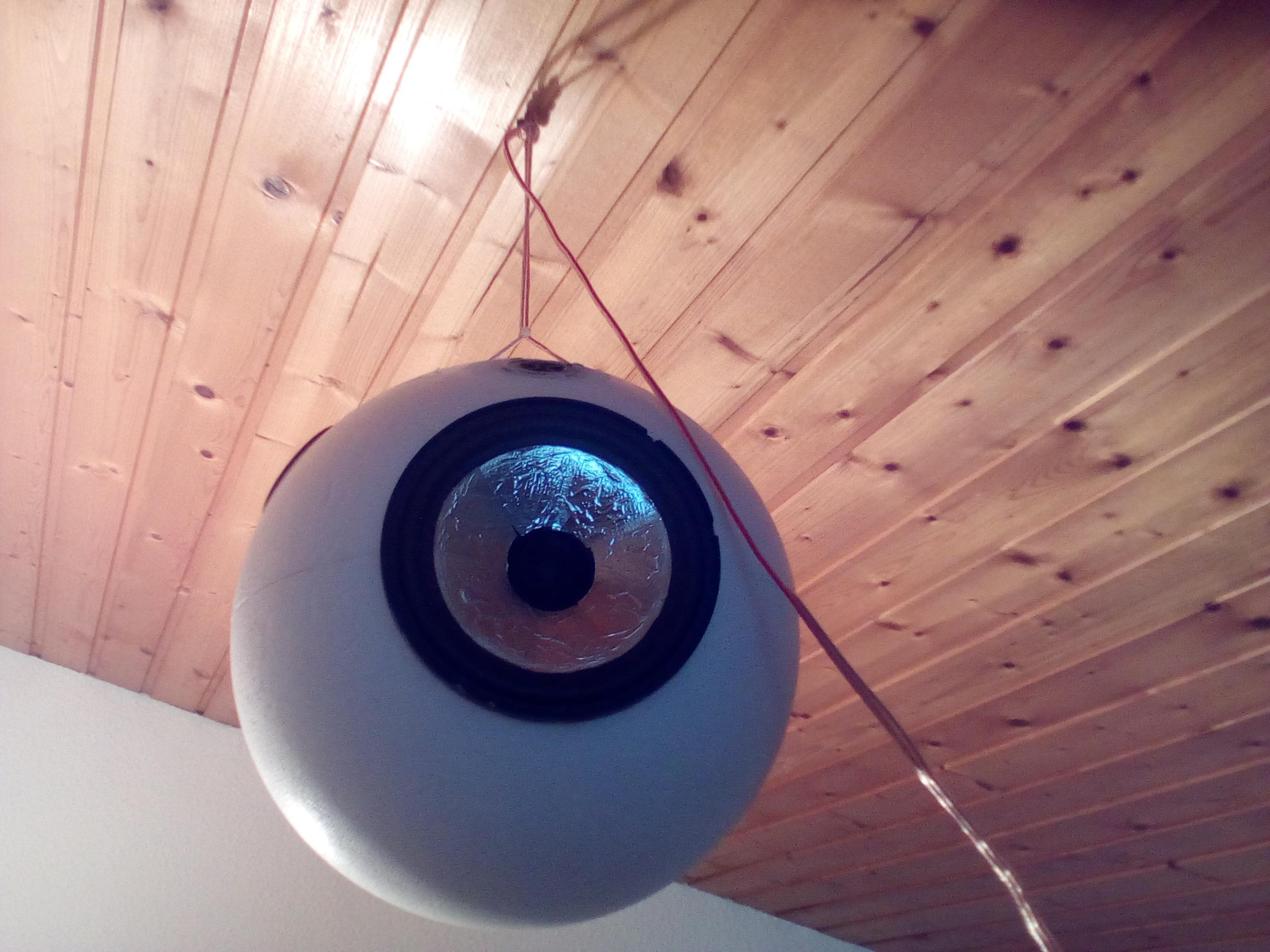

In my projects I use wired to hang drivers without baffles and the wires do an excellent job of decoupling the drivers from each other.

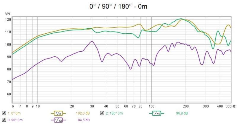

The grilles change the air flow. But this is not a good idea.

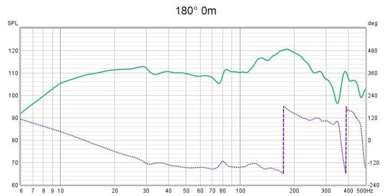

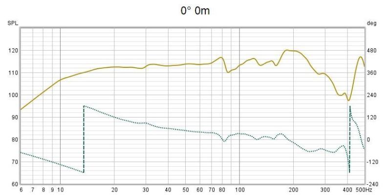

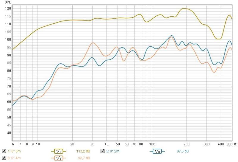

Comparison with and without grids.
Green without grids and blue with grids
Distortion without grids.
Distortion with grids.
