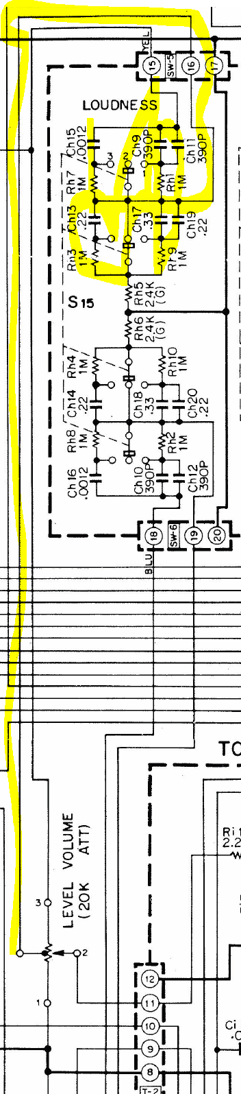

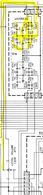

I'm still a bit confused. It sounds like this refers to the parts highlighted in this picture? All of them? I could place the loudness tap so the either the resistance between the input and the tap was the same as original, or so the tap to ground resistance is the same.The parts that are directly connected to the loudness tap, see post #7.
I would have expected C5 and R15 in the second picture in the above post to need tweaking? They go to the input of the pot, so the resistance between pin 4 and ground on that board is the resistance of the pot.

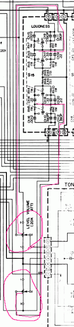

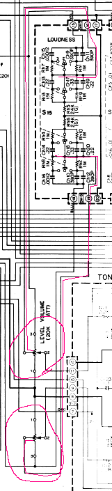

I had a h*** of a time even finding the Volume pot. Remember when that was an important part? And then it goes on a 50-mile hike both sides of the mountain (and over the multi-bus) to get to the R and C parts. I figured since I had it on my clipboard I may as well dump-back in case it helped others.
