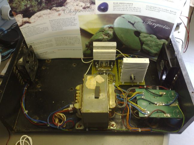

Decided to abuse the nmos200
decided to give 2 of my nmos200
to a dj friend who is very abusive towards Amps
He Drives them Hard and clips them to death
without abit of compation.
most Amps never make it for more than 6 months
He used my stereo Nmos200 for driving 4X 8ohm 100w 12inch speakers for 7Hours Straight
And Guess What?
Even with the little Heatsinks I had on it (fan Cooled)
built with non exotic parts
50V rails (well 48.6 to be exact)
The Nmos200 made it back alive🙂

Hello DJMARVELLOUS, i have worked on hybrid amps and in mho
are the worst workmanship i have ever seen and i have worked
on hundreds of amps not even stuff forom the far east has that bad workmanship, i have built i lot of amps and would never offer anything like that to a client. The mpsa 42/92 should be replaced by mje340/350. If i where you i would completely strip that amp
the only thing that is of any quality is the box and maybe the
transformer the heatsinnks are far too thin.

Ouch!
I Agree Bruce@bluff
All my dj friends have had many problems with these amps
I have stripped mine & am busy building & testing ncahnel mosfet amps to choose one to replace it with.
dont understand how one would expect to archive driving
4pairs of mosfets from a mpsa 42/92 to92 bipolar?
will try replacing my friends one with mje350 and see if it survives
thanks much apreciated...

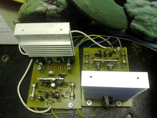

djmarvellous said:I agree 😀 but then again they work flawless![]()
djmarvellous, if the PCBs in the latter pics are yours that you made in your kitchen sink, then I hastily and humbly have to remove my foot from my mouth! Re-reading the thread, this may indeed be the case.
Sorry, bru. I didn't mean to discourage... 😱 😱
no prob man😉
I made the pcb with the tonner transfere method
& drilled them my self
not the best looking but hey they work
