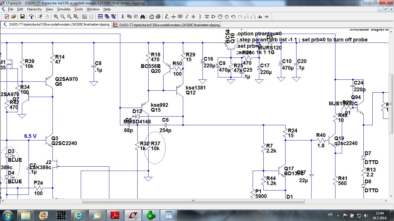

I like your work and your ideas, but technically I can't agree with you on that, it is the worst place to control the clipping (VAS). Reversed biased diode acts as a varicap diode with very non linear capacitance change. If you do all to get low distortion then adding that diode increases distortion not just few ppm, but a lot. In my simulation I used MMSD4148 diode with very low Cjo = 0.64pF (sorry I don't have BAV21 model) and THD20k increased from 1.57 ppm to 9.74 ppm at output level close to clipping.
This is 6.2 times or 15.8 dB. Of course if an amp is with higher distortion then the diode distortion could be masked.
By the way, adding a zener as suggested did improved distortion and clipping behavior, but just a little, so one can decide to use it or not, the protection resistor is a major player here.
cheers Damir

You are right - I always have said "one can decide". The zener variant is a very good compromise as you can now use low Vce devices to get better distortion and clipping behavior.
Even in my simulations it worsens the distortions from 4ppm (20k@200W@8R) to 15ppm near full power. At 20k@50W@8R the simulated distortions are 4.6ppm versus 5.7ppm with diode. During real life measurements I have tested with and without diode - the distortion level was always the same - maybe due to limits of my measurement devices or due to bad diode simulation models.

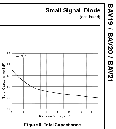

Attached a screenshot of BAV21 capacity versus reverse voltage.
1.15pF (0V) to 0.9pF (14V)
As we can see the worst (and nonlinearest) change rate of capacitance are the first 4 V - these affect the distortions mostly the last 4V be4 clipping of the positive halfwave. During small signal listening the diode is reversed biased about 1/2 of total supply voltage with negligible capacitance changes.

I simulated with BAV21 and got almost the same result, a bit lower, 9.18 ppm, thanks for the model.
I think If you really need to better clipping behavior the is better to use Backer clamp.

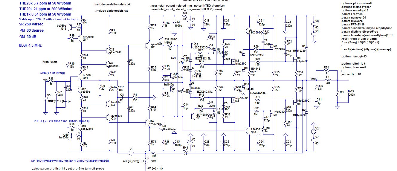

dadod
Try to solve clipping behavior just in differential input stage, with antiparalell 1N4148 diodes between colectors of curent mirror transistors (some resistor for voltage shift in series with colector Q6 will be needed, without input signal should be across diodes zero voltage).
Or simply connect 3 diodes (1N4148) in series to Q15 base (first cathode) and +Ub of VAS -upper side R18 (last anode), remove Q20 and slightly increase R29 .
dadod
Thank you BV for your suggestion. I tried both and here is the result.
Antiparallel diodes between CM transistor collector did not improve clipping.
Diodes string between EF VAS transistor base and +Ub did help with the clipping behavior if EF protection resistor was set to low value (1k), and did not improve it when that resistor was high enough (10k to 15k) but doubled distortion.
Damir

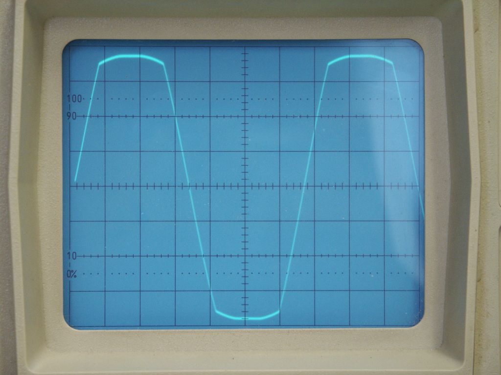

Baker clamp hasn't helped to cure the 20k clipping as we have a amplifier with NFB. IMHO if you add the baker clamp the VAS still gets into saturation as the NFB wants to correct the heavy distorted output signal. Diode clamp between input LTP hasn't helped either - only increased distortion....

hasn't helped is different from hasn't "cured"
what is your criteria for "good" clipping behavior - amplifier survival is one - but any psychoacoustic evidence for what can heard vs what you see on a scope?
Maybe you get here better results with your CFA using a baker clamp.
BR, Toni
I don't get why Baker clamp can't cure the 20k clipping, but if you want to prevent an amp to go in to clipping at all, you have to prevent the input signal to rich that level and use something as Cordell's Clever Klipper, or NAD soft clipping with a diodes.
I don't need Baker clamp with my CFA, look some post back where I started this issue.

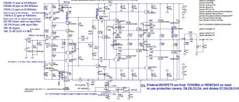

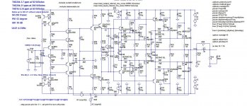

Can you post asc file for schematic you are trying to improve clipping behavior? It is much more simple to do something, like talk about it.
2 dadod
Hi BV,
here it is, you can play with it.
Damir

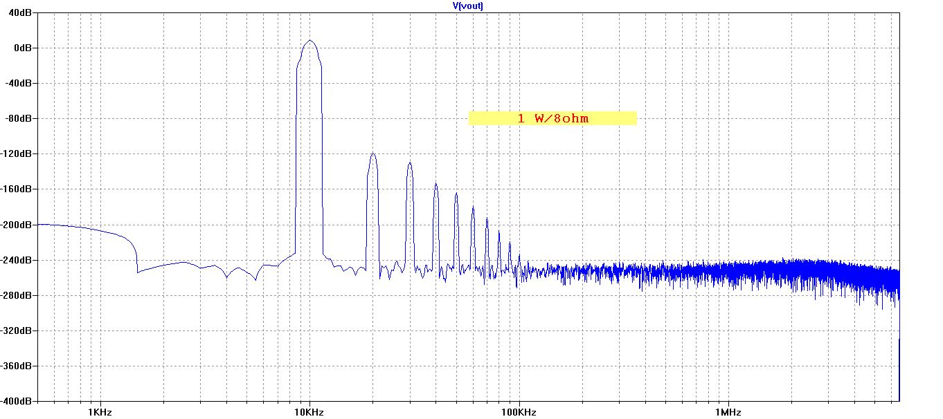

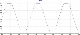

I did some more simulation and came to this a bit simpler schematic. No need for individual OPS mosfet compensation, distortion is still very low, clipping is good, SR is 700 V/usec with no input filter and 200 V/usec with input filter.
Damir
Damir
GainWire-TIS-simple-TPC-OIC-LMOSnocomp-200W-2-DCservo-15V-betterCCS.jpg169.5 KB · Views: 459
GainWire-TIS-simple-TPC-OIC-LMOSnocomp-200W-2-DCservo-15V-betterCCS-FFT1k-1W_8.jpg130.9 KB · Views: 430
GainWire-TIS-simple-TPC-OIC-LMOSnocomp-200W-2-DCservo-15V-betterCCS-clipping.jpg100.4 KB · Views: 406
