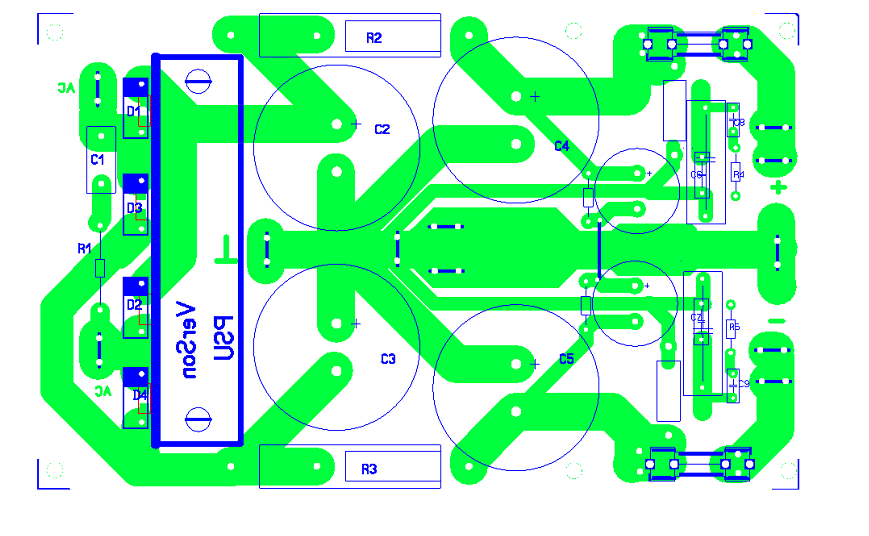

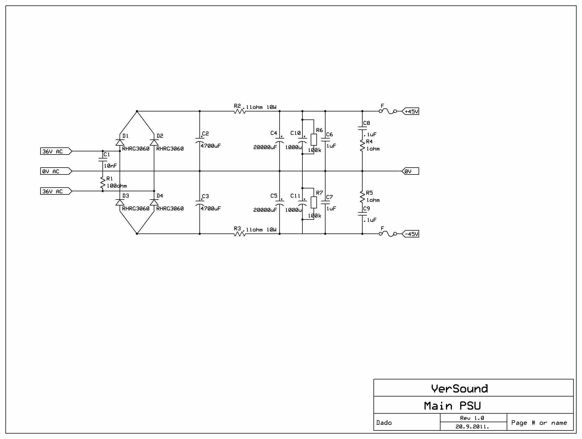

You will need a transformer of 600 VA or more and secondary winding with 2x48 V(up to 2x50 V).
I would suggest the schematic and layout.
Dadod,
Are C6, C7 and snubbers strictly necessary?
Wouldn't the gain of the films be lost by the time you take into account the leads to the amp PCBs?
Paul
They are not snubbers, and not strictly necessary. C1, R1 is a snubber.
corrected:
Sorry, I mean those snubbers are not strictly necessary, this is something that could be argued infinitely.
Cordell uses film capacitors parallel to the big elcos in his book, figure 16.8.
No,
the resistor in series with C1, C8 and C9 are the snubbers.
They are there to damp oscillation.
R4 and R5 are only needed because the local decoupling has been moved from the amplifier to the PSU. C6, 7, 10 & 11 are likely to increase the risk of oscillation/ringing.
No,
Andrew it looks as you did not catch meaning of C10 and C11. They are cross connected between +- polarities to improve +- tracking. The C10 and C11 are in series (it is not easy to find 500u cap with 200 V rating) and parallel resistors are here to devide the voltage. The midle point is not connected to the ground.
