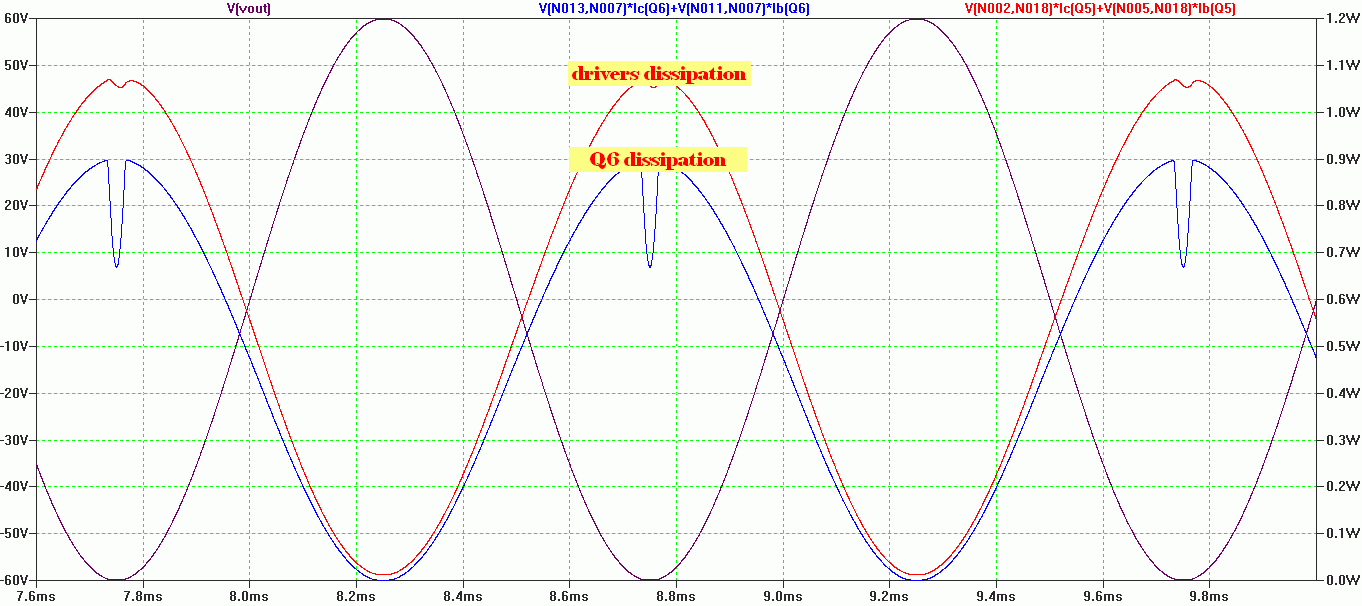

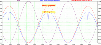

Attached is max dissipations(on the verge of clipping) of the drivers and the Q6 and Q8. What is small heath sink thermal resistance?

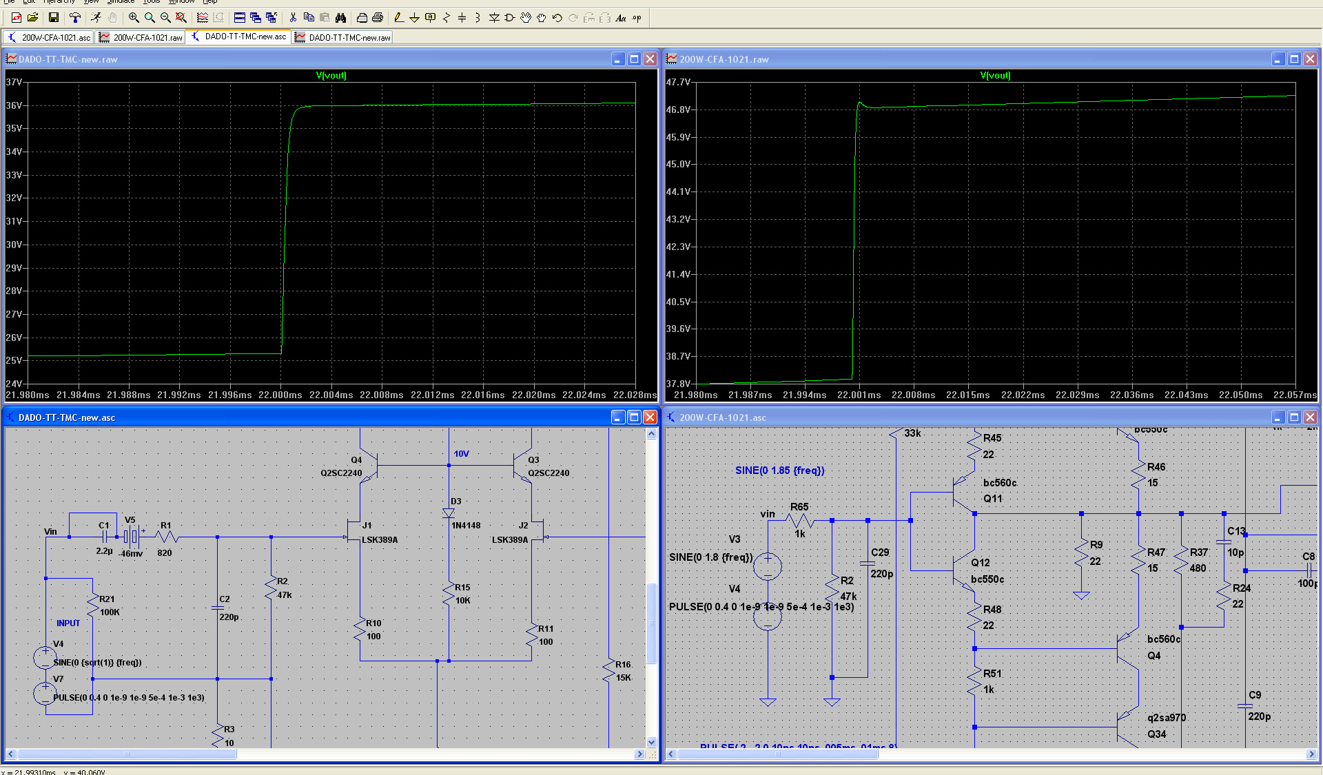

Overshoot?
I did a transient simulation with 0.4Vp-p 1KHz square wave imposed over a 100Hz 1.85Vo-p Sine, and there was overshoot at the transitions at the output. The picture attached shows the positive going transition only but the behavior at the negative going transition was identical. It appears the amp has a hard time responding even not so quick an edge -- the LPF was in place at the input, although no ringing was found. Out of curiosity I gave the similar dose of signal to Dadod's TT-TMC amp and it appears to behave much better, no signs of either overshoot or ringing. Does this indicate any problems with the CFA design, at least with my local copy of the schematic? Should I be woried about such behavior? Dadod, can you kindly do the same simulation with your schematic when you have a chance and see if it duplicates? Thanks!
