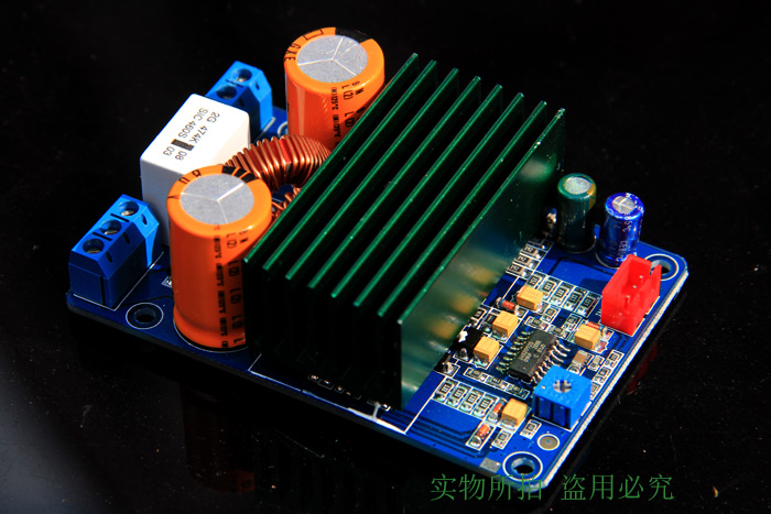

Yes the chinese tristar vent Nichicons on your ampboards are the real thing, all japanese cross vent Nichicons are fake, and your testboard is absolutely safe.
Thanks for confirming that these are real Nichicons.
As irribeo has rather dryly pointed out, your caps don't look the same as mine.

So yours came with real Nichicons and mine with fake? Is it certain that 3-star vent is fake? Why would they bother to put real Nichicons on some and not others? If you are going to make fakes why not go all out and save as much as possible?
Searching for IRS2092 on Taobao reveals that there's more than one vendor with what looks to be the same PCB, but different BOM. For example there's this one where they're using a toroidal output choke - can't see any difference in the PCB but of course I've not done a thorough examination. Is it possible some eBay vendors cut costs to make the international prices as low as ones within China? This one also has the 3-score topvents like yours.

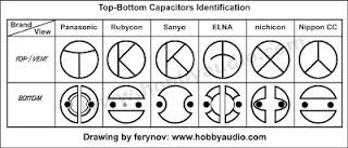

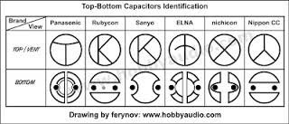

View attachment 489791 Hope this helps
Original source:
http://hobbyaudios.blogspot.de/2011/04/identify-good-original-capacitors.html
But this is not fail-proof, as manufacturers use more than just this shapes to make their caps.
I.e., see this Panasonic datasheet. The bottom cap is done differently for caps <=8mm and >8<=10.

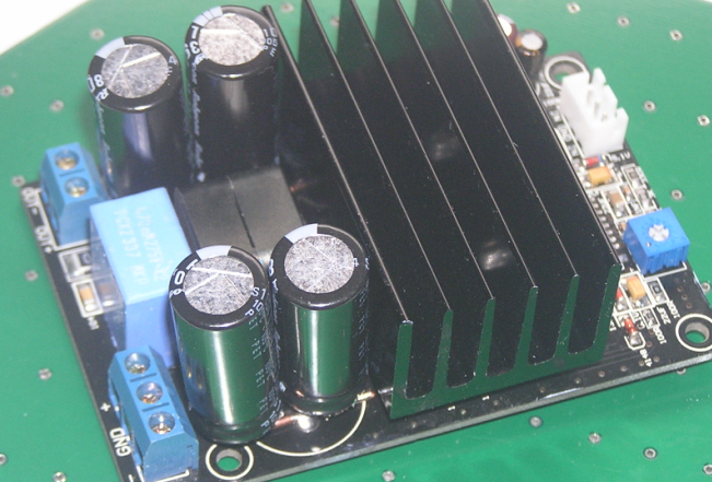

Assuming you're buying from Digikey, I'd say these are your best bet as replacements for the originals.
EKYB800ELL471MK30S United Chemi-Con | 565-3994-ND | DigiKey
Seeing as they're 12.5mm diam you can (just) fit two in place of the wider originals if you solder some thick copper wire onto the pads to act as 'busbars'. Here's mine with 12.5mm*30mm Rubycon ZLHs.
when the esr goes into the 10's mohms the trace layout becomes the limiting factor, adding "bus bars" on top usually makes the routing worse. Ived used 4 leaded caps in these kind of apps. study the PCB routing its probably not that good
Thanks for the Digikey tip...
I am going to leave my stock caps in place for now. They sound decent enough thus far. Hope they don't explode...
Just keep an eye on that '3 prong' vent if you're running anywhere near the rated voltage of the caps (which you probably won't since 100V rails will fry the output MOSFET first). Probably staying well away from 100V you'll be fine. All the 'fakes' I've had worked OK well below their marked voltage.
